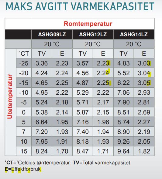

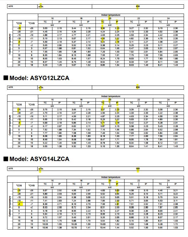

Myös Fujitsun LZCA (=General) puhkuu näemmä "pyhällä hengellä" ,vaikka kylmäke tuo R410 !
Daikinin tupla-swingin ohivuoto-ongelmat R32:lla ilmeisesti ratkaistu :
http://www.davidpublisher.org/Public/uploads/Contribute/550f896d2a88a.pdf

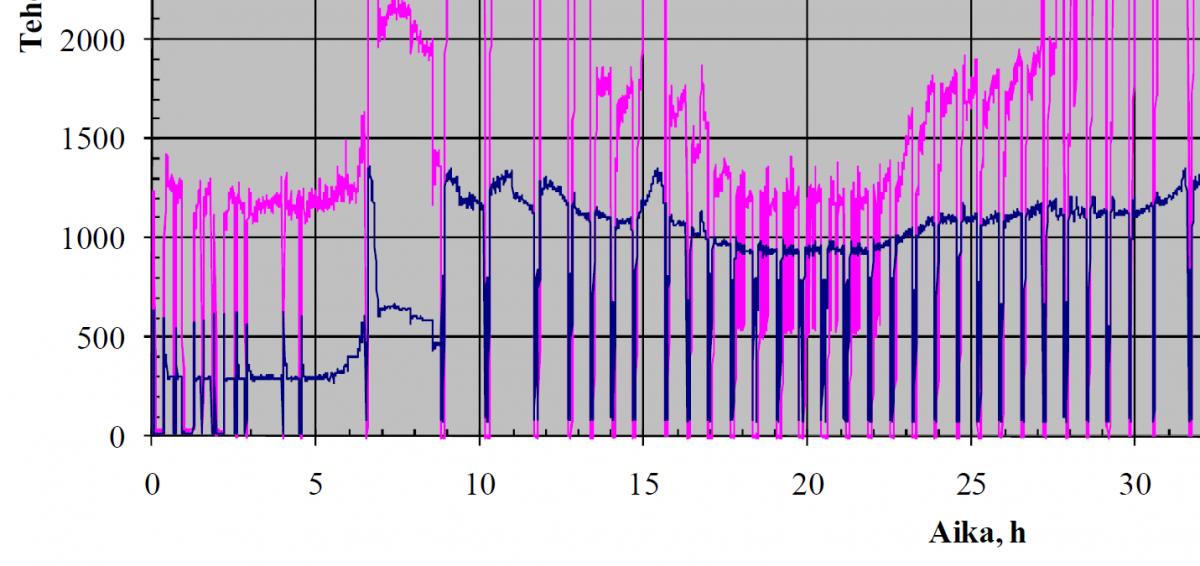

Kommenttini perustuu VTT-testien mittaustuloksiin = joka on lähempänä todellisuutta. ;)
Ohessa kuva Fujitsu Nocria AWYZ14, eipä siinäkään tuo sininen ottoteho viiva pysy samana kun pakkanen laskee -15C => -30C http://www.ilmalampopumput.fi/files/vtt-testi-fujitsu-nocria-14.pdf
Sama tilanne ASYB9LD:llä huippuottoteho laskee 1200 W (-15C) => 950 W (-30C) http://www.scanoffice.fi/sites/default/files/liitetiedostot/vtt-s-08098-10.pdf

Hi R290.
Nocria is one of my personal favourites and I installed several 100 units of this monster. ;D
Hovever the LZ data you published I do not trust them 100%. If you look inte the 9 and 12 size units, they have the same consumption from -5°C and colder but the power output is higher on the 12 size. Same indoor unit, same airflow, same outdoor unit (compressor) but higher output ? In my opinion a difficult equation.
Regarding the R32 and compressor hurdles, Daikin has many patents here and we are very confident in our technology.

Hi D
You are entirely right about the dilemma rgd. the basic data upon 09/12-LZmodels.
But this is "only" a "marketing jippo" to justify the higher pricing for 12-size even though the same pump concerned as 09 -model.
The basic issue here was ,however, the indicated and flattened input energy of the modern split ACs at the cold ambient corner .
No more any drastic drop in input energy @ extreme coldness ( if the issued marketing/declared data even somewhat trustworthy) !
One may ask ,why earlier the "drop" was a rule?
Control issue related to keep discharge gas temperature in limits?
  • Fujitsu xx LZCA_R410a_Nordic 2016_Declared Heating Capasity vs Input Energy @ xxx Airflow.JPG
    144,9 KB · Lukukerrat: 458

The previous drop of consumption when temperature falls was mainly due to compressor protection as to keep the pressure ratio within safety margins. Today the fight between the producers is more active following market demand in terms of capacity when cold temperature occurs. One just have to hope that the units can whitstand the increased conditions that happens when cold ambient. And as I mentioned before, Daikin has a lot of patents regarding compressor design in respect of R32. 92 of those patents we have released for free to everybody that wants to use the designs but the most important patents are still exclusive for us. Critical in R32 is the absence of R125 that had a positive function in respect to heat transfer from the compressor chamber(s).

"Drop is a rule" if you look at these documents. Look at numbers in operating limit temperature -25C, when heat pump compressor was (supposed to be) running full speed. Those advertaising documets are other question. 8)
http://www.fujitsu-general.com/global/data/support/erp/00371726-01.pdf
http://www.fujitsu-general.com/global/data/support/erp/00371727-01.pdf
