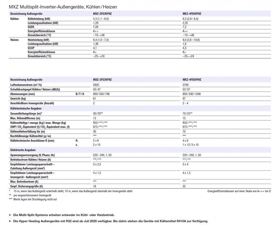

MITSUBISHI ELECTRIC MULTI-mallit
Multisplit -mallit MXZ-ulkoyksiköt

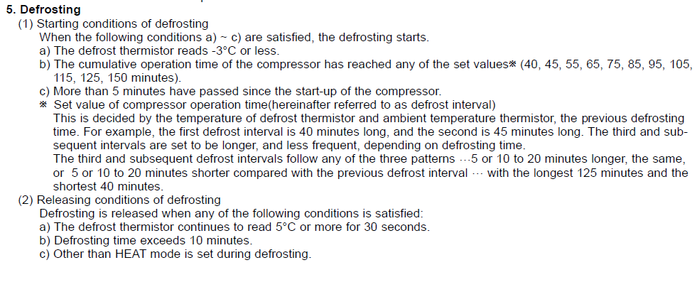

Tässä tuo FA25 mallin sulatusosa tuolta Service Technical Guidesta
http://www.bdt.co.nz/comfortmaster/data/manuals/r410a/STG_MSZ-FA-GA-GB_MFZ-KA_MXZ-A_MSC-GA_MSH-GA_OBT14C.pdf
5. Defrosting
(1) Starting conditions of defrosting
When the following conditions a) ~ c) are satisfied, the defrosting starts.
a) The defrost thermistor reads -3°C or less.
b) The cumulative operation time of the compressor has reached any of the set valuesw (30, 35, 40, 45, 55, 65, 75, 85, 95, 105, 115, 125, 150 minutes).
c) More than 5 minutes have passed since the start-up of the compressor.
w Set value of compressor operation time(hereinafter referred to as defrost interval)
This is decided by the temperature of defrost thermistor and ambient temperature thermistor, the previous defrosting time. For example, the first defrost interval is 40 minutes long, and the second is 45 minutes long. The third and subsequent intervals are set to be longer, and less frequent, depending on defrosting time.
The third and subsequent defrost intervals follow any of the three patterns …5 or 10 to 20 minutes longer, the same, or 5 or 10 to 20 minutes shorter compared with the previous defrost interval … with the longest 150 minutes and the shortest 30 minutes.
(2) Releasing conditions of defrosting
Defrosting is released when any of the following conditions is satisfied:
a) The defrost thermistor continues to read 5°C or more (MUZ-FA25VA) / 10°C or more (MUZ-FA35VA) for 30 seconds.
b) Defrosting time has exceeded 10 minutes.
c) Any other mode than HEAT mode is set during defrosting.

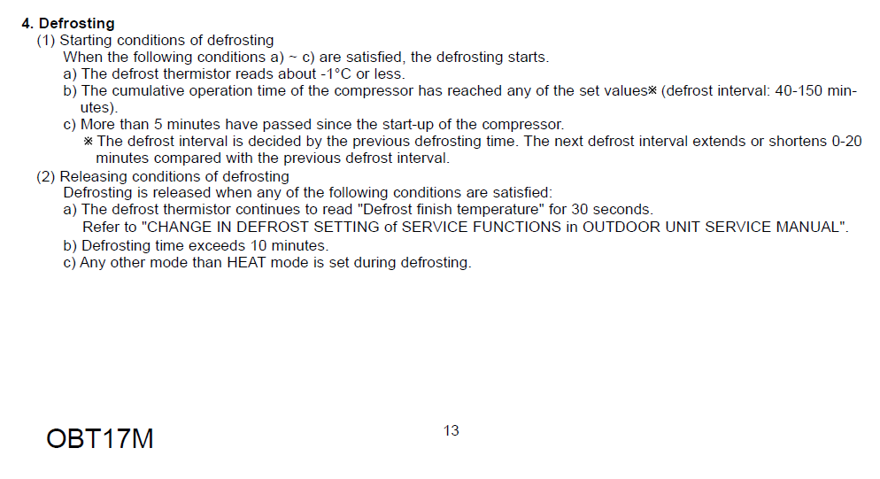

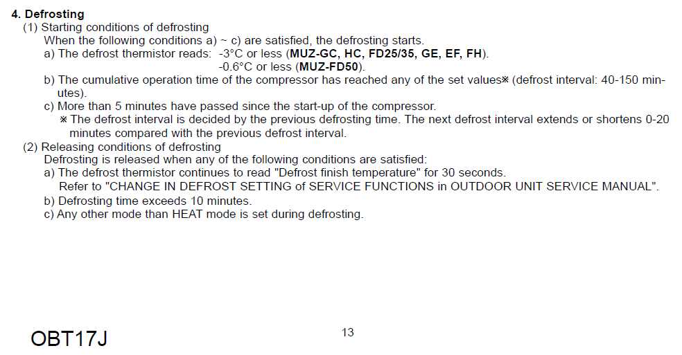

Sulatusehdot:
"4. Defrosting
a) The defrost thermistor reads: -3°C or less (MUZ-GC, HC, FD25/35, GE, EF, FH).
-0.6°C or less (MUZ-FD50).
b) The cumulative operation time of the compressor has reached any of the set values (defrost interval: 40-150 minutes).
The defrost interval is decided by the previous defrosting time. The next defrost interval extends or shortens 0-20
minutes compared with the previous defrost interval.
Defrosting is released when any of the following conditions are satisfied:
a) The defrost thermistor continues to read "Defrost finish temperature" for 30 seconds.
Refer to "CHANGE IN DEFROST SETTING of SERVICE FUNCTIONS in OUTDOOR UNIT SERVICE MANUAL".
b) Defrosting time exceeds 10 minutes.
c) Any other mode than HEAT mode is set during defrosting."

Tulevat lähiaikoina, Saksan virallisesti kesä-, heinä- kuussa (HyperHeating), no voi olla että jopa nyt saatavissa. R32 kylmäaine kaikissa myös HyperHeating malleissa, parempi numerot. Liiteenä sivut luettelosta. Koko saksankielinen luettelo.
