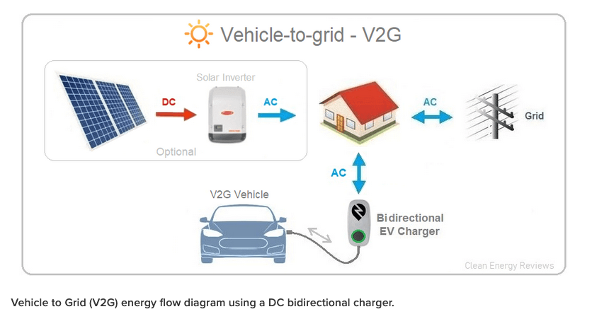

Ei ole. V2G:ssä joku ulkopuolinen brokeri jolla on näitä biljardi imaisee akkusi sähköt talon ohi GRIDiin verkon tueksi ja myy ne säätömarkkinoille. Ja lataa ne sitten kun tarvitaan säätökuormaa.
"V2G involves using energy from your EV to stabilise the grid. This is done through a ‘smart’ bidirectional charger, which is typically part of a VPP (Virtual Power Plant). Subject to defined parameters, your energy retailer will control when your battery is charged or discharged."
Toki tuota voinee jotenkin huijata antamaan sähköt taloon, mutta V2H on tarkoitettu siihen kotiakkuhommaan, siksi se on erikseen.
Ero V2G ja V2H välillä pieni (ohjelmistoa, mittari ja kytkin/grid isolation), jos ensinmainittu onnistuu onnistuu jälkinmäinenkin. Jälkinmäisessä vain myynti estetty. V2H ei varmaankaan tarvita verkohaltijan lupaa.
Edit: tällä hetkellä kaikissa autoissa missä on V2G on myös V2H. Ja näitä ei ole kuin pari hassua.
V2G real-life examples​
  • A company has 100 electric vehicles in its fleet. They are all plugged in and fully charged in the morning. The fleet manager dispatches 80 vehicles on their daily routes. 20 vehicles are free that day. For these 20 EVs, he enables Vehicle-to-Grid mode while setting the minimum battery charge level to 70% to keep them operational if needed. With V2G, the company is making a profit on these 20 vehicles even if parked.
  • A private user charges his EV overnight when electricity is cheaper. His car has a 400 km range on a full battery. He daily drives 100 km in total. So he enables V2G, and the vehicle returns the power to the grid when electricity is more expensive while still maintaining enough energy for him to make his daily driving.
  • A homeowner uses solar panels. The electricity produced is stored in the battery of the car. This power can be used to power his house, and if there is still any left, he returns it to the grid for a profit. All while maintaining his car at a battery charge level he needs for his driving.
  • An EV driver charges his car overnight and drives to work. There he plugs into the V2G charger and enables V2G. While at work, the vehicle returns the energy for profit, leaving him still enough charge to drive home.
