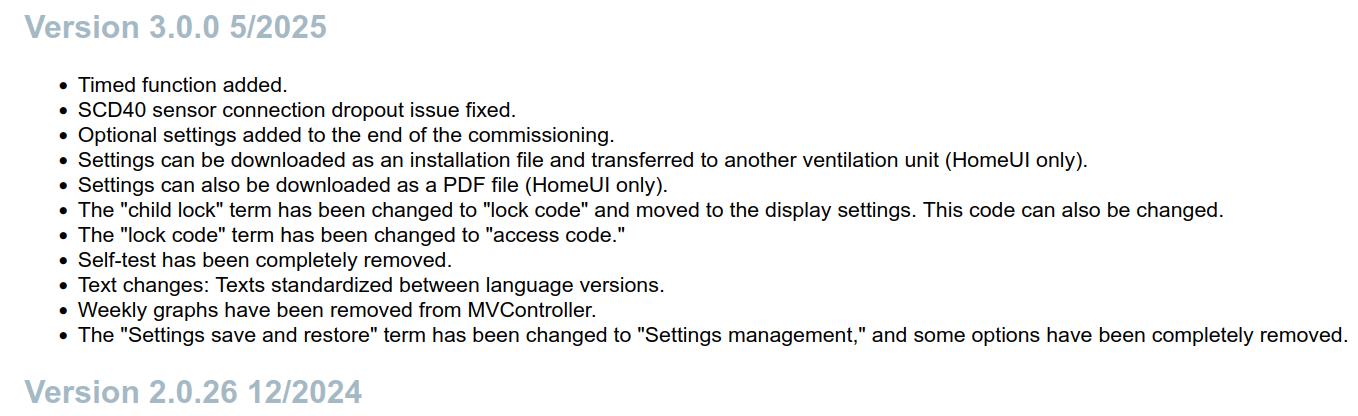

Version 3.1.0
9/2025
Text updates
Improvements to fan load calculation
Improvements to the settings installation file
Improvements to CF commissioning
The additional sensor temperature has been added to the controller temperature display
Bypass settings now use the additional sensor temperature for control when the sensor is installed in the supply air duct
CF base airflow rates can now be adjusted from expert settings
