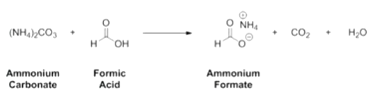

Ihan periaatteessa itse valmistaen tuon formiaatin pikkualipaineella (vesi pois!) ja ylilämpöä vältellen:
"Ammonium formate may be made in quantity by treating solid ammonium carbonate with a slight excess of commercial 85 per cent formic acid and concentrating the solution, in stages, on a steam bath under reduced pressure. The slightly moist product obtained by suction filtration is suitable for this preparation."
Raaka-ainelähde (ammoniumbikarbonaatti):
