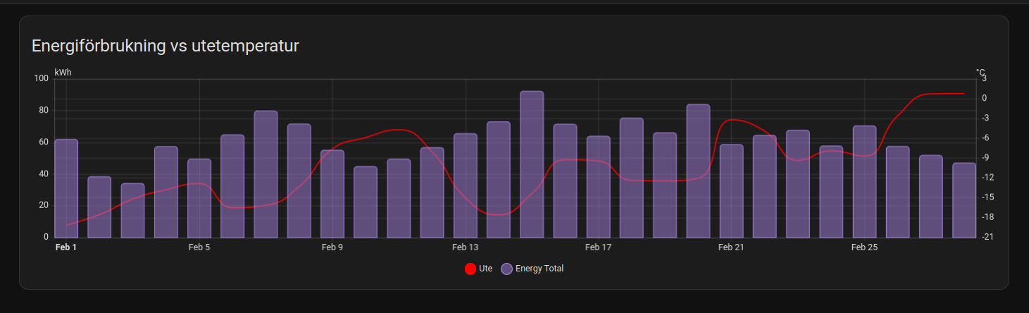

Halusin katsoa energiankulutuksen ulkolämpötilan kanssa, olipa yllättävän vaikeaa. Tuollaisella energy-custom-graph kortilla onnistui.
Koodi:
type: custom:energy-custom-graph-card
series:
  - chart_type: line
    stat_type: mean
    y_axis: right
    color: red
    statistic_id: sensor.ute
  - statistic_id: sensor.energy_total
    stat_type: change
    chart_type: bar
grid_options:
  columns: full
  rows: 6
title: Energiförbrukning vs utetemperatur
timespan:
  mode: energy
y_axes:
  - id: left
    unit: kWh
  - id: right
    unit: °C

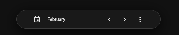

Footeriin kun tekee card_mod päivämäärävalitsimen kuten Energy-sivulla niin voi valita mitä periodia tarkastelee
Koodi:
type: energy-date-selection
card_mod:
  style:
    hui-energy-period-selector$:
      ha-date-range-picker$:
        date-range-picker$: |
          /* Forces the popup to open upwards */
          .daterangepicker {
            top: auto !important;
            bottom: 50px !important; /* Pushes it above the floating bar */
            margin-top: 0 !important;
            transform-origin: bottom left !important;
          /* Flip the popup arrow (optional, cosmetic) */
          .daterangepicker:before {
            border-top: 7px solid #ccc !important;
            border-bottom: none !important;
            bottom: -7px !important;
          .daterangepicker:after {
            border-top: 6px solid #fff !important;
            bottom: -6px !important;
      ha-card {
        /* Fixed position at the bottom */
        position: fixed !important;
        bottom: 30px !important;
        /* Horizontal centering (Stable method) */
        left: var(--mdc-drawer-width, 0px) !important;
        right: 0 !important;
        margin-left: auto !important;
        margin-right: auto !important;
        /* Styling / Dimensions */
        width: fit-content !important;
        min-width: 450px !important;
        height: 58px !important;
        padding: 0 40px !important;
        z-index: 9000 !important;
        background: rgba(25, 25, 25, 0.95) !important;
        backdrop-filter: blur(15px);
        box-shadow: 0px 10px 40px rgba(0,0,0,0.8) !important;
        border-radius: 30px !important;
        border: 1px solid rgba(255, 255, 255, 0.15) !important;
        display: flex !important;
        align-items: center !important;
        justify-content: center !important;
      .card-content {
        padding: 0 !important;
        width: 100% !important;
        justify-content: space-between !important;
      /* Hides the host element in the grid layout */
      :host {
        position: absolute !important;
        width: 0 !important;
        height: 0 !important;
(varastettu internetistä tämäkin, ei mun tekemä)

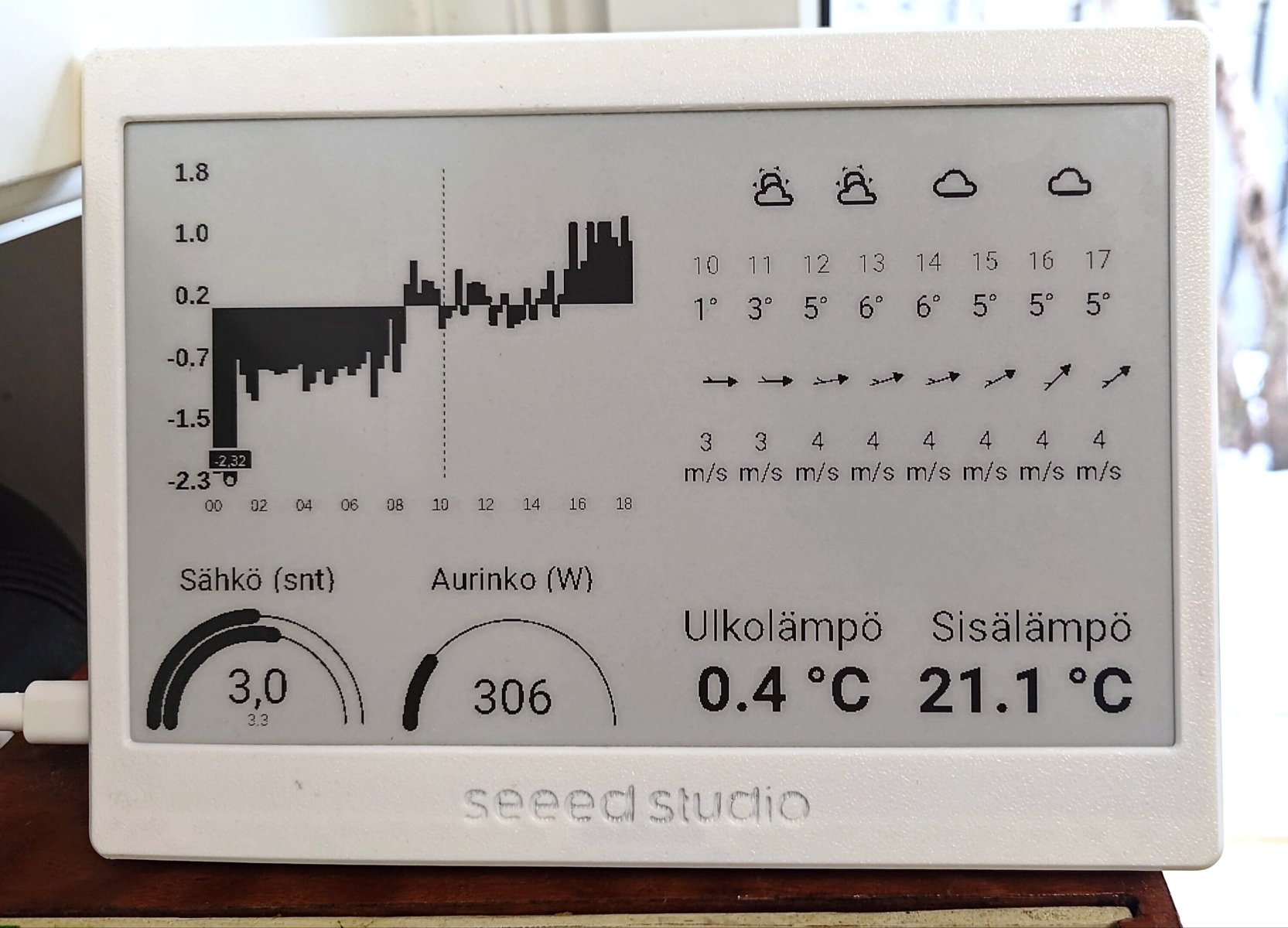

Tuli lisättyä ESP32-pohjainen eINK näyttö omaan HA-systeemiin näyttäämään sähkön hintaa (poikkeamana päivän keskihinnasta), paneelien tuottoa, sääennustetta ja lämpötiloja. Puppet add-on ottaa Lovelacen sivusta kuvan joka sitten siirretään näytölle. Kuvien mustavalkoistamisessa oli jonkin verran askartelua.

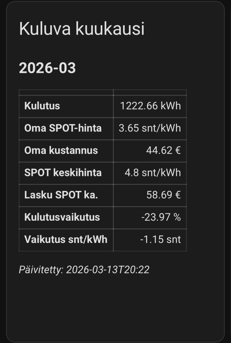

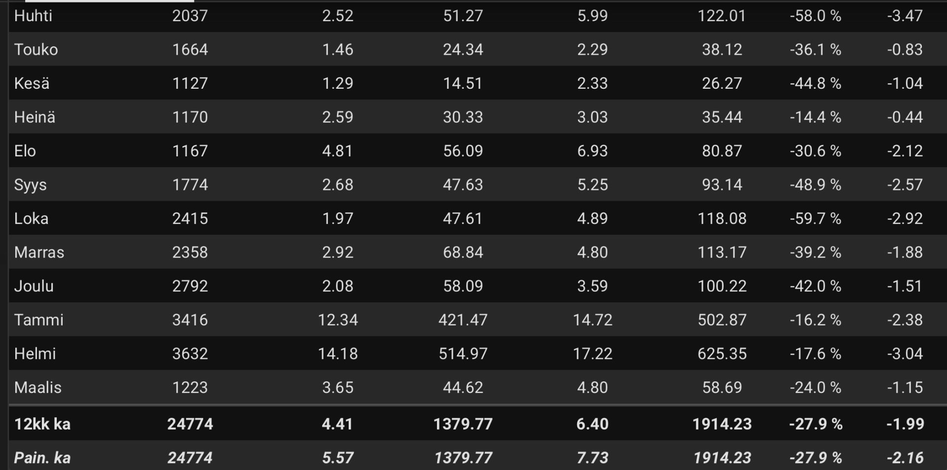

Taulu käyttää kulutustietona Shelly Pro 3EM tuottamaa dataa, johon tehty pieni kalibrointi korjaus että vastaa datahubin tietoja. Carunan mittari näet driftannut mittausta ylöspäin

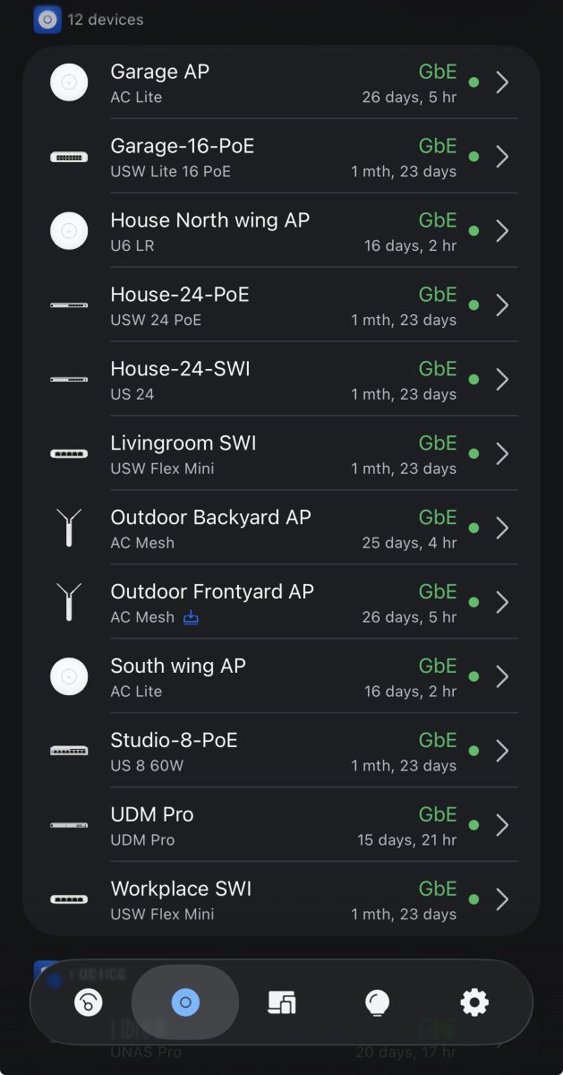

Millainen verkkoratkaisu sinulla on näille? Ei taida nuo kaikki mennä yhteen IP avaruuteen?
Kaikki ei ole IP:n vaativia laitteita. Niiden lisäksi löytyy Bluetooth, zigbee ja ZWave laitteita.
Verkko on Ubiquiti UniFin laitteilla toteutettu.
12 verkkolaittetta ja UNAS
IoT verkko on /23 eli 512 osoitetta, IP laitteita verkossa ei ole kuin n.200

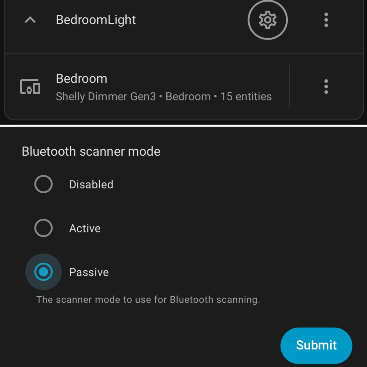

Tarvitset BTgatewayn, Shelly gen2+ malleista löytyy passiivi BTproxy.
Sen saa aktivoitua HA laitenäkymästä,
Passiivi BTproxy kuuntelee BLE viestejä ja välittää ne HA, mutta ei pysty ohjaamaan laitetta esim.Yale lukko

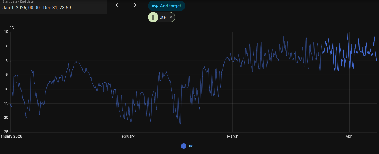

Saako jostain muutettu miten useasti HA kirjaa tietoa. Esim. minulla on lämpötila-/kosteusantureita ja osassa riittäisi että kirjaa tiedon esim. tunnin välein. En niillä toistaiseksi ohjaa mitään.
Yritin kahlata HA:ta läpi mutta en semmoista löytänyt, voi olla käyttäjävirhekkin. Sen verran vähän kilometrejä tuon kanssa takana.
useimmiten se on sensori mikä lähettää tiedot ja HA vain kirjaa ne.
Itsellä on n.130M datapistettä historiassa vuodesta 2022 lähtien. Osa datapisteistä on tiivistetty että energia/teholukemista on vain 15min keskiarvo
Ja HA tiivistää ne tiedot oliko se nyt oletuksena 30 päivän jälkeen. Näkee kuvaajista niin että käyrä on vähän vaisumpi jos on yli 30 päivää vanhempi
Jos zoomaa sisään vanhemmilla päivämäärillä on tuo käyrä hitusen kulmikkaampi, mutta muuten tuota ei huomaa.

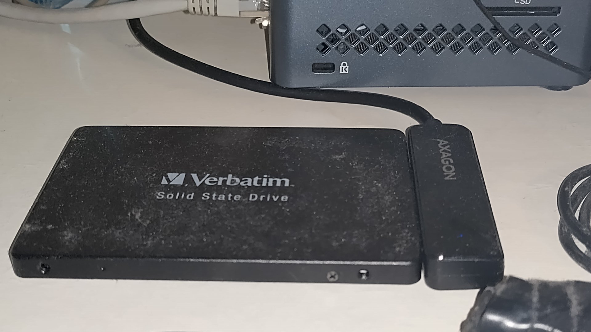

Taisit tarkoittaa ihan ulkoista ssd kovoa joka liitetään esim. usb3 porttiin? Mietin vain kun myyjä sanoi ettei SSd:tä saisi suoraan tuohon Raspberry 4:seen liitettyä mutta taisi käsittää että puhun kammasta. Sen taitaa saada lisäosalla liitettyä. Ajatuksena kuitenkin itselläni juuri käyttää tuota usb-porttiin liitettävää. Toki pitää joku pienempi hankkia kun ei ole järkeä laittaa tuota 1t:sta siihen kiinni kun huomannut että kuinka vähän se muistia vaatii.
Tarkoitin USB-adapterilla liitettyä SSD-levyä, eli joko tavallista 2,5” SATA-SSD:tä tai M.2-levyä erillisessä USB-kotelossa/adapterissa. Raspberry Pi 4 tukee molempia, pienin varauksin. Netistä löytyy toimivat ratkaisut.
Eli käytännössä vaihtoehdot ovat:
2,5” SATA SSD + USB–SATA adapteri/kotelo → yleensä halvin ja varma ratkaisu.
M.2 SATA SSD + USB-kotelo → pienempi fyysinen koko.
M.2 NVMe SSD + USB-kotelo → nopein vaihtoehto, mutta Raspberry Pi 4:n USB3 nopeus rajoittaa hyötyä.
Kiitos täsmennyksestä, kyllä se taitaa tuo ensimmäinen vaihtoehto olla. Pitää vähän tutkia että minkä SATA SSD:n siihen hankkisi, iso tilavuudeltahan sen ei tarvitse olla.
Ohessa oma esimerkki taustalla olevan mini-PC:n backup-puskuri-SSD:stä USB-adaptereineen. SSD-diskin ja adapterin yhteishinta on ollut jotakin 50 euron vaiheilla (muutaman vuoden ikäinen kombo, jota ei hankittu yhdellä kertaa, vaan kasattiin ylijäämäosista).

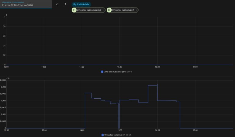

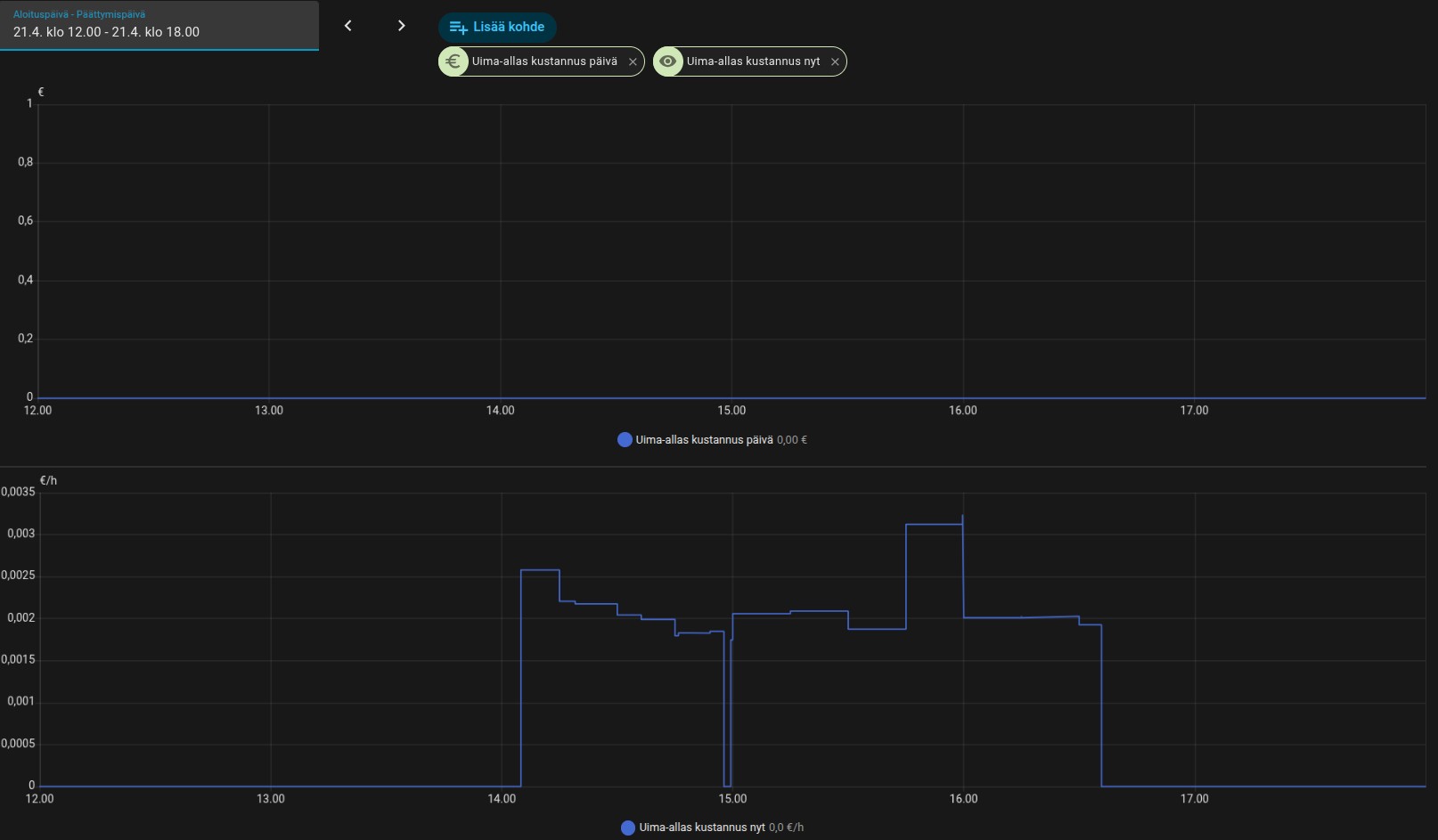

Mä en ymmärrä miksei `utility_meter` toimi päivitttäisen kustannuksen laskemiseen? Hetkellinen kustannus on ok eli osaaks kukaa sanoa mitä teen väärin? Liitteenä esimerkkikuva...
PS. Mulla on myös kuukausittainen, mutta sekä päivittäinen että kuukausittaisen arvo ei ole muuttunu 0:sta mihinkää.
YAML:
template:
  - sensor:
      # Hetkellinen kustannus (€/h)
      - name: "Uima-allas kustannus nyt"
        unique_id: uima_allas_kustannus_nyt
        unit_of_measurement: "€/h"
        state_class: measurement
        state: >
          {% set power = states('sensor.uima_allas_teho') | float(0) / 1000 %}
          {% set price = states('sensor.nordpool_kwh_fi_eur_3_10_0255') | float(0) %}
          {{ (power * price / 100) | round(6) }}
YAML:
sensor:
  # Kustannus (€)
  - platform: integration
    source: sensor.uima_allas_kustannus_nyt
    name: "Uima-allas kustannus (€)"
    method: left
    unit_time: h
YAML:
utility_meter:
  uima_allas_kustannus_paiva:
    unique_id: uima_allas_kustannus_paiva
    name: "Uima-allas kustannus päivä"
    cycle: daily
    96,7 KB · Lukukerrat: 47

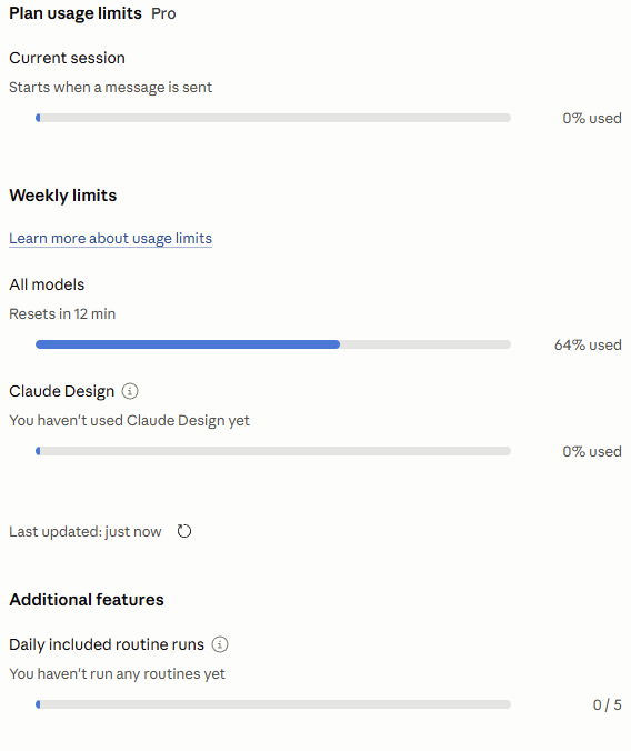

Huh huh.. Kyllä on ollut hienot pari päivää AI koodauksen kanssa. Ostin parinkympin Openai Plus 1kk setin ja nyt päivitellyt home assistantin juttuja.
Eli rajoituksia on silti ollut ja olen ns. joutunut käyttämään gpt-5.3-codex high modelia. Monet ns. paremmista ei olleet jostain syystä tuettuja.
Ei siinä mitään tämä on ollut omaan käyttöön ihan riittävä ja enemmänkin. Olen poistanut paljon "ongelmia" jne. systeemistä. Lisäksi olen optimoinut varmaan kaikki tärkeät automaatiot ja samalla tietty poistanut mahdollisia ongelmia. AI on luonut minulle uusia käytännöllisiä automaatiota, mitä en olisi ikimaailmassa pystynyt itse tekemään. Kaikki tämä parissa päivässä ja missään vaiheessa ei ole tokenit loppuneet. 5h tokenit olivat "pahimmassa" tapauksessa jossain 20% tienoilla. Weeklyt jossain 60% paikkeilla. Ja nyt periaatteessa kaikki on jo tehty. Yritän nyt kovasti miettiä mihin loput kk tokenit voisi käyttää. 🤓😆
Kyseessä https://github.com/simon-binks/codexcode addon, jota en periaatteessa suosittele, koska päivitykset eivät ole ajantasalla ja codex tuki loppuu n. viikon päästä. Eli jos päivityksiä ei tule, niin varmaan loppuu toiminta.
