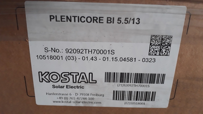

Kostal Plenticore Bi patteriinvertterissä on ajastus mahdollisuus lataukselle mutta myös digitaalinen tulo sekä modbus TCP ohjausmahdollisuus. Eli tarvitsisi ulkoisen ohjelman millä aktivoida patterin lataus tai purku.
With external battery control, an external market operator, e.g. an energy supply company, controls the charge/ discharge of the battery by means of an external energy management system. Here, for example, the energy of the battery can be fed into the public grid as required, e.g. by the energy supply company, or charged from the public grid to stabilise it. The battery energy can of course also be used in your own house grid.
Information about the configuration of the external control can be obtained from the relevant service provider"
(e.g. energy supply company).The advantage for the plant owner is that he or she receives remuneration from the external supplier for the"
energy provided, for example.
If external battery control via Modbus (TCP) is selected, the battery inverter receives the control signals for charging and discharging the connected battery via Modbus (TCP). For this purpose, the battery inverter must be connected to the Internet via Ethernet (LAN). The internal energy management remains active, but is overridden by the external specifications regarding charging and discharging capacity.
