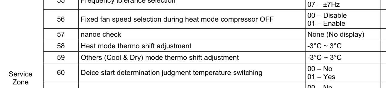

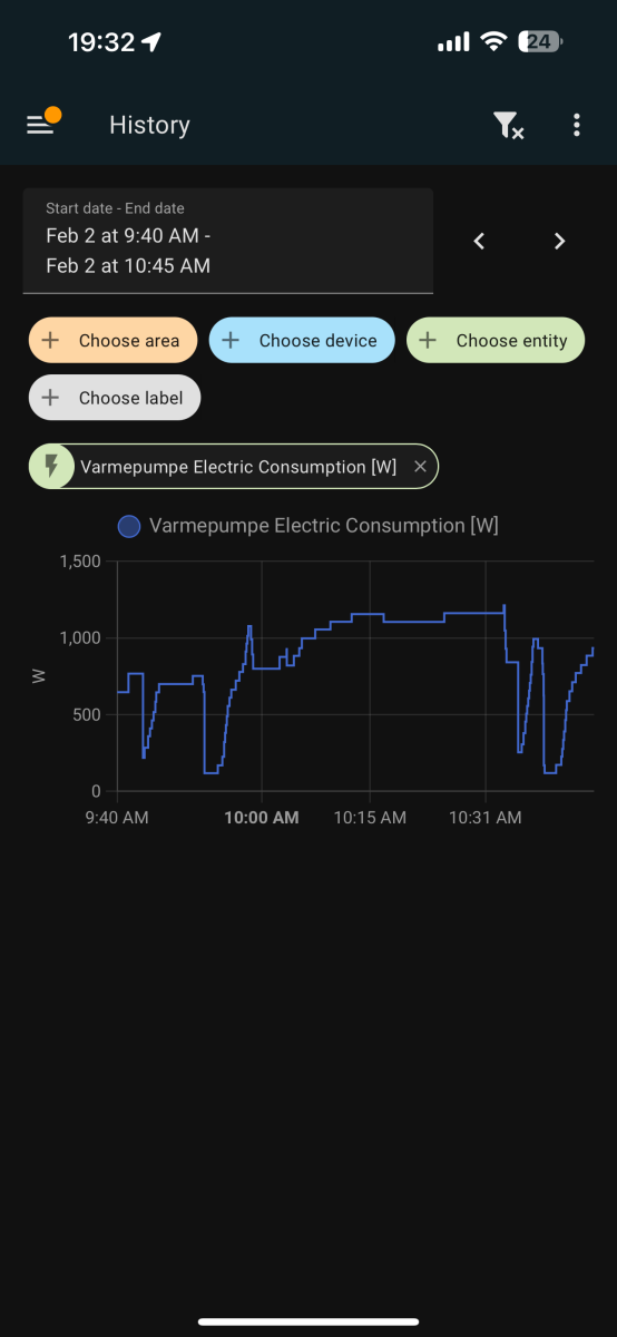

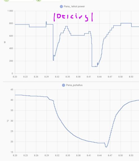

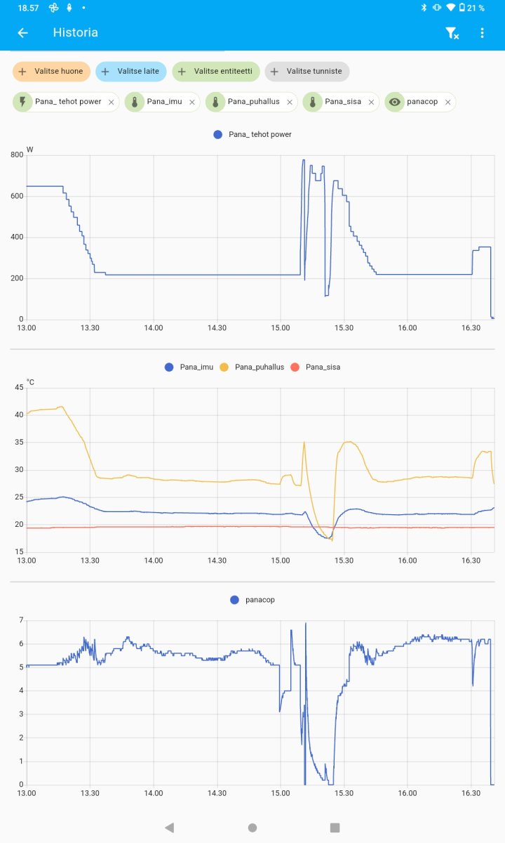

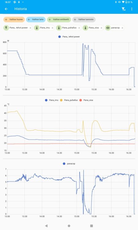

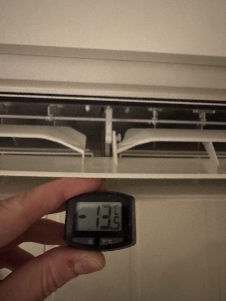

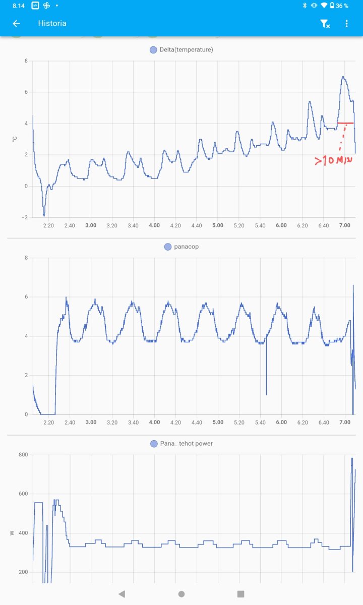

Picture of Pana's defrost phase below. If defrost is really needed deicing phase will take about 10 minutes. If there is no ice in the heat exchanger, the deicing phase will only take a minute.
When the outside temperature is between -1...+2 C, unnecessary defrosting occurs too often. I'm trying to find out if there are ways to prevent those.

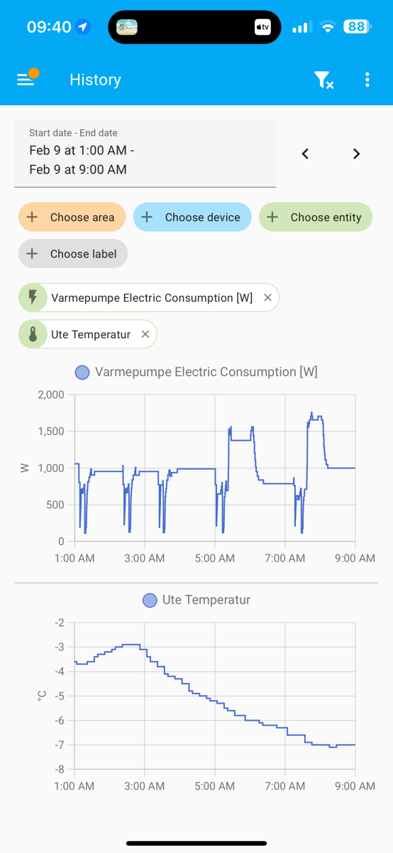

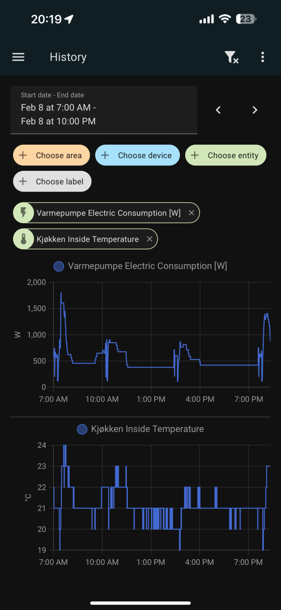

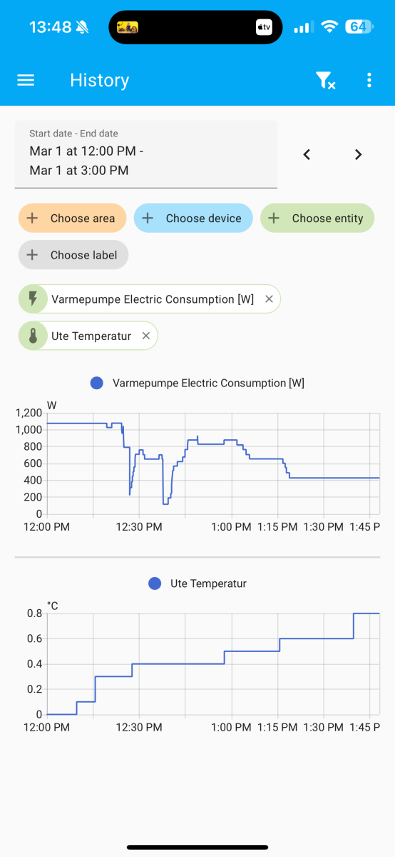

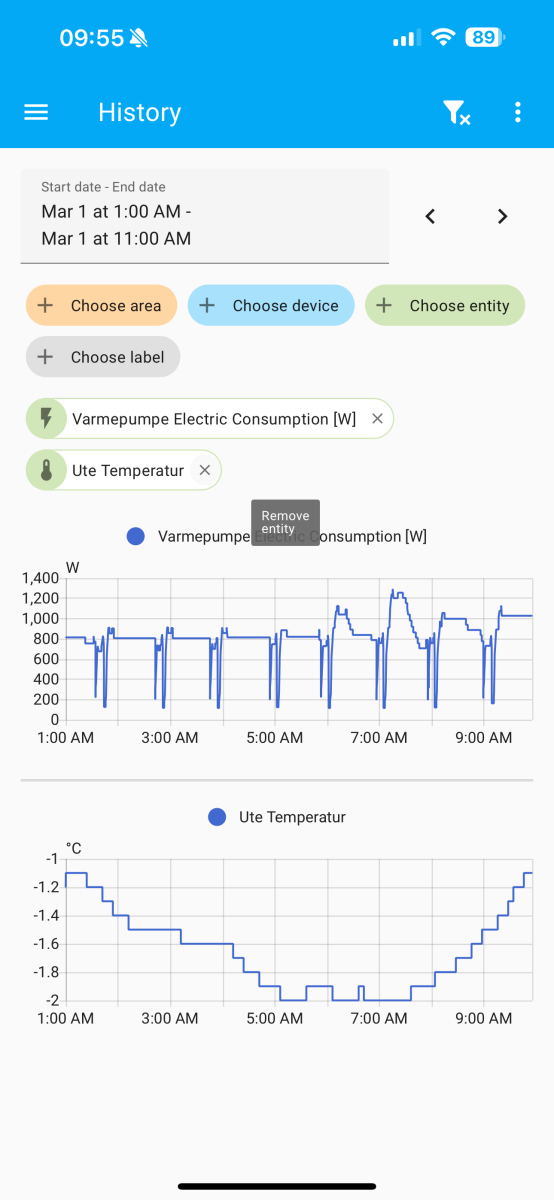

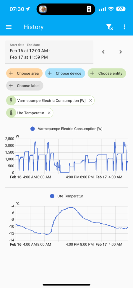

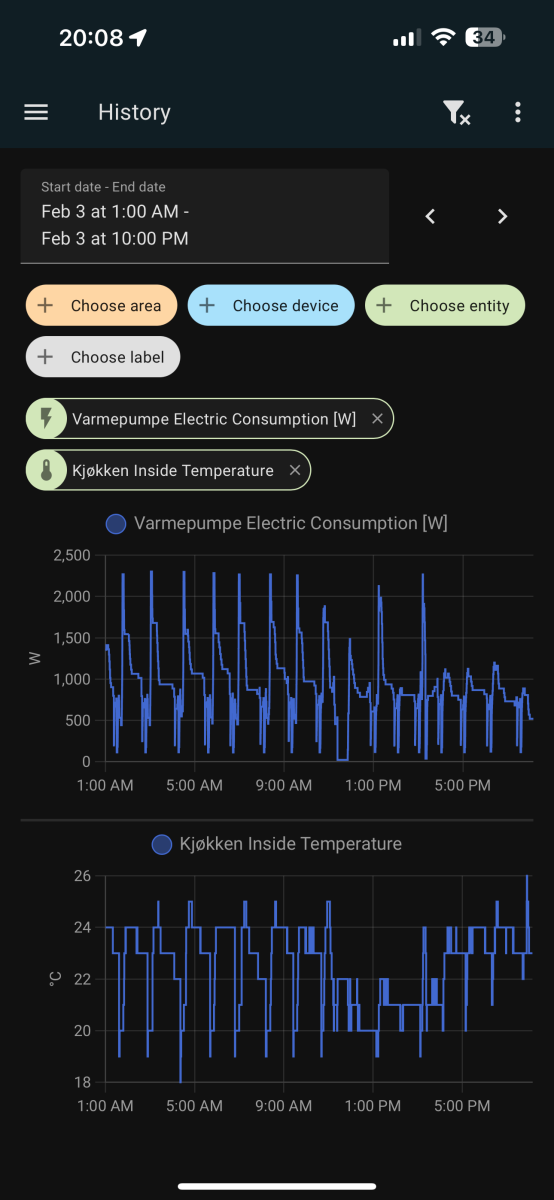

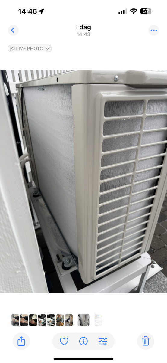

I noticed it this morning actually, it went into deice without any need and had a short cycle.
Good to have a discussion to get some inputs on how to use the pump better at least…does your inside temp sensor also go really low after a defrost?
    70,2 KB · Lukukerrat: 128
    637,2 KB · Lukukerrat: 131

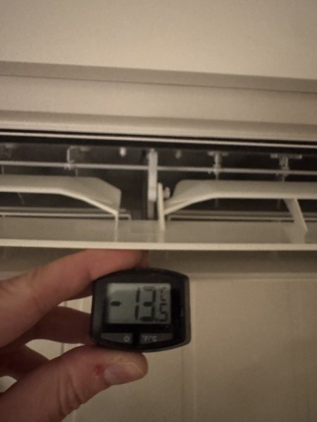

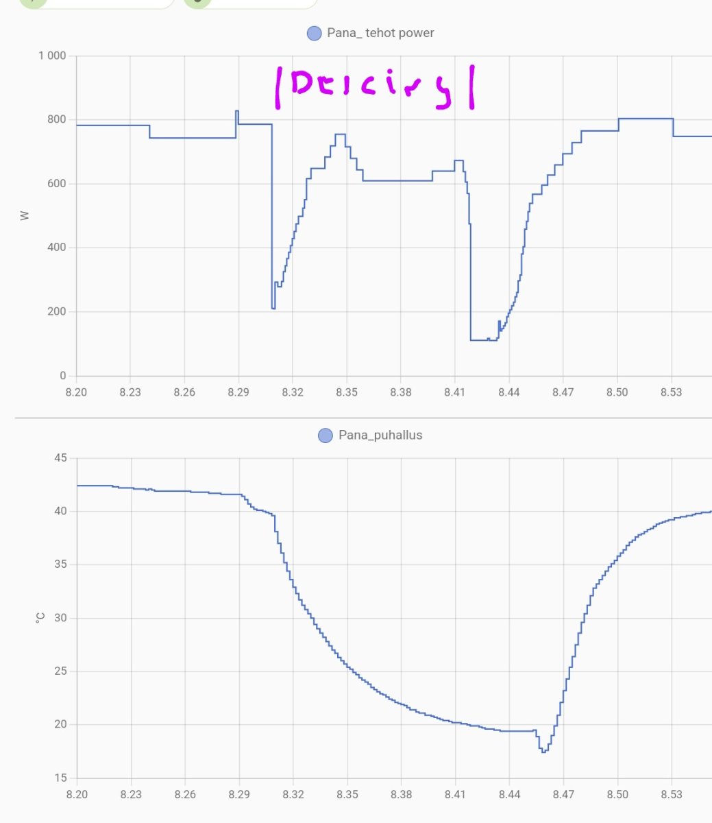

@iro : is that the blowout temperature in the lower graph? Mine is kinda lower…
If anyone else can measure theirs during deice it would be nice to see if what I’m experiencing is normal or not. Cannot say I noticed that the mitsu I had had frost on the inside unit and was throwing out negative degrees when defrosting.
    87,8 KB · Lukukerrat: 140
Yes, the diagram shows the blowing temperature. The sensor is placed a little further from the heat exchanger so when the fan is off the temperature is close to indoor temperature.

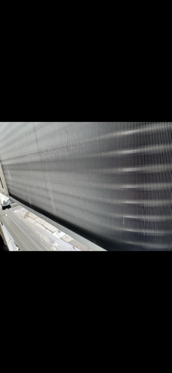

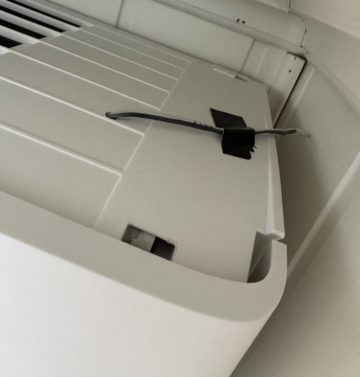

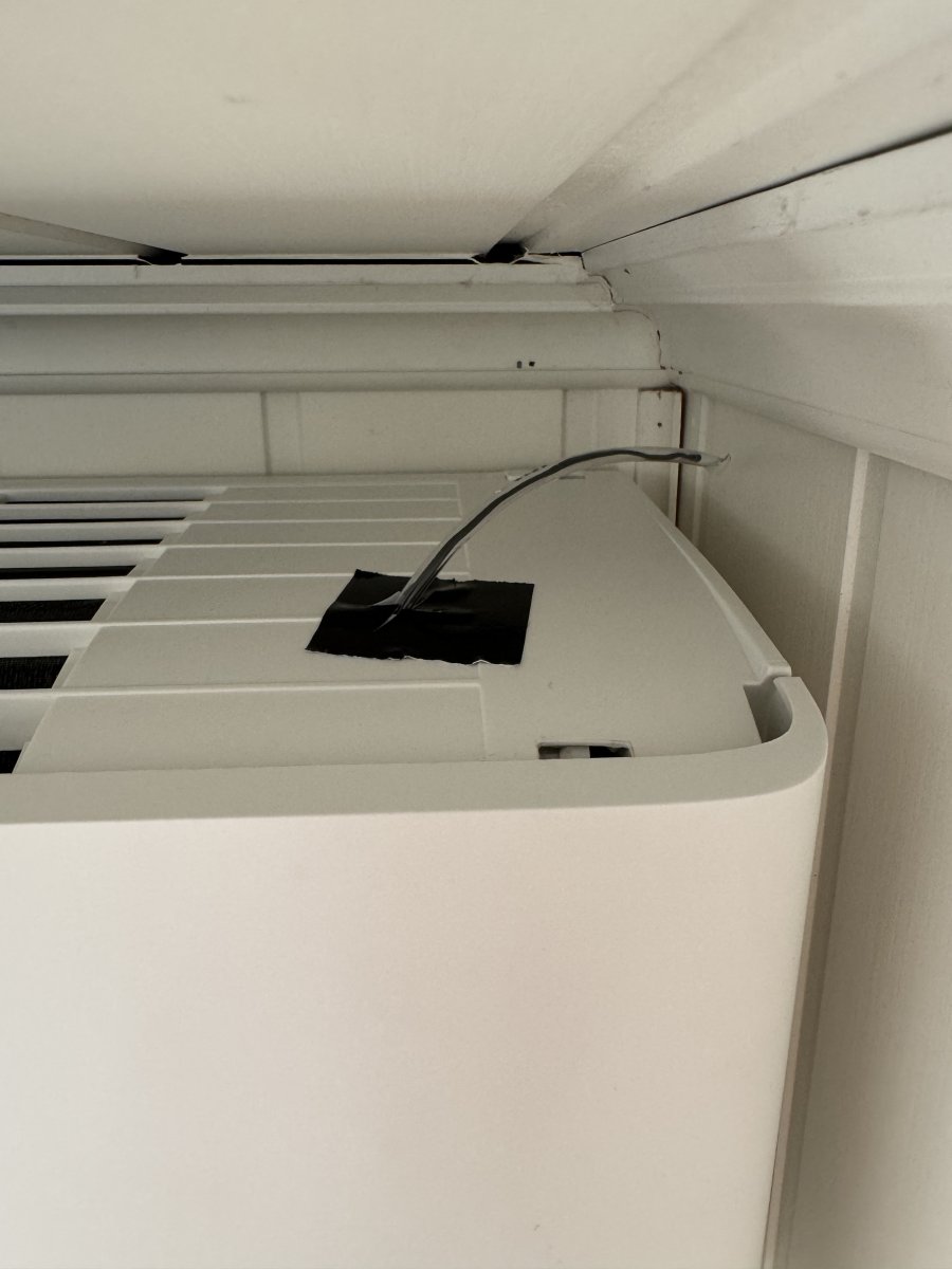

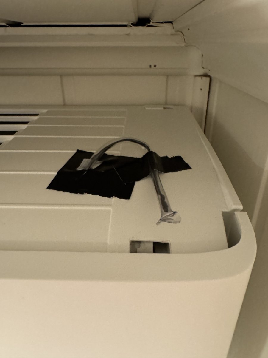

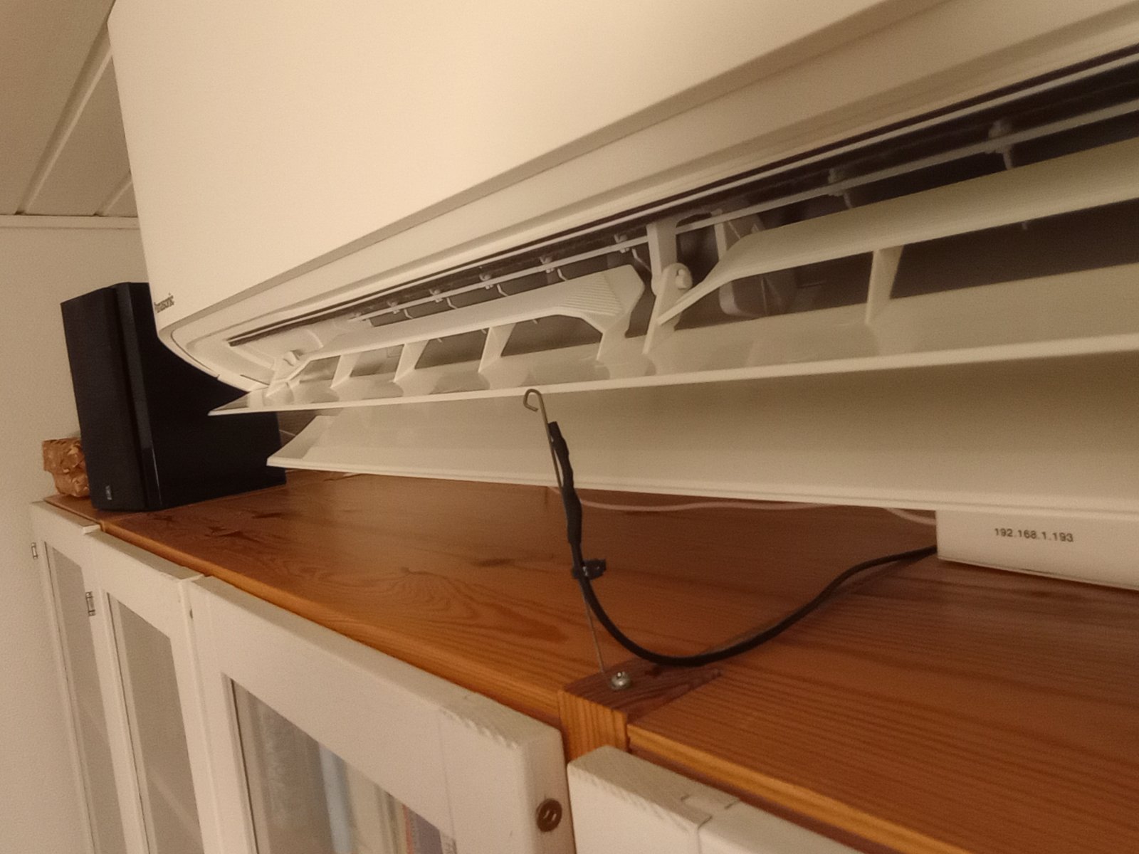

I had some spare time today, so the drill was pulled out of the garage.
Drilled a hole in the plastic and moved the sensor outside, working on where the best spot for is, but seems that’s it’s in a good place now. Temp in the kitchen has stabilized now as well during the evening so the fluctuation is a bit less than after the temperature dropped a bit without heating when I was drilling.
My automation is now turned off, so far no initial big rushes, consumption stabilizes a bit more as well.
Going to try some different locations to see which one is ideal.

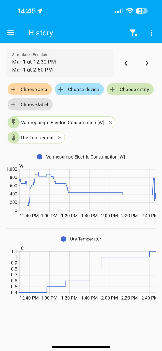

Put sensor in matchbox case where is cotton wool inside. Does not fluctuate so much with air. Helped in old mitsubishi fd25 a lot. De-icing time intervals went from 45min to 1h 45min.

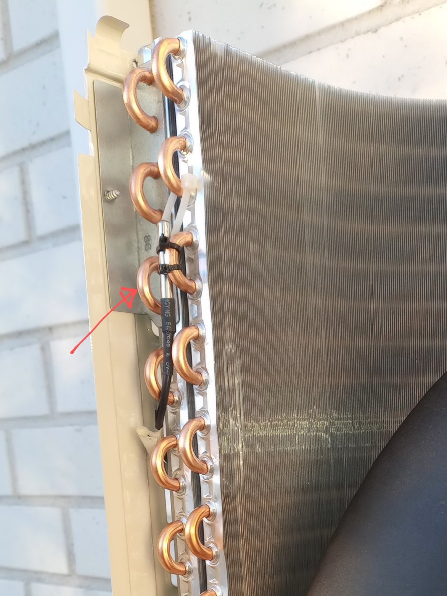

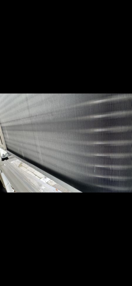

Tutkailin lisää Panan tarpeettomia sulatuksia ulkolämpötilassa 0 ... +3°C. Tuolloin ulkoyksikön kenno vuoroin huurtuu kylmimmiltä osin ja vuoroin sulaa, samassa tahdissa ottoteho vaihtelee 330W ja 380W välillä (sykli noin 30min) . Suurempi teho lisää kennon huurtumista, pienemmällä teholla huurretta sulaa. Sulatusvaiheessa vesi valuu kennon alaosaan, mutta sieltä kaikki vesi ei ehdi poistumaan (ulkoyksikön puhallin käy pienillä kierroksilla) ennen seuraavaa suuremman ottotehon vaihetta. ==> Vesi jäätyy kennon alariveille ja pitää tuota osaa muuta kennoa kylmempänä. Seuraavalla tehovaihtelusyklillä sama toistuu ja kennon alaosan lämpötilaero suhteessa muuhun kennoon kasvaa edelleen. Koska Panan oma kennoanturi on sijoitettu kennon alaosaan, DeltaT (= ulkolämpötila - kennon lämpötila) ylittää liipaisurajan (5°C ?) ja sulatus käynnistyy. Tuossa vaiheessa kennon saattaa olla lähes huurteeton ja kennon keskiosasta mitattu DeltaT on noin 2°C.
Koska kennossa ei juurikaan ole sulatettavaa, aktiivinen sulatus kestää vain minuutin verran, mutta koko vaihe ottaa 5 - 10 min. Panan lämmöntuoton näkövinkkelistä tuolla ei ole suurta merkitystä, mutta käyttömukavuuden kannalta on ei toivottu ominaisuus.
Mitä asialle voisi tehdä ?
1) Panan kennoanturin siirtäminen vähemmän huurtuvaan osaan kennoa. Anturi on sijoitettu hankalasti tavoitettavaan paikkaan ulkoyksikön kennon päätyyn koneiston taakse. En tiedä kuinka helppoa sen paikan vaihtaminen olisi.
2) Huijata Panan sulatuslogiikkaa kytkemällä "huijausvastus" Panan kennoanturin rinnalle ==> huijausvastuksen arvolla 68Kohm Pana näkee kennoanturin lämpötilaan 6°C todellista lämpimämpänä eikä näin aloita sulatusta. Kun todellinen sulatustarve havaitaan "huijausvastus" kytketään irti ja nyt Pana näkee oman kennoanturinsa todellisen lämpötilan ja aloittaa sulatuksen. Tämä olen toteuttanut ja nyt sulatuksia tehdään vain tarvittaessa.

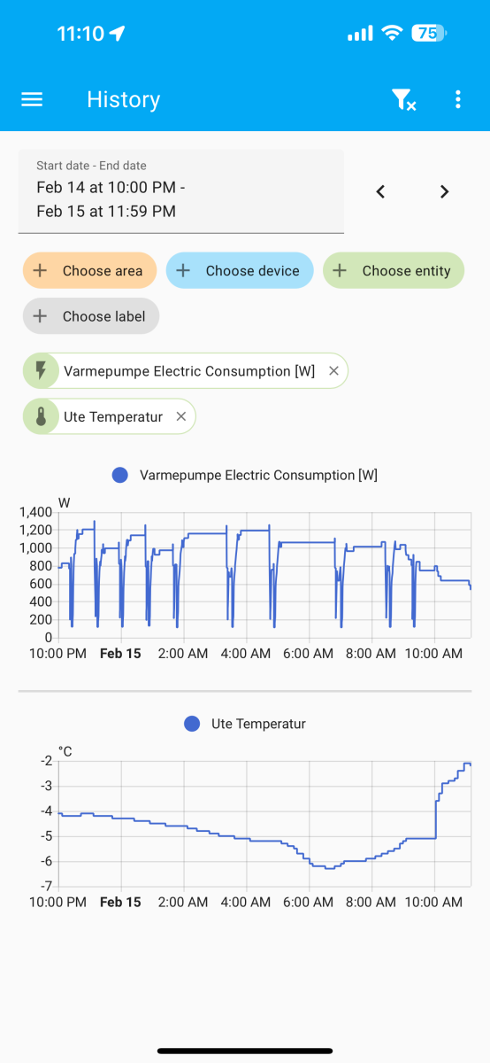

Seems Im still getting spikes after a defrost but not as bad as before, probably because of cold transferring from the wall to the ambient, but it runs more stable now and temperature inside is more stable as well. Seems this is the better location for the sensor in my case, will see when it gets colder if I’ll move it, but it gets more air around it when the unit is on compared to the other locations I’ve tried.
5 hours without defrosting isn’t bad.
-6 to -9 reported the next days, so will be interesting to see how it works then.

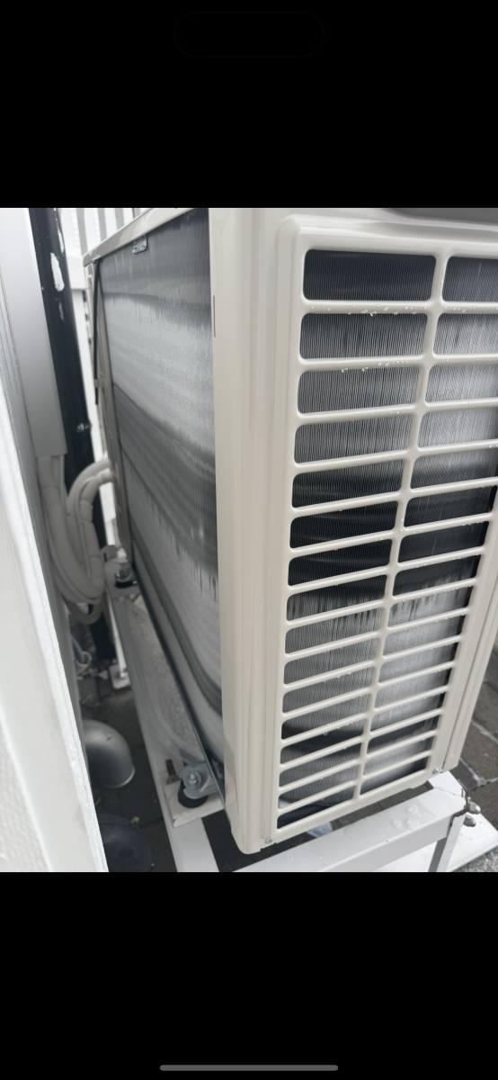

I haven’t noticed any water freezing in the lower parts of my cell when it’s running long, but will take a look next time.

Minulla on anturi mittaamassa kennon lämpötilaa, kuva 1 nuolen osoittama paikka. Kun tuon anturin DeltaT (=ulkolämpötila - anturin lämpötila) ylittää liipaisurajan huijausvastus irrotetaan. Liipaisuraja on minulla DeltaT yhtäjaksoisesti 10 min > 4°C, Kuva 2. Kuvassa näkee kuinka DeltaT vaihtelee kennon huurteisuuden mukaan, keskimääräinen huurteen määrä lisääntyy. Alemmasta käyrästä näkee, että myös COP vaihtele huurteisuuden mukaan, mutta pysyy keskimääräisesti hyvällä tasolla koko lämmitysjakson ajan.
Ohjauslogiikan olen toteuttanut hieman modifioidulla Mitsurunnerilla.

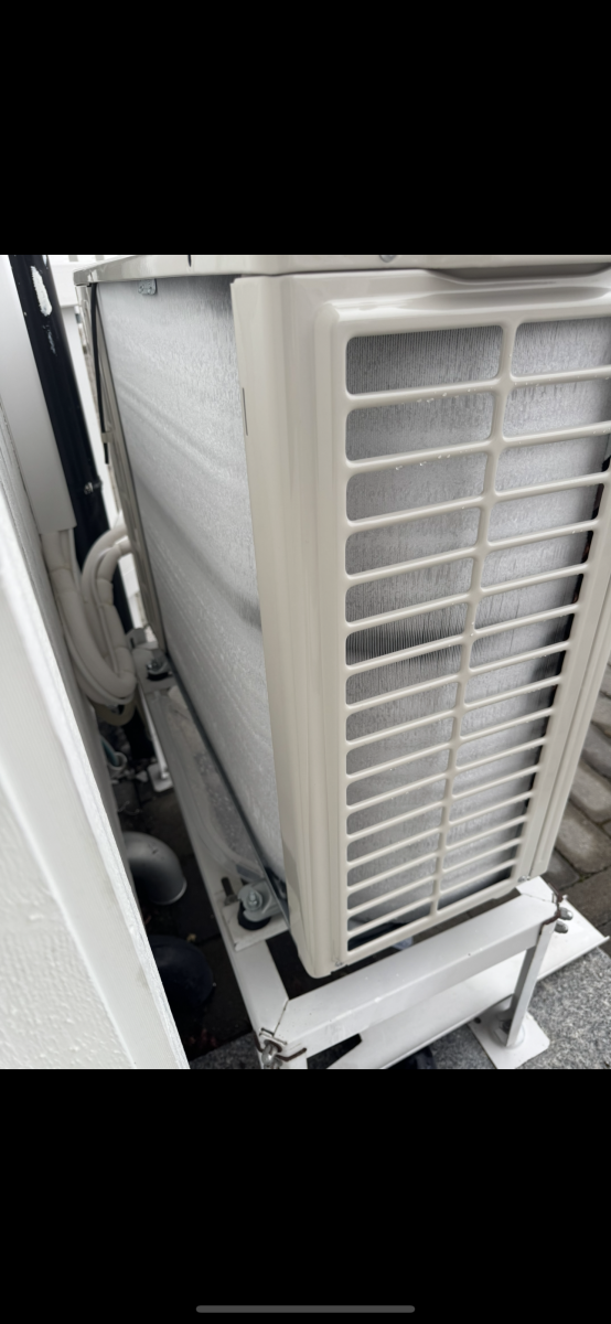

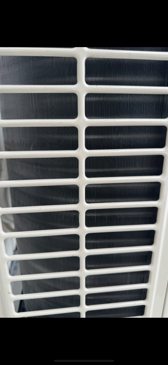

Anyone noticed that the plastic vanes are deforming when defrosting after a few weeks of using? It seems to get a «bend» in the middle making a slightly U shape.
pump seems to be working a lot better with the relocation of the temp sensor.
Have not seen at NZ, but I will check later

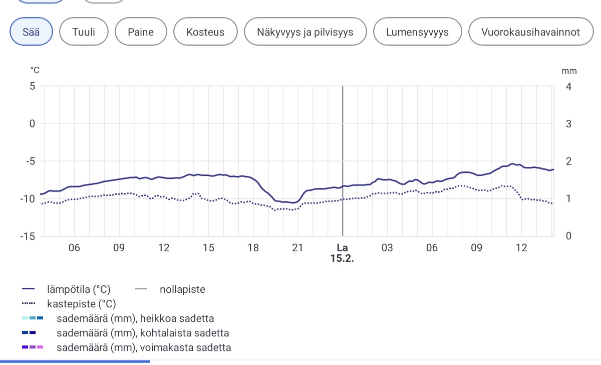

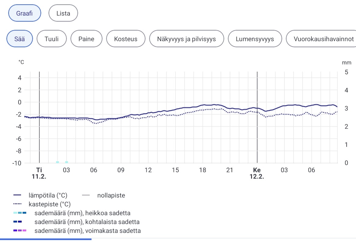

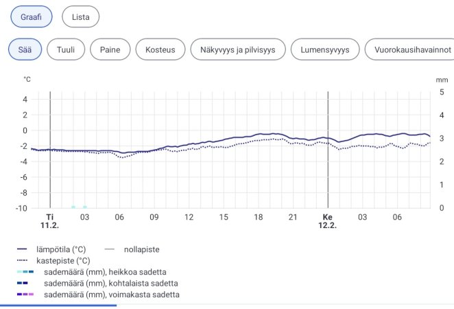

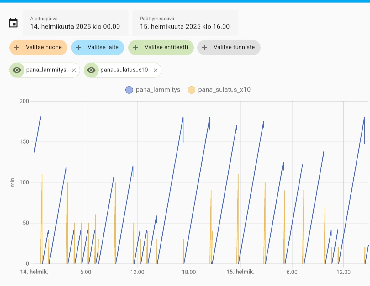

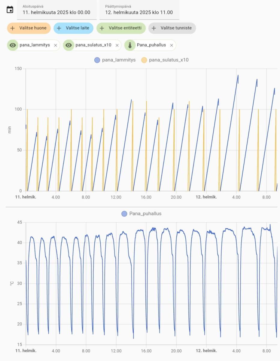

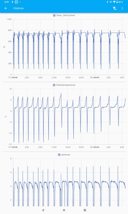

Laitan tähän näyteen Panan tehokkaasta toiminnasta pikkupakkasella kun kastepiste on vain hiukan ulkolämpötilaa alempi. Kuva 1 Lämmitysjakso ei ole kovin pitkä, mutta kuten COP- ja DeltaT-käyrät osoittavat että kaikki sulatukset ovat olleet tarpeellisia. Ottoteho on lähes vakio koko lämmitysjakson ajan. Kuva 2.
Lämmitys/sulatusvaiheen pituudet kuvassa 3 (skaalauksen vuoksi sulatusvaiheen pituus on kuvassa kymmenkertaisena eli sulatus kestää noin 10 min). Kuvan alemmassa käyrässä puhalluslämpötila.

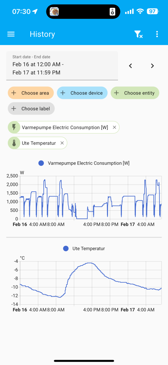

So it seems the relocation of the sensor has made the pump to work more as expected. Although there is the occasional unnecessary defrost, at least it is very short when it starts. I’ve noticed it usually does this when the pump has been off during the mid day when the sun is heating up the house and it’s turned back on again in the afternoon (just by turning down the temperature setpoint).
In normal operation I have never seen the pump deliver its stated minimum input power though, kind of disappointed with that.

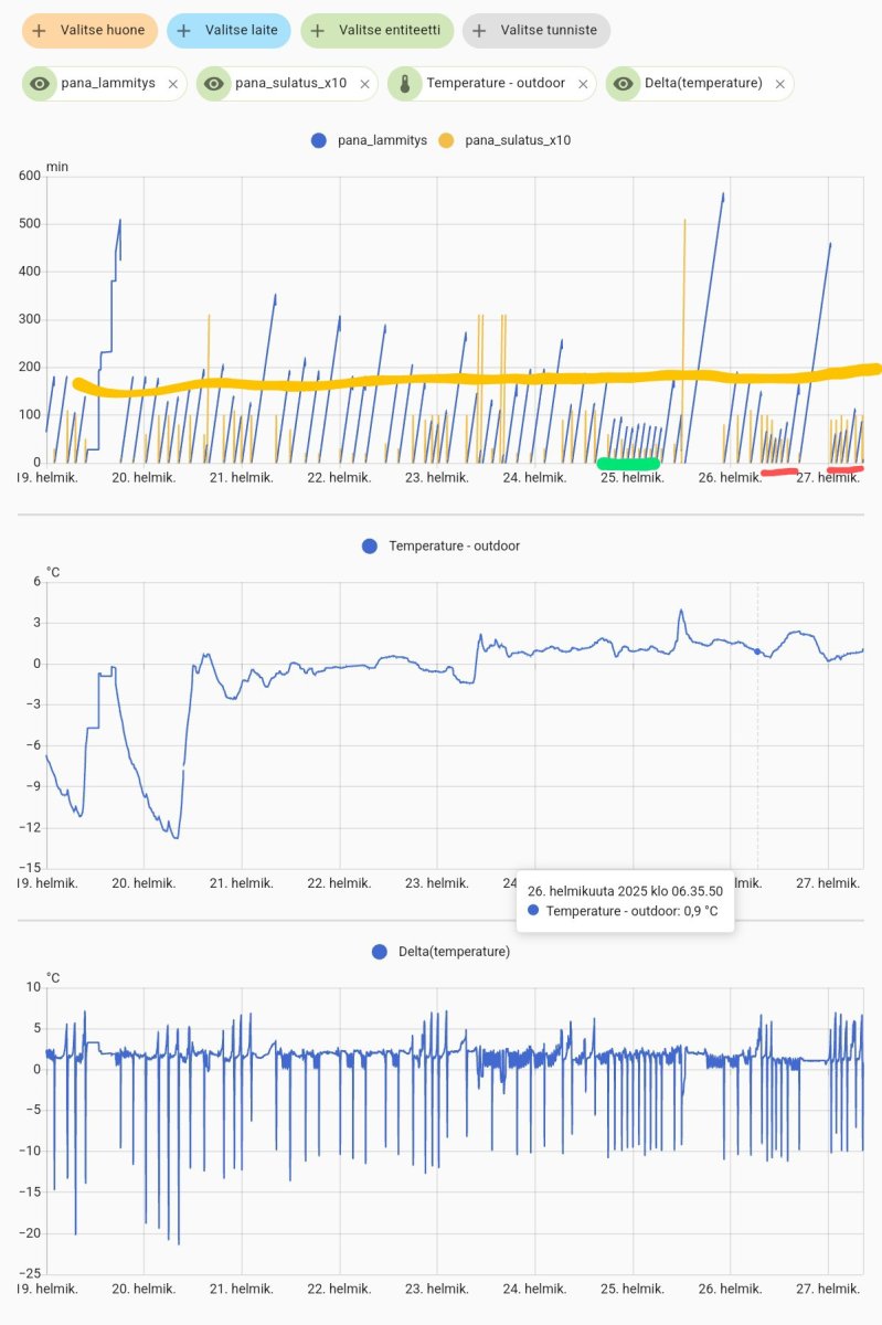

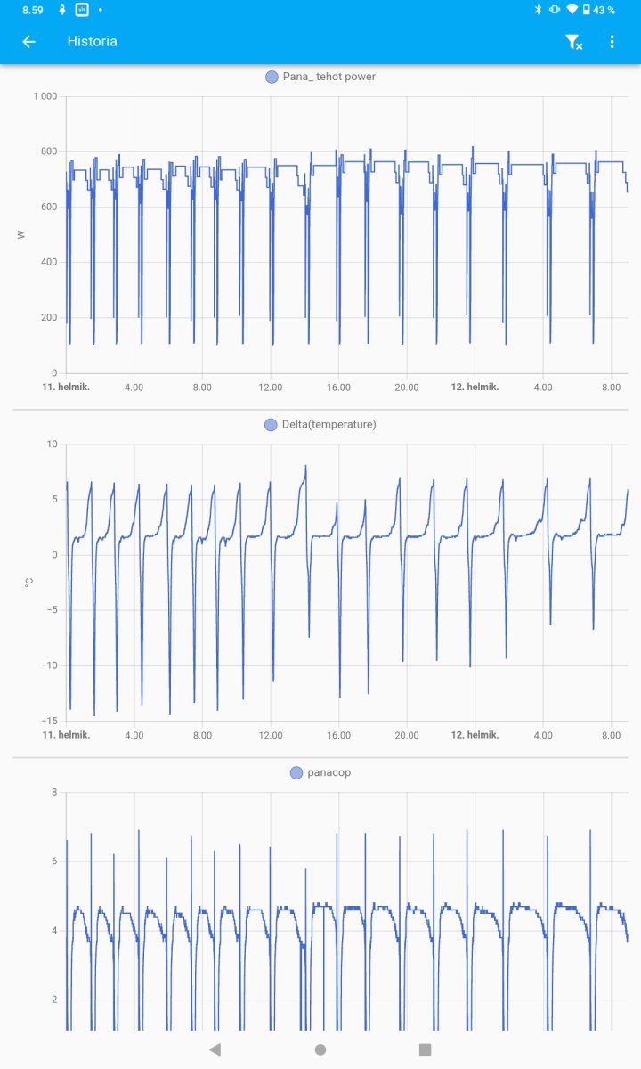

I'm now able to control Pana's defrosting with "Mitsurunner"-solution. Below are some charts comparing the operation with/without Mitsurunner. It shows that Pana's own logic keeps heating-periods too short.
The input power has been around 600-700W. A couple of higher peaks because of Pana was turned off for a moment. (I changed the value of setting 60 from 0 to 1, but it seems that this has no effect on the defrost cycle).

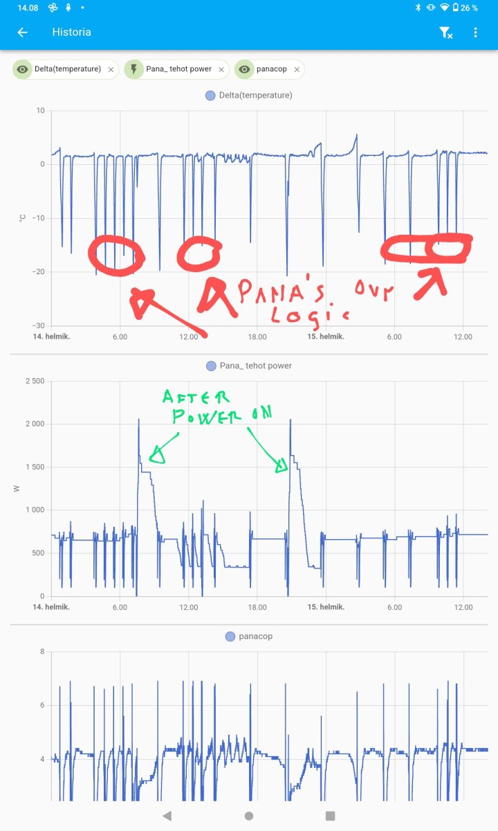

I'm now able to control Pana's defrosting with "Mitsurunner" solution. Below are some charts comparing the operation with/without Mitsurunner. It shows that Pana's own logic keeps heating periods too short.

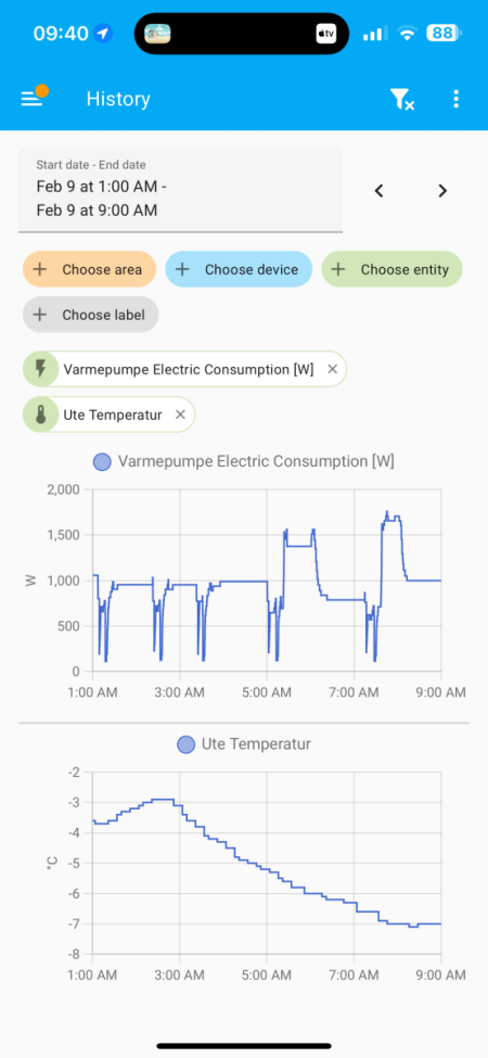

Think I will have to look at doing something like this. It varies between 1-2 hours between defrosts when it's -10 and there is absolutely no reason for a defrost. Yesterday afternoon it kept going for 3 hours, but the cell was clean when a defrost was initiated and no water dripping during the defrost.
This night it has varied in both runtime and power. And when defrosting this morning, the cell is clean and no water dripping.
Might be I've had too high expectations, hoping technology actually improved and manual tinkering with a brand new pump would be unnecessary…

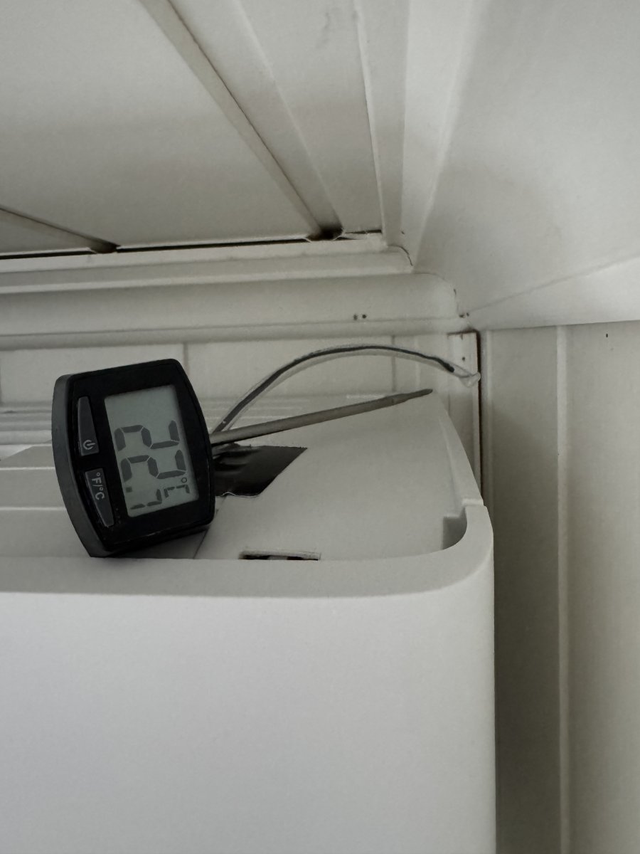

Weird thing that happened. Decided to turn the pump off and on via the switch for 10 minutes to see if it might help with the unnecessary defrosts. Seemed to work OK after starting it, but then the inside temp sensor started to show values way off.
Measured with a temp sensor, it showed 22.7 while the pump showed 19 degrees then worked its way up to 25 degrees, without any change to the «manual» temp sensor...pulled out another temp sensor, just to verify, same values as the Weber one, inside sensor showed way off…

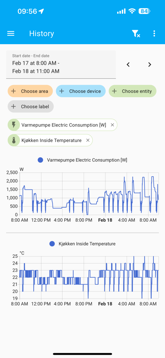

Does anyone have the 12 model? I have a HZ25ZKE today, but it looks like they might pick it down as there are never ending issues with it since it was installed in December and they don't have any solution to my problems.
E.g. Tonight it didn't ramp up, just stayed at 1200-1500W even though the internal temp reported by the pump was 3 degrees off causing the house to cool down instead of keeping it warm. Increasing the setpoint to 24 in the morning caused it to suddenly go to 2000W.
Curious on if one should go for the 09 or the 12, 12 has a bigger outdoor unit which could potentially provide better efficiency?
Have there been any issues with it?
Edit: I see my post was moved from the Fujitsu thread. The «09» and «12» are the Fujitsu/general models that I am now looking at, and I’m curious if anyone (weird to ask this in the Panasonic part of the forum) have any experiences with the Fujitsu models I mentioned above?
Mitsurunnerilla terästettyä HZ25:ta on nyt testattu lämpötila-alueella -15...+3 C, tarpeettomat sulatukset ovat jääneet pois ja toiminta vaikuttaa luotettavalta. Koska turhat sulatukset jäävät pois myös sulatuksen jälkeen tulevat teho-boostit harvenevat eikä pumppu mene niin helposti katkolle (tällä on merkitystä kun lämmitystarve on pieni = ulkoillma nollan paikkeilla).
Tämän hetken kokemuksen perusteella sanoisin että HZ25:n oma kennoanturi on sijoitettu kennostossa kohtaan joka huuruu ensimmäisenä. Sulatusongelmat saattaisivat korjaantua siirtämällä kennoanturi parempaan paikkaan.
Alla kuvaa toiminnasta parin viikon ajalta. Suuri osa sulatuksista on tapahtunut Mitsurunneri säälisulatuksina (sulatusraja 180min). Kuvan vihreällä merkityllä aikajaksolla Mitsurunner oli pois käytöstä, punaisella sää oli sellainen että kenno meni nopeasti aivan tukkoon ja sulatukset olivat tarpeellisia.

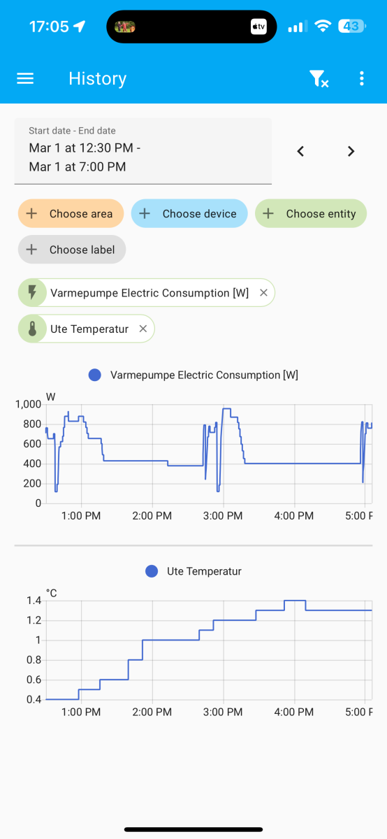

Small update from your neighbour.
Got a new outside device on Thursday, of course there is no hard frosts forecasted. -3 to + 3 degrees since it was swapped.
When the device is deicing now, there is always a need for it, so seems there are no unnecessary defrosts yet.
Interesting to see how it will work when it’s -7 to -15 and the cell usually was clean when it went into defrost.

I'm working on that issue, my test environment now: The indoor air sensor is located at floor level in the corner of room (the temperature there is a couple of degrees lower). When the demand is 17.5 degrees, room temperature is about 20 C and input power on level 215W.
Have to think how to continue...
In a German forum I read that one user changed setting 58 to 3, this gave him the opportunity to set the temp at 17.5 and have 20.5 as an effective setpoint which worked for him. Unfortunate I have to have my setpoint at 22-23, so this will not work for me, but you could try.
    103,7 KB · Lukukerrat: 116
Thanks for the tip, it helps:sormet: Based on my analysis also you could use this method.
Now I have setting 58 offset 1 °C and the demand-setpoint is 16 °C.
==> room temperature is 20.5 °C. Minimum input power is about 210W.
Pana 's temperature sensor is located on the wall about 1 meter below the indoor unit, where the temperature is about 19.5 °C. (= 1°C less than room temperature)
The Pana's own sensor shows 18 °C (= 1.5 °C less than the actual temperature).
Having demand-setpoint 17.5 °C room temperature would be 22 °C, and with setting 58 3 °C offset room temperature would be 24 °C.
So if the Pana temperature sensor can be moved further away from the indoor unit, it is possible to keep a room temperature of 24 °C when demand setpoint in 17.5 °C.
Today our house has been quite cold (about 20degC) and there has been real need for heating, but Pana has driven itself into fast on-off cycle, because of rage of too high start power. Demand was 20.5degC.
I tried 17.5degC setpoint, if it would help into the rage, but it did not. Same on-off cycle continued.
Interesting tip that 58 and +3. I will try if I sometimes can get into service mode. It has not been possible to enter that for some strange reason.
BTW NZ goes below 17.5 setpoint also (in case if it is minimum with HZ)
