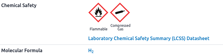

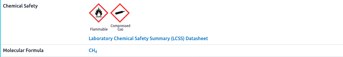

Hieman tutkailin asiaa ja... ja amatöörin nopealla tulkinalla H2 ja CH4 voisi olla se ongelmallinen juttu. Edit: ja jatkotulkinta on että lämpötilaanturilla voidaan katkaista akkujen lataus. Ainakin Victronissa pitäisi onnistua. Tästä eräs jäsen taisikin mainita.
The failure and fires have increasingly become puzzles that may not be ignored for Li-ion batteries (LIBs). Overcharging is notoriously difficult to detect in the early stage. To address this problem, eight types of commercial LiFePO4 batteries are used to evaluate overcharge-thermal runaway (TR) properties in a sealed chamber, including surface temperature, voltage, pressure, and vent gas. And a gas-based fault diagnosis method is proposed based on the gas results. The results show that the Tmax and Pmax of the cells are between 121–150 °C and 132–144 kPa except for the battery type 3. The primary gases measured by the gas chromatograph are CO, H2, CO2, and alkanes, and the total amount of gases ranges from 12 to 45 mmol. Moreover, the proportions of H2 and CO2 both exceeded 30 %. Furthermore, the overcharge-warning experiment showed that H2 was outperformed by CO and CH4, and the capture time was 271 s and 579 s earlier than smoke and TR. Once the gases are detected, TR may be completely suppressed, and the battery neither smokes nor fires. The gas-based TR method is significantly superior to the traditional method in terms of reliability and rapidity. This study can provide a reference for the fault diagnosis of LIBs.
Lähde: Gas production for commercial LiFePO4 batteries during overcharge-thermal runaway

"Comprehensive analysis of gas production.." -tutkielmaa tuskin oli tehty normaalitilanetta silmällä pitäen.
"Furthermore, the overcharge-warning experiment showed that H2 was outperformed by CO and CH4, and the capture time was 271 s and 579 s earlier than smoke and TR."

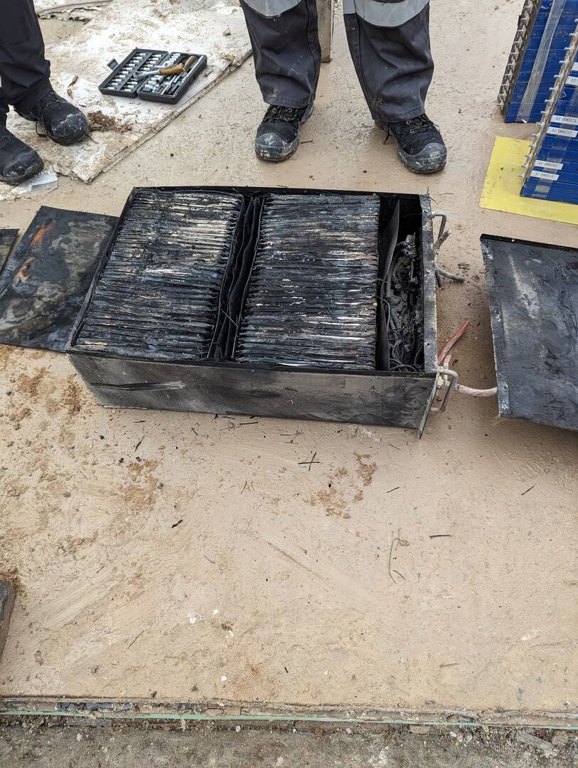

Muistaako kukaan vuosi-pari sitten tapahtunutta lifepo4 akkujen räjähtämistä muistaakseni Saksassa? En nyt pikaisella haulla löytänyt tuota artikkelia, mutta selvisikö siitä tapauksesta koskaan syytä miksi räjähdys tapahtui? Itsekin olen siinä käsityksessä, että paloturvallisuudeltaan lifepo4 akut ovat kohtuu turvallisia, mutta onko tuo räjähdysvaara todellinen uhka?
Kyseessä vissiin tämä juttu? Ei en ole kuullut jatkoa että selvisikö koskaan
https://lampopumput.info/foorumi/threads/akkupalot.32820/post-604325
Edit: muisti palailee pätkittäin… yksi skenaario on että tuhoutuneessa akussa käytettiin pussi-kennoja, joita enää ei pitäisi olla uusissa ratkaisuissa kun ne havaittiin kokonaisuutena huonoiksi ratkaisuiksi. Räjähtäneessä akussa oli 64 kennoa 16s4p = 64x 50Ah =10kWh BMS ei valvo kaikkia kennoja, vaan jokaista 4S pakettia mikä ei ole hyvä. Jokainen kenno pitää olla itsenäisesti valvottu niin se lisää turvallisuutta.
Kuvassa 64 kennon akku joka räjähti. Oikealla on toisen akun prismatic kennot joissa ei havaittu ongelmia.
Näytä liitetiedosto 100508
Tämä juttu se oli mitä muistelin. Jos syynä tosiaan oli pussikennot niin tämä on hyvä esimerkki, että ehkä niitä halvimpia Kiinassa kasattuja valmisakkuja ei kannata ostaa. Vaikka noita ei pitäisi enää olla niin en silti yllättyisi vaikka jossain tulisi vastaan. Monet akkujen käyttäjistä ja varmaan myös vakuutusyhtiö karttaa itse kasattuja akkuja, mutta monessa tapauksessa itse kasaamalla laadukkaista osista saattaisi saada näitä halvimpia Kiinan akkuja turvallisemman akun.
