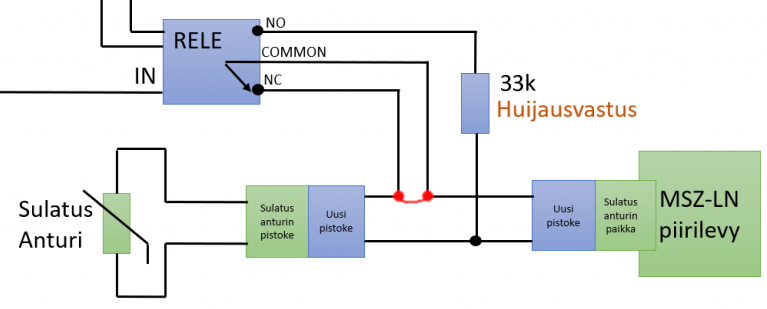

Laita rele pohjavastuksen jännitesyöttöpiuhaan, ja rele kytkemään kun ulkolämpötila alle -2C ja COP < 0. Tuota ehtoa käytän omassa FD:ssä. (COPin tilalla voisi olla myös esim deltaT).
Itse itseäni korjaten... tarkistin koodista pohjavastuksen päälläoloehdot minulla: ulkolämpötila alle -4C ja COP < 1.
Ja jännitesöttöpiuha releen lepokärkeen (jos ohjaus katoaa niin pohjavastus toimii pumpun ohjaamana).

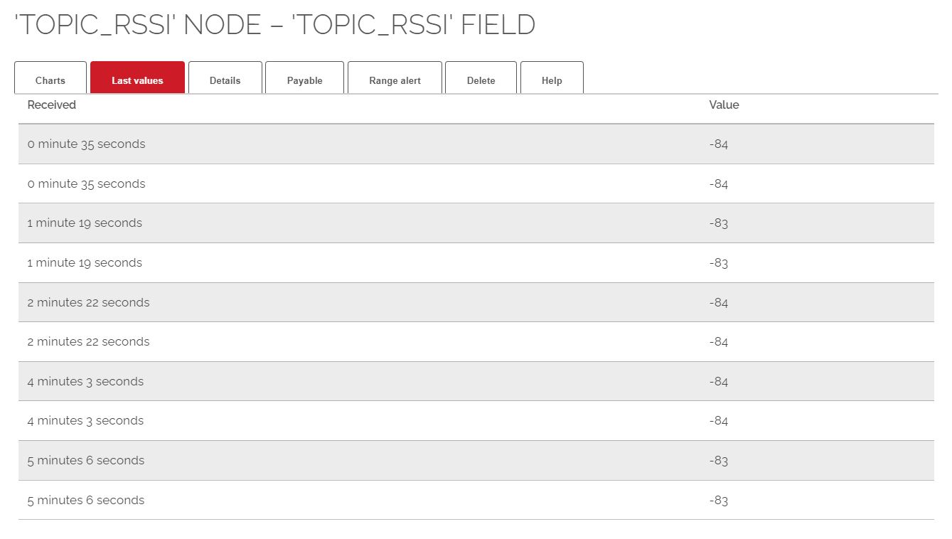

Thanks for the WIFI RSSI option. Was needing it so much and also found the solution, for my instable mitusunner for one of the two heatpumps.
Wifi Signal is just too weak, even if the unit is just 5 metres away from the AP, RSSI -84db, that can't work stable for a long time.
Now it is about to fix the things, either with an extrenal antenna, putting the box out of the Mitsu-Unit (not my favorite) or add an ESP32 with external antenna (WEMOS D1 Pro). Have already one here, but soldering the small "connector" from internal to external antenna makes me crazy, due to missing heat-gun. Maybe after a beer I will have a calm hand for it.

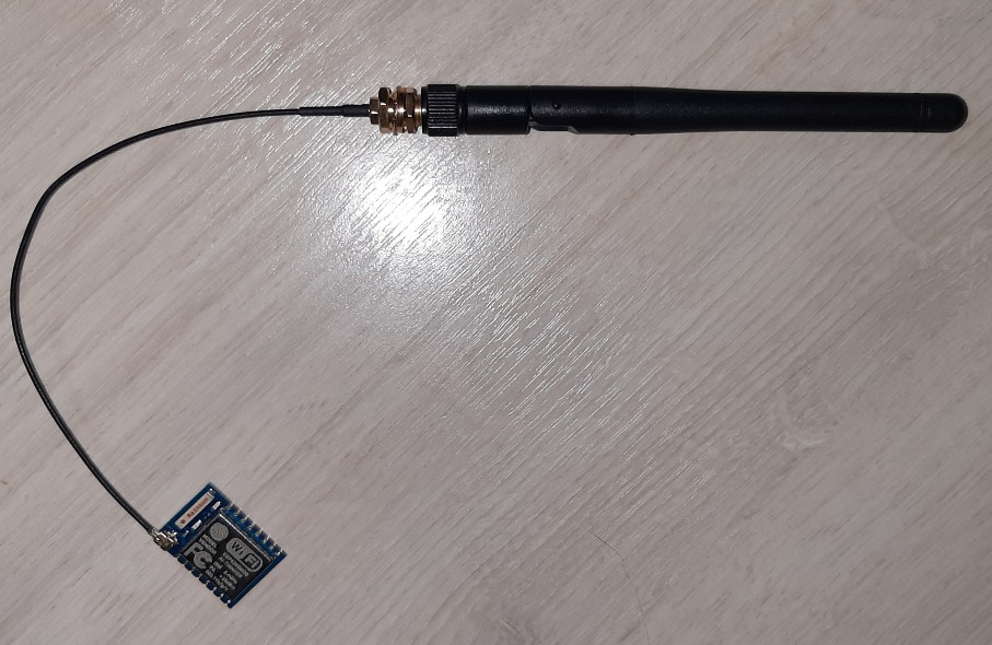

Do not make you grazy by trying to solder connectors... Purchase this kind of adapter cable, which you can just plug to Antenna connector of your Wemos D1 Pro (I have ESP8266 in my example pictures, but Wemos have the same connector) and connect it to external antenna.
So, you don't have to solder like in this video, to activate the antenna-connector-port?
@CheatTheMi , nice to hear that rssi-monitorig helps you to analyze problem.
Based on my experience, -85 dB would still be acceptable in an open environment, but inside Mitsu box there is interference making wifi communication unstable. Let's hope antenna helps.
On Wemos board you have to select (by soldering tiny 0-ohm resistor) if either internal or external antenna is used.

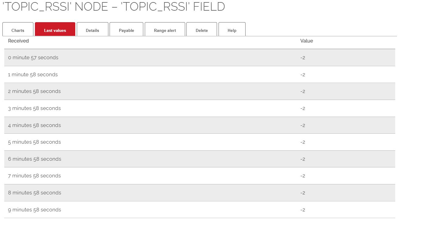

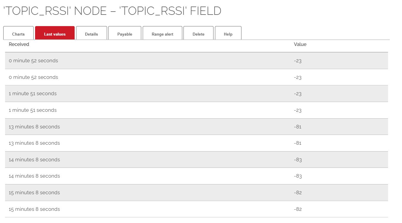

I now chose another solution for the WiFi Problem.
I am having the Mitsurunner in the Case and additionaly the relay, to select defrosting to 5°C or 10°C, if the cell is completely frozen. So, two devices, which need proper WiFi and always lost connection.
For that reason, I installed in the Mitsubishi-Case a small Mikrotik MapLite Access Point for WiFi and as you can see, now I am having a perfect connection. That small AP just cost about 30€, almost the same, like soldering / connecting antennas etc. for two devices.
-83db before, after -23db ; placed the AP much more behind the black transformer.

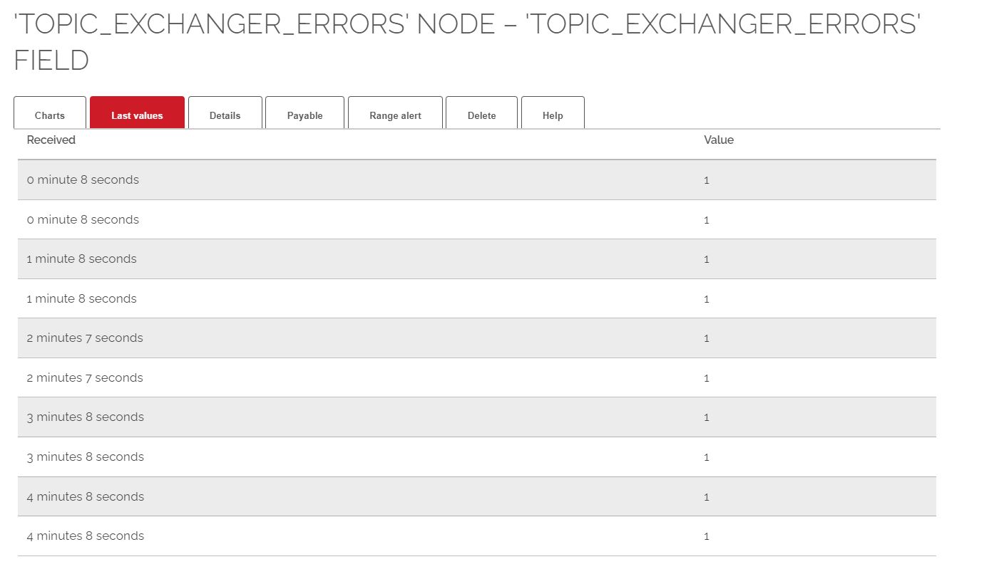

Now I got some exchanger-errors, hope this information helps you?
    59,6 KB · Lukukerrat: 169
    79,6 KB · Lukukerrat: 181
    81,9 KB · Lukukerrat: 167
    77,3 KB · Lukukerrat: 173
    104,6 KB · Lukukerrat: 159
Reaktiot: iro
Seems to be OK. Random Dallas reading errors may occur, but they do not cause problems because Mitsurunner knows how to filter them out.

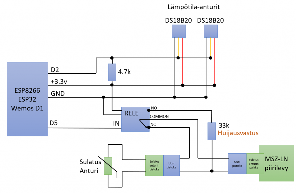

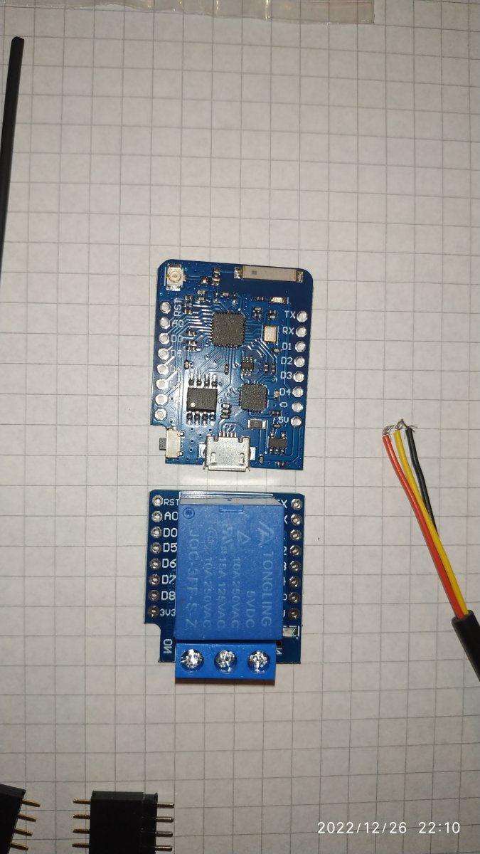

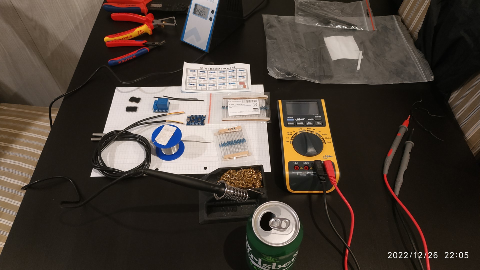

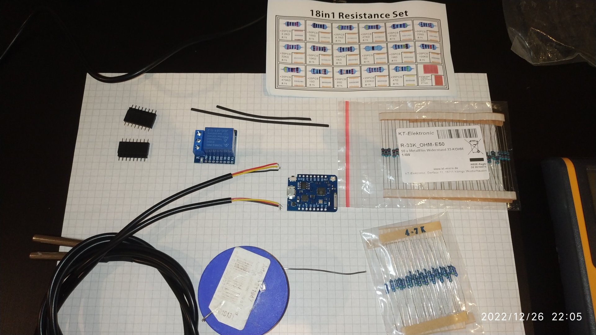

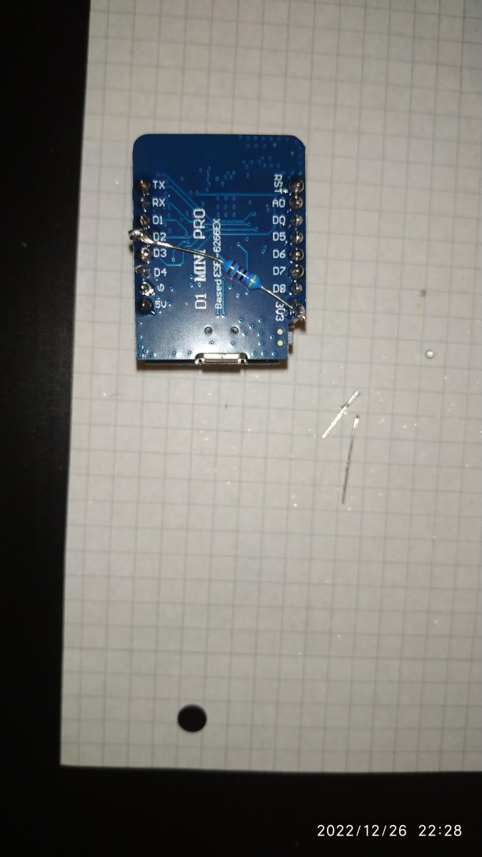

Because I am still at home with this shitty COVID-Infection, I decided to solder another Mitsurunner and add some explanations and detailed pictures, to real noobies. On reading the wiring diagram at the first time, I also had some questionmarks in my head, even if it is super simple.
So, here we go:
Picture 1 & 2:
Here is everything, we could need.
- Different pliers
- Soldering station / soldering iron
- Solder
- 4.7k resistance
- Wemos D1 Mini
- Wemos Relais
- Connecting pins (normally delievered with the WEMOS)
- 2x DS18B20
- Ideally heat shrink tube in different sizes
- Something to drink

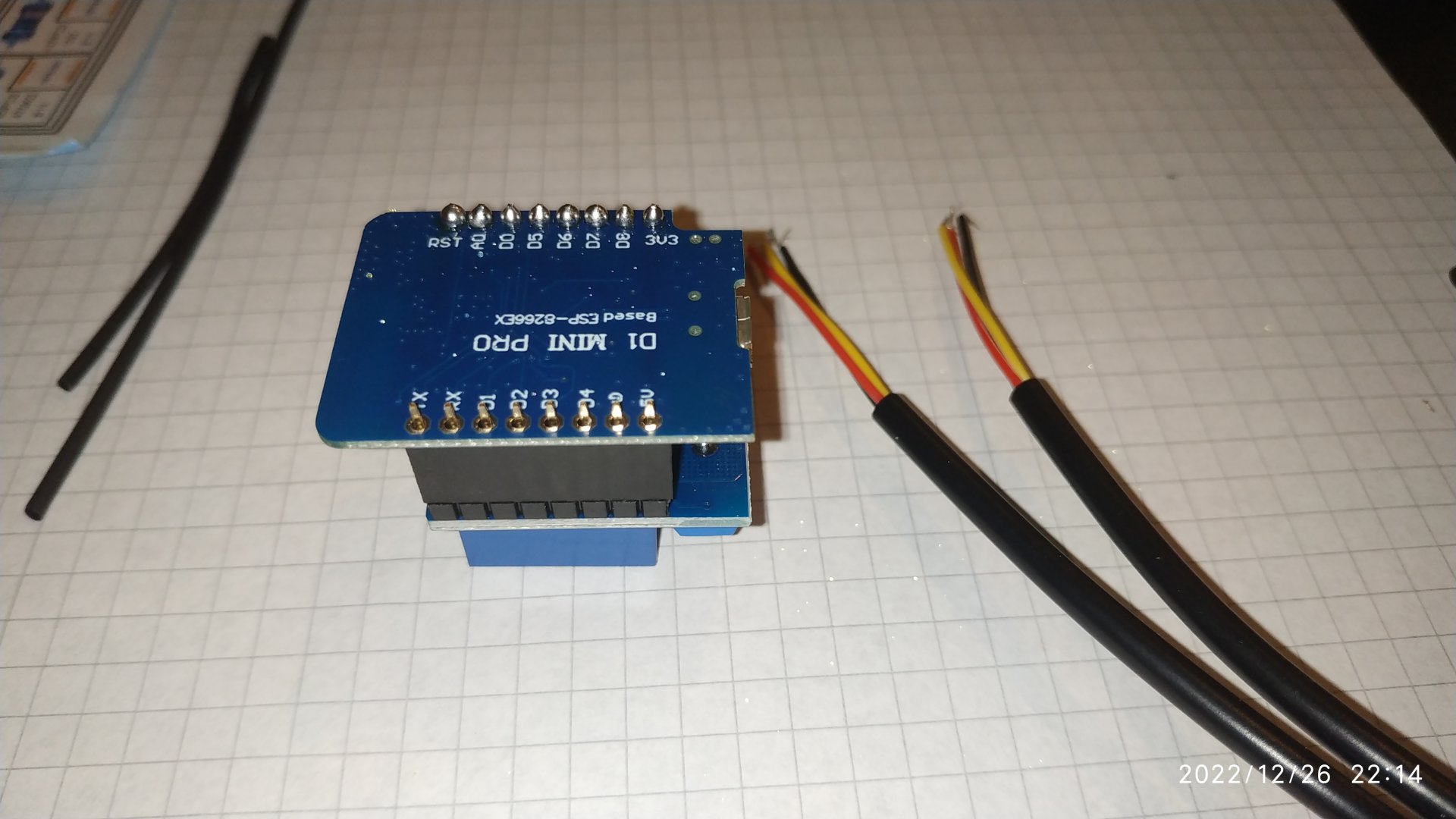

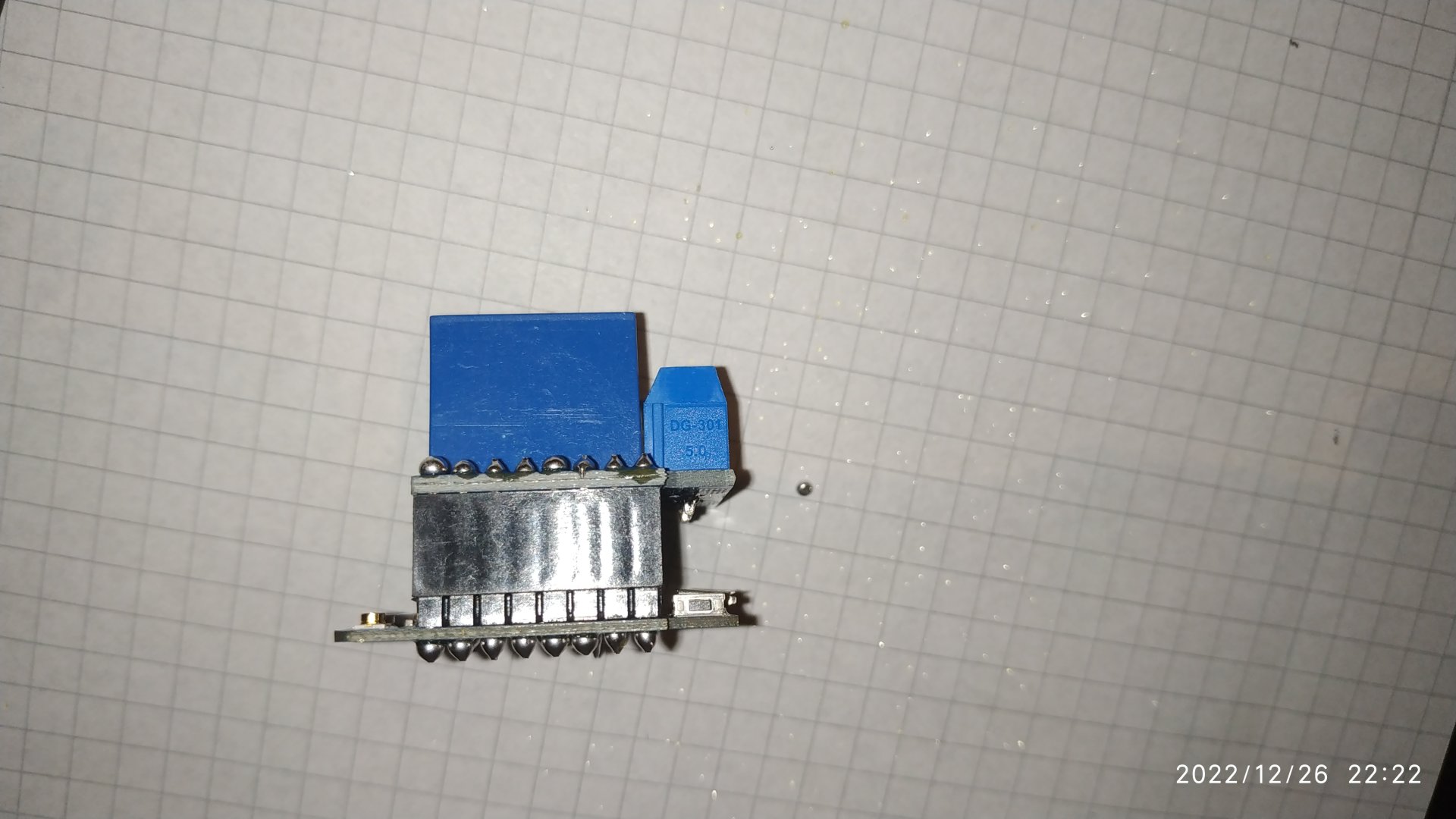

Picture 3:
Connect the connecting pins as shown with each other, you need to press a little bit, to connect them completely!
Picture 4:

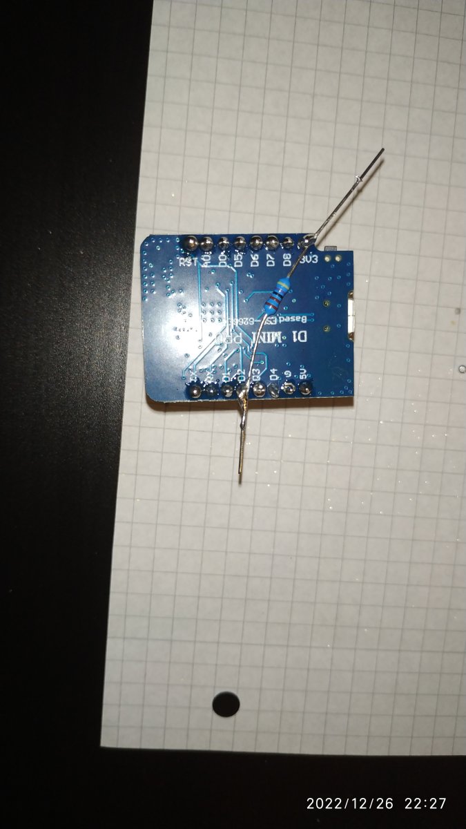

Just check your Wemos D1 Mini (or pro, doesn't matter) and the relais properly. Just in ONE specific position, the contacts fit together. For example: TX to TX, RX to TX, D1 to D1, D2 to D2, GND to GND (or G), 3V3 to 3V3. Just already check now, and remind, that you need to solder it together in such a way, that there are NO mixed connections (for example RST to TX etc.. That will NOT work and may damage the board!
Picture 5, Picture 6:

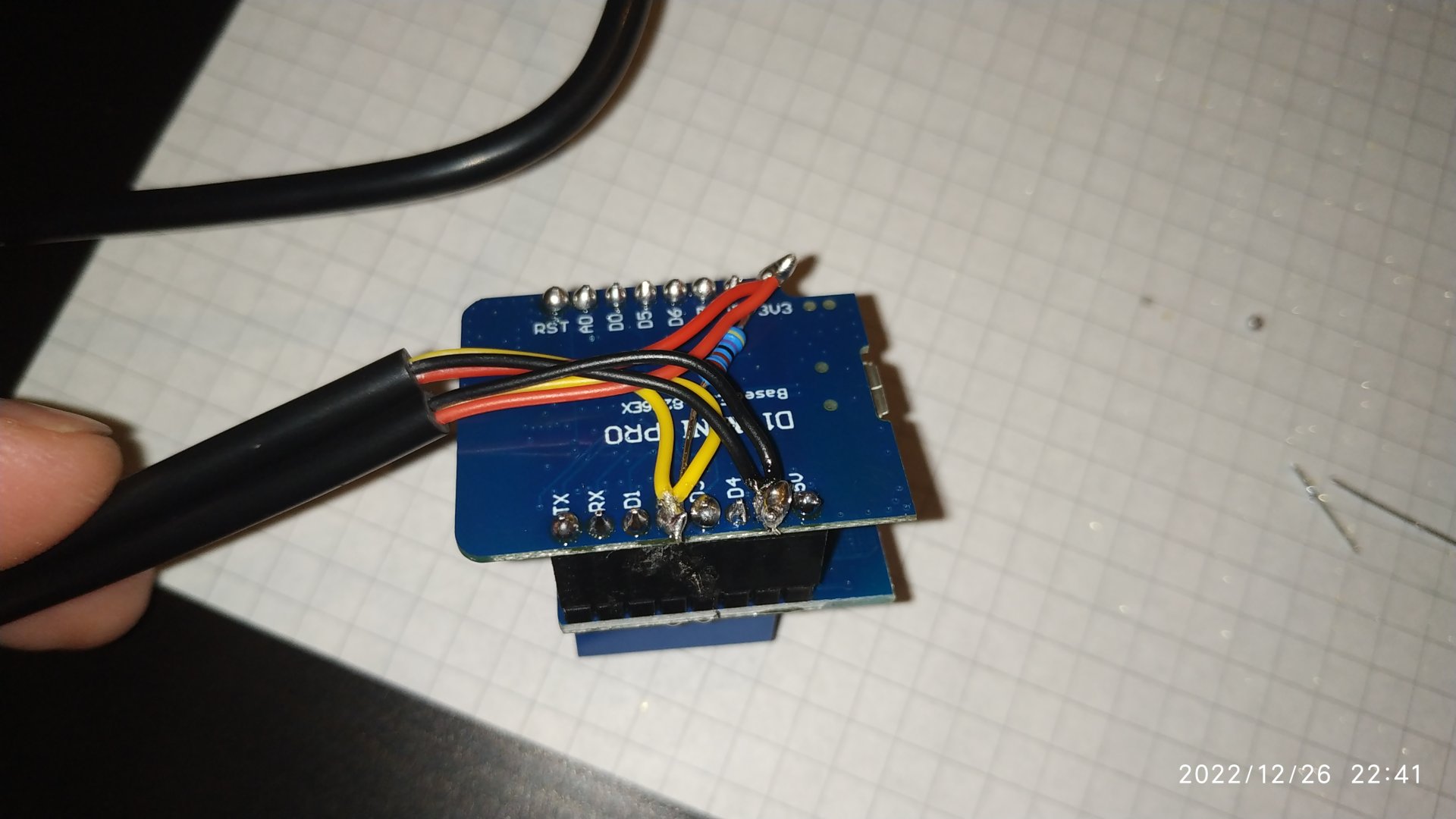

Start soldering. If you never did on such small devices, look for an old defective radio, television, whatever and make there some trials at first. Solder point by point and ensure by 100%, that there are NO connections between the neighbored things (for example, that D1 and D2 are NOT connected by mistake, by using too much solder). A good temperature for doing it, is around 290°C (depending on your solder).
Picture 7:

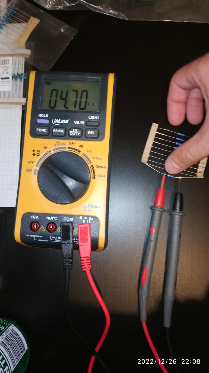

All done? Good boy! Next, take your resistance and / or if you are not sure, check the resistance with a multimeter as shown. Set it to the resistance mode, connect the cable properly and measure between and after the resistance. If it shows 4.7k, perfect. Even 4.67k or 4.73k is okay, there is always a small difference for measuring and tolerance. Just ensure always, that it is 4.7k in the end (4700 Ohm).
You also can read the resistance by the colored rings on the resistor, just google for it, how the colored rings are counted.
Picture8 and Picture 9:
As shown in the wiring diagram, now solder the 4.7k resistor between D2 and 3.3V, at the end, shorten the wire with the pliers.
I have seen here in this board several versions, where it was (by my wemos-layout) soldered between 3.3V and D7, so I was a bit confusing, why it looked so different.
The truth is, there are different layouts of this board and you can solder this connector also between other 3.3v and D connectors, just DON'T use connector DX DX (the pro's, please help me with the numbers, which D connectors weren't possible, I will edit this post!).
!!!The only important thing is, to remember to which D connector you soldered this resistance, you need to edit this one later in the mitsurunner software, otherwise it is NOT going to work!!! Remember AND make a note for yourself!!!
D2 and 3.3V is always a good choice!

Here we proceed, not more than 10 attachments:
Picture10:
If not already happened, remove a bit of the cable-insulation of the DS18B20 Sensors (5-10mm is enough). Black with black, yellow with yellow, red with red, doesn't need to be 100%, just drill it a bit together with your fingers.
Picture 11:
Solder the cables in the following way to the WEMOS. There are different options, move around and turn around your WEMOS and check, which option is the most beautiful for you and which one is avoiding most, to have pressure on the cables. You also can solder it on the relais-side (opposite side, I used), if it is for your layout the more beautiful version.
- Yellow to D2 (or to the different D connector you chose, like mentioned in Picture8 and Picture9)
- Black to GND
- Red to 3.3V
SOLDERING DONE!
FAQ:
Q1. Okay, now I soldered it all together. But in the wiring diagram there is another connection between the 4.7k resistance and the relais, another one between GND and the relais and another one between D5 and IN. How do I connect it?
A1: You DON'T connect it. In step 5 and 6, by using this pin-bridge, you connected the contacts between all the mentioned points, you are asking for. So, here you DON'T need any additional connectors, cables, whatever.
Q2: I drilled the cables of the DSB1820 temperature-sensors together, now Sensor1 and Sensor2 are connected, it makes no sense, they will give the same information and short circuit?
A2: NO, the sensors need GND and 3.3V for voltage, communication is made by the yellow cord. Each sensor has its own, unique identification number and will communicate the temperature AND the identification number to the WEMOS, so the information will not be mixed, even if you solder 1000 temperature sensors to the WEMOS.
Q3: Well, the WEMOS is connected by USB to a power device, the relais doesn't have a USB connector. And now?
A3: As mentioned in Q1, by the pin-bridges, the relay getting its power from the WEMOS D1 mini. So, no need for additional power supply.
Q4: Which USB charger should I use for my WEMOS?
A4: You can use any USB charger, with a micro USB. I would just recommend to check, that it delievers 5V and at least 1.5A. My WEMOS had a bad WIFI reception and used in this time in total 2.5W of power (=0.5A), but I would not try, to dimension it so weak. The relay needs to energize sufficient, otherweise it can end in a relais flickering (sounds like a rattle snake, often the result of too less power).

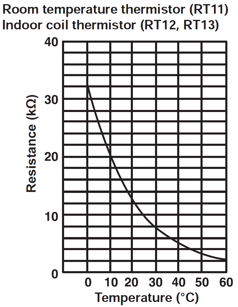

Mikähän liitin tuossa olisi ja mikä anturi?
Eli voisi vain irrottaa laitteen sisäisen anturinpiuhan/liittimen ja asentaa uuden antuein pidemmällå kaapelilla sitten sopivaan paikkaan.
Olisikohan tuo liitin myös tuota TE Connectivityn Crace Intertia sarjaa, esim. tämä: https://www.te.com/usa-en/product-1747066-2.html
Mutta tuohon varman menisi perus dupontit, tuo liitin ei varmasti joudu yhtä koville kuin ulkoyksikön anturien liittimet (tärinä yms).
Anturiksi käy varmaan mikä tahansa 10Kohm NTC termistori:

DS18B20 virhesummat:
Mitsurunner on DS18B20 virheiden osalta virhesietoinen, mutta jos virheitä tulee paljon (kymmeniä tunnissa) on syytä tarkistaa DS18B20 antureiden johdotus ja liitännät (laskurit summaavat virheitä jatkuvasti, kun 1000 virhettä on havaittu laskuri saa arvon 10 ja summaus jatkuu tuosta arvosta).

By the way, RSSI level of my Mitsurunner seems to be between -94 and -84 dBm, that is 0,4 - 4,0 picowatts. Anyways I haven't seen any issues caused by this low RSSI levels. OTA works always and data is being logged without noticeable gaps or delays. @CheatTheMi please test this RSSI logging and report what yours look like.

Hey puu,
I added the RSSI logger about a week ago to my both Mitsurunners and it is working super great!
Logging properly, just the temperatures are here, with +15°C much too warm, to check if it is affecting Mitsurunner. But I don't think, that it will affect in any way.
Anyway I didn't want to risk an unstable connection of my Mitsurunner, my RSSI was always around -80db, so I installed in each outdoor-unit the small Mikrotik AP and since then I am having a perfect WiFi Signal and additionaly around the units also better WiFi for my Phone etc., when you are in the garden / terrace. So it was a win-win situation!
I also thought at first, that the connection issues resulted from my phone charger, but since adding the AP to the outdoor unit, the problems are non existent. So, in my case, it really was for the weak WiFi signal. 30€ each AP, that's money I can afford for stability.
    75,6 KB · Lukukerrat: 165

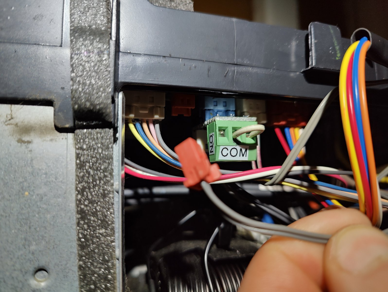

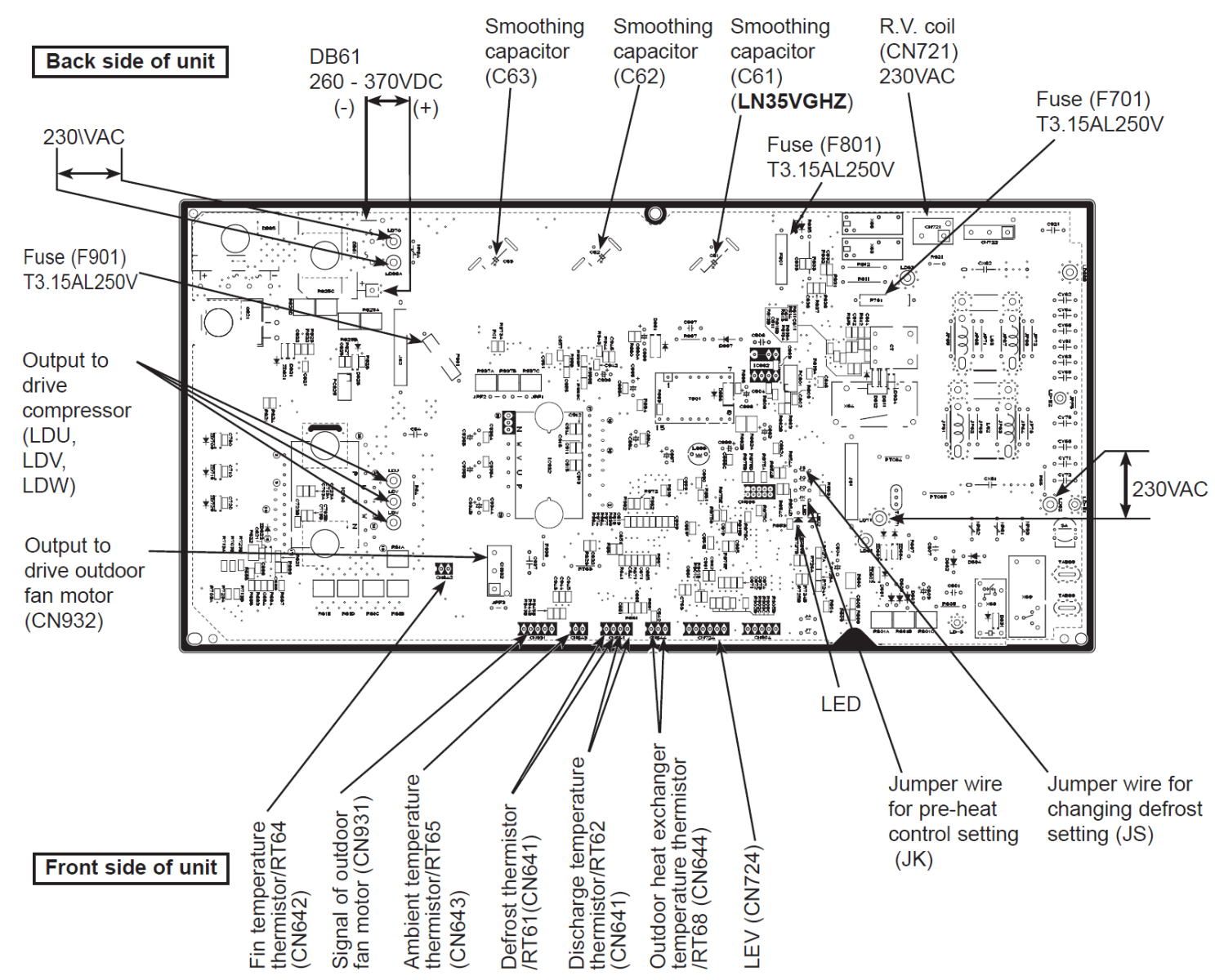

Asensin eilen iltapäivällä @puu :n adapterin. Se on nyt toistaiseksi pelkän hyppylangan kanssa paikallaan. Pumpun toiminta tuntuisi olevan täysin normaalia ja sulatusvälitkin ihan ennallaan...
Wemos D1 mini pitäisi vielä ohjelmoida ja asentaa. Kuinka etäälle pumpusta sen voi sijoittaa ja voiko kaapelina käyttää cat6 verkkokaapelia? Sitä olisi valmiiksi kotona ja kaapelivetoa tulisi noin 3-4 metriä, jos asentaisin mitsurunnerin talon sisälle.
Lisäksi vielä toinen kysymys, onko liitteen kuvassa tuo irrallaan oleva johto pohjan sulanapitovastukselle?
    265,8 KB · Lukukerrat: 212
Reaktiot: puu
Pidemmät johdot --> lämpötila-anatureiden mittaustuloksien virheet lisääntyy, mutta pelaa kyllä. Mulla on nyt noin tuo laite, johto menee ikkunan raosta ulos. Rele, @puu adapteri ja anturit laitteen sisällä.
Ei hajuakaan, mikä johto sulla on irti. Ei tuolla ylempänä näytä tuossa olevan @puu kuvassa tuossa paikassa myöskään mitään.
Hienoa että pelaa!
Tuon sulatushuijausvastuksen kaapelin (adapterilta releelle) pituudella ei pitäisi olla juurikaan väliä, mutta kuten @Velsku sanoi, voi noidin 1-wire dallas -antureihin tulle enemmän lukuvirheitä. Ainakin noilla valmiilla kaapeleilla tuntui tulevan enemmän häiriöitä kun johdoilla alkoi olla pituutta, niissä kun on suojaamattomat kaapelit. Itsetehdyllä suojatulla kaapelilla tuntui toimivan paremmin.
Jos tarkoitat tuota kädessä olevaa johtoa punaisella liittimellä, niin sen pitäisi olla "ambient temperature thermistor / RT65"

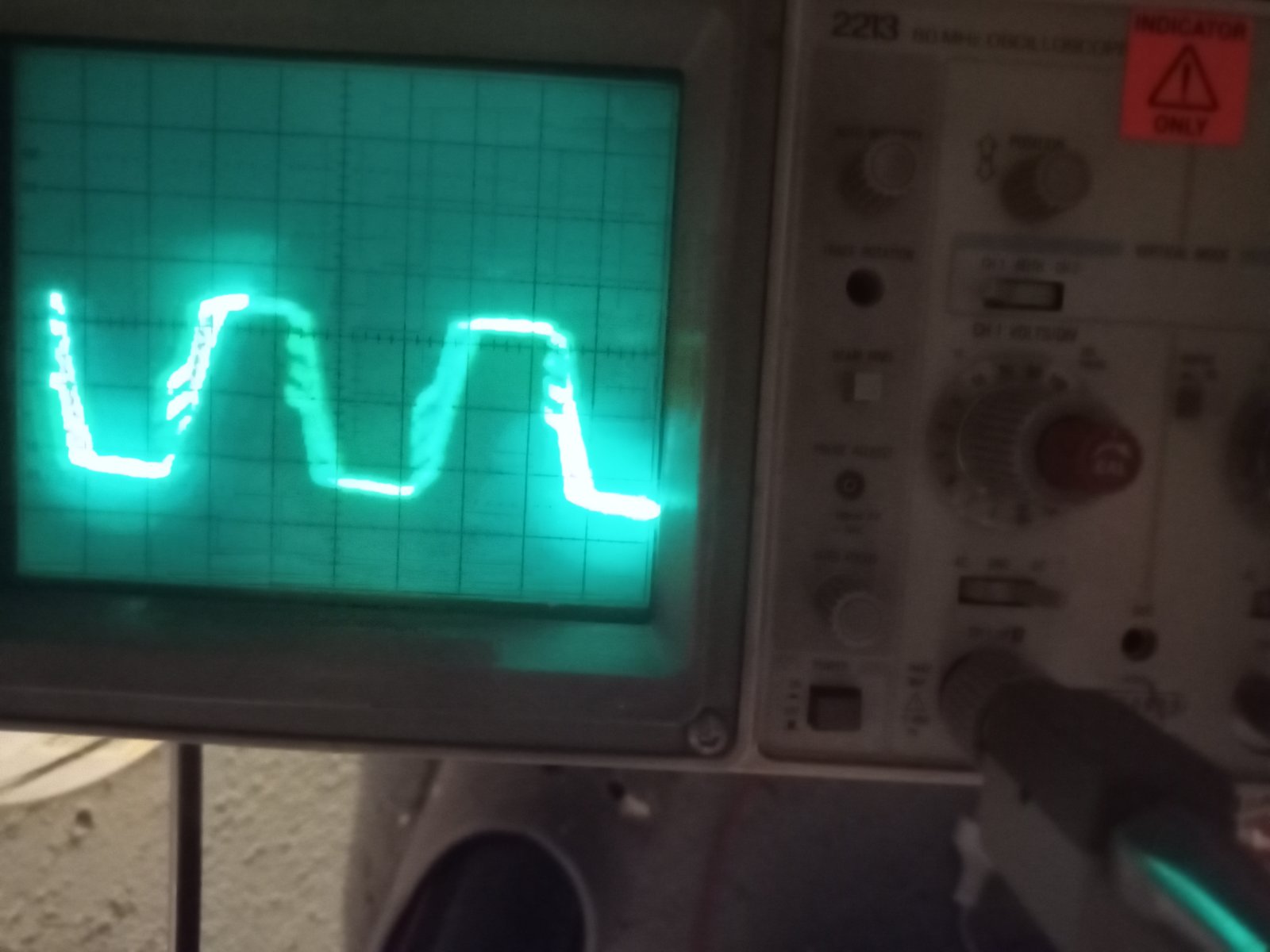

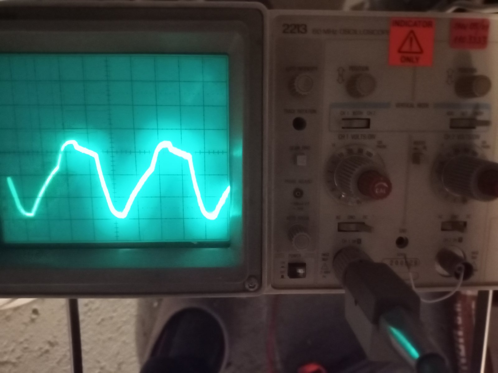

Tutkin joskus oman FD-pumpun NTC-vastuksen jännitettä maapotentiaalin suhteen. NTC-johdossa näkyy 50Hz "toispuolinen" peak-to-peak arvoltaa noin 300V jännite (max 0V, min -300V). Liitteenä skoopin kuvat (asetukset "DC", 100V/ruutu). Mitsun töpselin kääntäminen vaikuttaa hieman aaltomuotoon muttei jännitearvoihin. Tuntematta Mitsun powerin rakennetta en tiedä miten jännite muodostuu ja kuinka paljon virtaa se voi antaa. Voisin arvata että NTC:n jännite ei kellu vapaasti vaan on (suurohmisella) vastuksella (ja diodilla?) kytketty jännitesyöttöön.
USB-adapteriin liitetty Wemos puolestaan kelluu maapotentaalin suhteen, näin myös DS18B20 antureiden johtimet. Minä en laittaisi noita johtimia samaan nippuun jossa heiluu Mitsun NTC:ltä tuleva säröytynyt 300V vaihtojännite.
Kannattaa myös huomioda sähköturvallisuus. Niin kauan kun ei ole varmuutta Mitsun NTC:n johtimien jännitteen vaarattomuudesta, johtimiin ja niiden kytkentöihin pitää suhtautua kuten niissä olisi vaarallinen jännite. Siispä tuon jännitteen tuominen Mitsun suojamaadoitetun kotelon ulkopuolelle tuo sähköturvallisuusmielessä omat haasteensa.
Sekä häiriö- ja sähköturvallisuusongelman voisi ratkaista siirtämällä Mitsurunnerin releen omaan koteloonsa Mitsun suojamaadoitetun kotelon sisälle. Tällöin johdotuksen voisi tehdä turvallisesti ja häiriöttömästi yhdellä cat6-kaapelilla.
