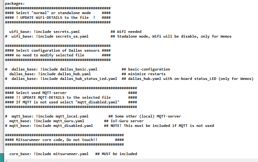

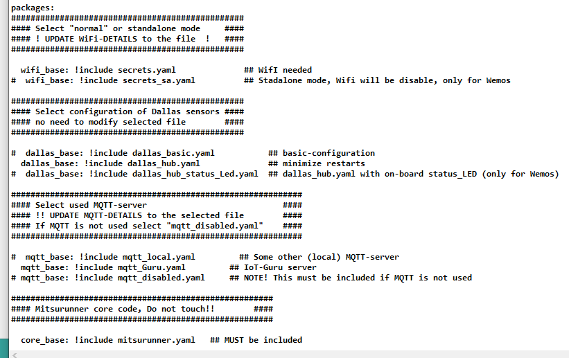

Nice to see some activity here — it's a good time for maintenance work.
A quick confirming question: Did you notice that the Mitsurunner software has a new structure and the compile & build must be done using the mitsu_conf.yaml file?"
EDIT: It looks like "platform_wemos.yaml" is not included into the build.
Thanks for that information, that was the issue.
I was still fixed to the "esphome run mitsurunner.yaml" ; with "esphome mitsu_conf.yaml" it worked smooth so far, I also could remove my mentioned code (esp8266: board: nodemcuv2) and still worked. So, that was my fault!
Only "issue" / information for now is:
"ERROR Found no valid options for upload/logging, please make sure relevant sections (ota, api, mqtt, ...) are in your configuration and/or the device is plugged in."
Edit: Fixing done! If you ONLY use IOTGuru:
In mqtt_Guru.yaml set a # hashtag in line 47, 48, 49, in front.

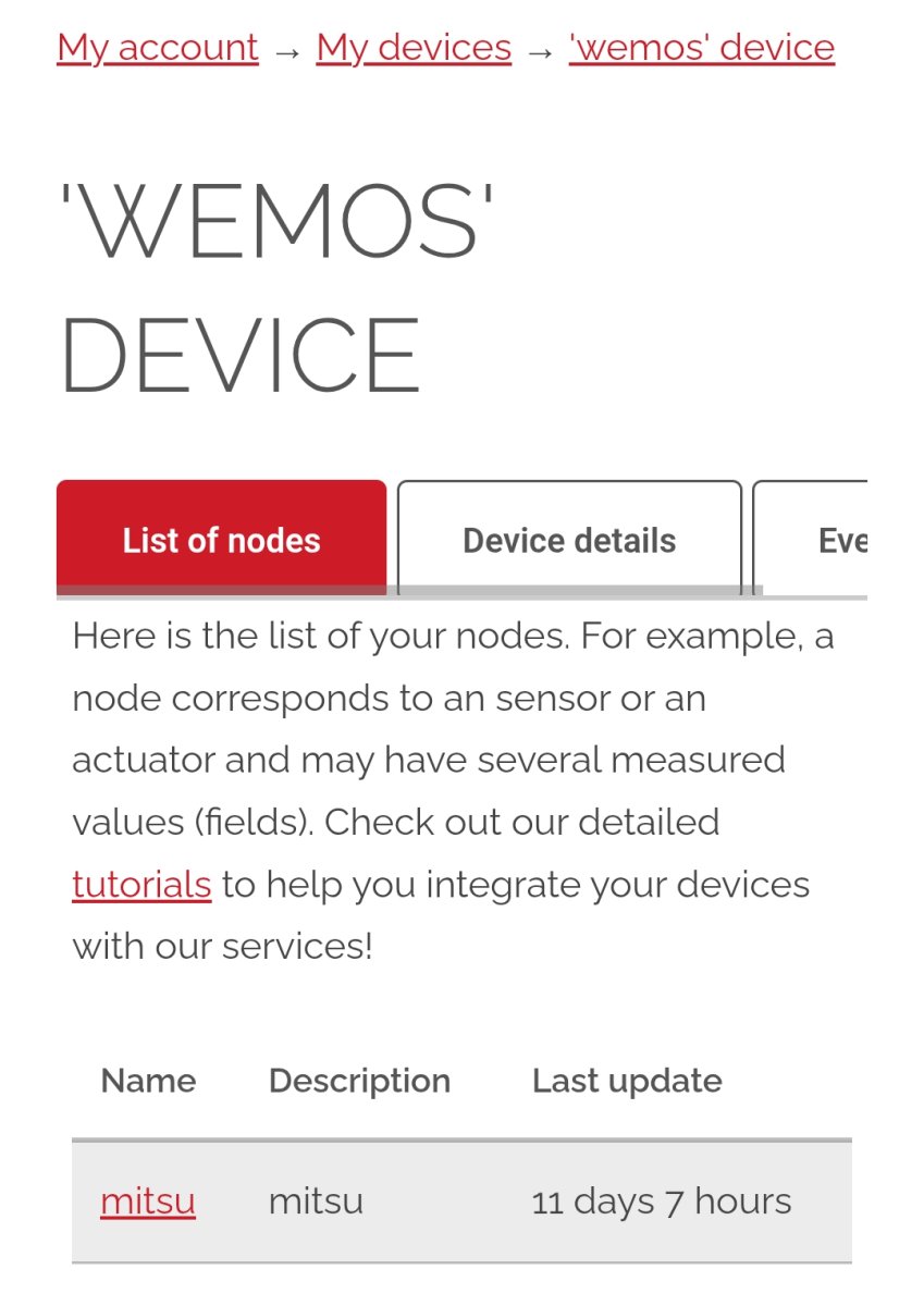

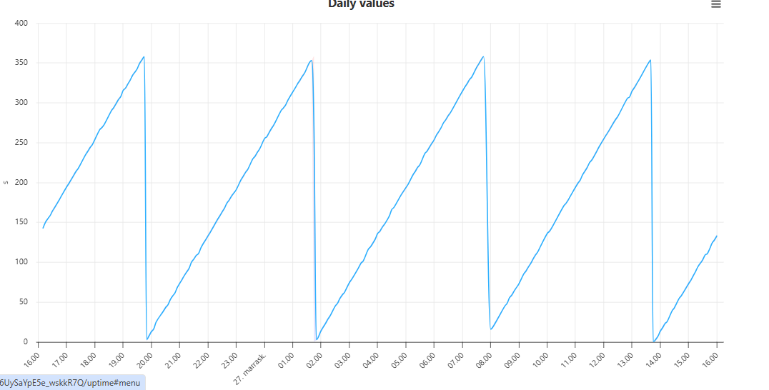

Mikähän mitsurunneriini tuli kun iotguruun ei ole ilmestynyt heinäkuun puolivälin jälkeen mitään... runneri on verkossa ja flashasin sen ota:na uusiksi varulta mutta ei muutosta...? Muilla samoja murheita? Töpseli on ollut satunnaisesti irti mutta aina se on sieltä herännyt henkiin
Mulla katos kans MQTT tiedot iotgurusta ja home assistantista.
13:46:12[D][esp-idf:000][1;31m[mqtt_task][0;36mE (16781998) esp-tls: [sock=49] delayed connect error: Connection reset by peer
13:46:12[D][esp-idf:000][1;31m[mqtt_task][0;36mE (16782014) TRANSPORT_BASE: Failed to open a new connection: 32772
13:46:12[D][esp-idf:000][1;31m[mqtt_task][0;36mE (16782017) MQTT_CLIENT: Error transport connect
13:46:12[E][mqtt.idf:162]MQTT_EVENT_ERROR
13:46:12[E][mqtt.idf:164]Last error code reported from esp-tls: 0x8004
13:46:12[E][mqtt.idf:165]Last tls stack error number: 0x0
13:46:12[E][mqtt.idf:167]Last captured errno : 104 (Connection reset by peer)
13:46:12[W][mqtt:335]MQTT Disconnected: TCP disconnected.
Minulla IoT-Guru näyttäisi toimivan normaalisti (toisessa sovelluksessa kuin Mitsurunner). Pystyykö joku Mitsurunner&IoT-Guru käyttäjä toteamaan että hänellä systeemi pelittää normaalisti.?
Mikä Mitsurunnerin versio sinulla on käytössä? Jos Mitsurunerin web-serveri on käytössä mitä logitietoja siellä näkyy?
Täällä ainakin mitsurunner + IoTGuru toimii normaalisti. Oma asennukseni ja kaikki versiot ovat elokuulta 2024. Onko tarvetta tai mitään syytä päivittää jos kaikki toimii?
No niin tämä selvisi, vanhassa mitsurunnerissa mqtt brokerina on ip-osoite, uudessa iotguru.cloud, lisäsin manual ip-osastoon dns:n ja vaihdoin brokeriksi tuon iotguru.cloudin ja johan ilmestyi arvot intternettiin!
Hyvä että ongelman syy selvisi. Vanhemmissa Mitsurunnerin versioissa käytettiin kiinteää IoT_Gurun ip-osoitetta, ja nyt tuo kiinteä osoite on vaihtunut.
Vanhan version saa toimimaan lisäämällä nykyiseen manual_ip määritykseen dns määrityksen

Oma Sonoff vaikuttaa hyvin vakaalta ja se söi tämän uusimman versionkin mukisematta. Nyt uptimeä vasta tältä päivältä 534 min, mutta aiemmin veteli tosiaan niin pitkiä uptimejä, että se IoT Gurun counteri ehti aina nollaantua, joten en jaksanut edes enää seurata. Dallaksiin taas kertyi jännästi ulkolämpötilan funktiona virheitä rajustikin, muttei ole vaikuttanut toimintaan. Nyt kesäkelillä em. muutaman tunnin uptimen aikana 6 virhettä lämmönvaihtimeen ja 0 outdooriin, aiemmasta viestistäni luntaten "kovemmalla pakkasella ehkä se tuhat kappaletta päivässä-parissa ja nollakelillä samat abaut viikossa".
Kaiken kaikkiaan erinomainen viritys ja ei voi olla kuin kiitollinen. Oon eri projekteissa nähnyt jtn Buy Me a Coffee -palveluita ja itselleni hyödyllisiä projekteja mielelläni tukenutkin, joten tarttettais tohon teidän projektisivun kylkeen sellanen Tarjoa Kaljat -nappi :sille:
Edit: Tuosta fläshäyksestä asti menty samoilla virroilla, eli reilu 11 vrk. Eiköhän tälläkin päästellä taas ainakin juhannukseen saakka.

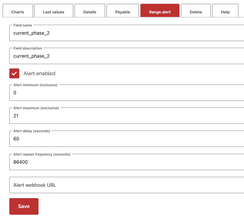

Vinkki Iotgurun käyttäjille: Hälytys sähköpostiin. Huom. nämä hälytykset tieten tulee perille vain jos data kulkee Iotguruun, elikä kaikki toimii normaalisti.
Ei Mitsurunner-esimerkki: Sähkön kulutuksen seuranta - vaiheen kulutus lähentelee maksimia 25A -> hox hox aika tehdä manuaalista kuormanhallintaa.
Kuvassa: Jos arvo on yli 21 niin sähköpostiin tulee hälytys-viesti kerran vuorokaudessa (86 400 sekuntia).

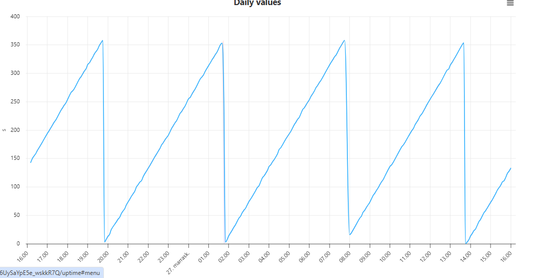

Tollasta uptimea. Wifi-signaali heikko ja yhteys pätkii. Pakkosulatukset 480min välein ja noi bootit sotkee välin kellotuksen. Common reboot time on ton 360min ja aattelin, että jos secrets.yaml tiedostosta kommunikois sen pois. Onko isoa haittaa ja jos on, niin millasta? Käppyröitä tulee lämmityskaudella kateltua päivittäin, niin jos jotain häikkää on, niin varsin pian paljastuis. Harkinnassa hommata Mesh-purkki vahvistamaan wifiä, mutta secretin käpelöiminen houkuttaa edullisuutensa vuoksi.
Näytä liitetiedosto 110235
Ennen kun poistat time-out rebootin selvitetään hieman mikä vahtikoira puraisee.:hmm:
Reboot-timeout vahtii WiFi-yhteyttä sekä MQTT- ja HomeAssistant-yhteyksiä mikäli ne on otettu mukaan Mitsurunner_conf tiedostossa. Jos/kun jakamasi kuvaajan tiedot ovat tulleet WiFi:n kautta WiFi ei aiheuttane reboottia (käsittääksen reboot laukeaa vasta kun WiFi yhteys on ollut yhtäjaksoiseti alkaalla asetetun time-out ajan).
Lähetatkö nyt tiedot IoT-Guru MQTT:lle vai HomeAssistantille ?
* jos MQTT:lle niin HA-base: !include homeassistant.yaml rivi pitää kommentoida pois mitsu_conf.yaml tiedostosta,
* jos HomeAssitantille niin mqtt_base: !include mqtt_disabled.yaml rivi pitää valita mitsu_conf.yaml tiedoston MQTT-osoista.
Sä oot nopee :)
Some other (local) liene viittaa siihen, jos esim. HA:lle lähtee tiedot, kun ei ole tuota mainitsemaasi HA base....
platform_wemos tiedostossa on:
# Enable/disabe HomeAssistant
api: # !! If home Assistant in use remove comment (#)
Onko tää syyllinen, kun ko. runnerista ei lähetetä tietoa HA:lle (runner on toisaalla, ei mun torpassa)
Sä oot nopee :)
Näytä liitetiedosto 110236
Olinkin toteuttanut tuon toisin kuin muistin. Eli HomeAssistant API käyttö määritellään platform_wemos.yaml tiedostossa. Jos APIa ei käytetä allaoalevat rivit täytyy olla kommentoitu pois käytöstä.
Koodi:
# api:                                       # !! If Home Assistant API is not used delete this line
#   reboot_timeout: 0s                       # !! If Home Assistant API is not used delete this line
Huomasin myös että ohjeistus (myös Mitsurunner Wikissä) on harhaanjohtava, puhutaan HomeAssistantista kun pitäisi puhua HomeAssistant APIsta. Jos käyttää HomeAssistanttia MQTT:n kautta Mitsurunnerissa konfiguroidaan vain MQTT-käyttö.
Jos haluaa priorisoida Mitsurunnerin toimintaa (raportoinnin suhteen) voi platform_wemos.yaml tiedostossa laitaa time-out aikaa pidemmäksi (esim 600min).
Koodi:
substitutions:
# Common reboot timeout for WiFi, MQTT and HomeAssiant. Change value if needed.
  common_reboot_timeout: '360min'
