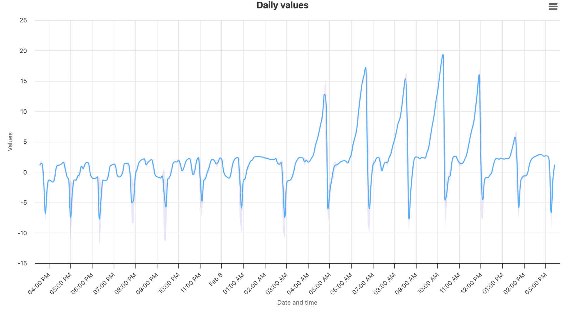

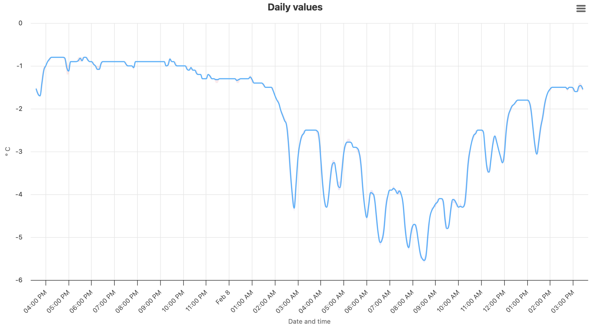

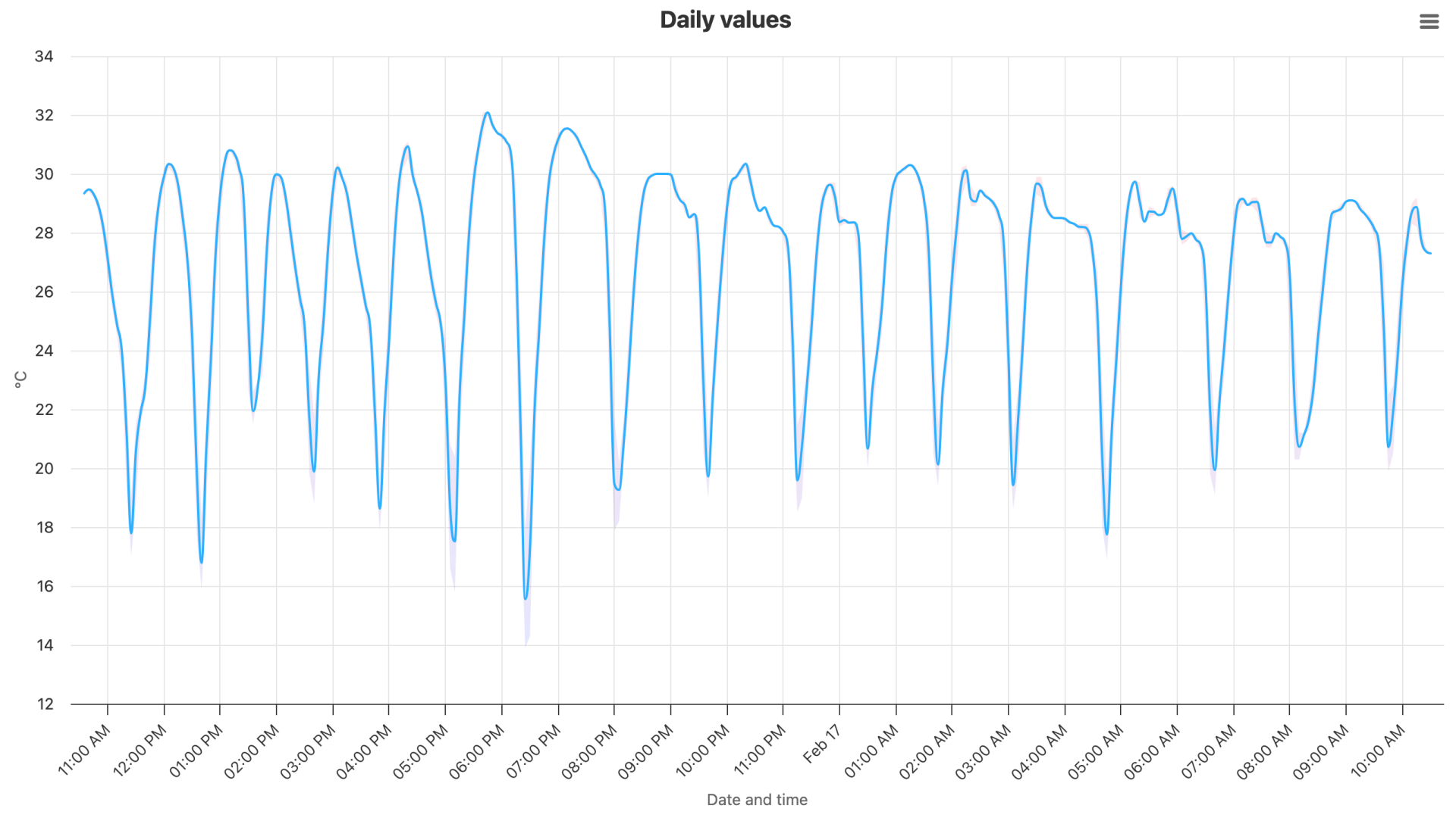

Hi there,

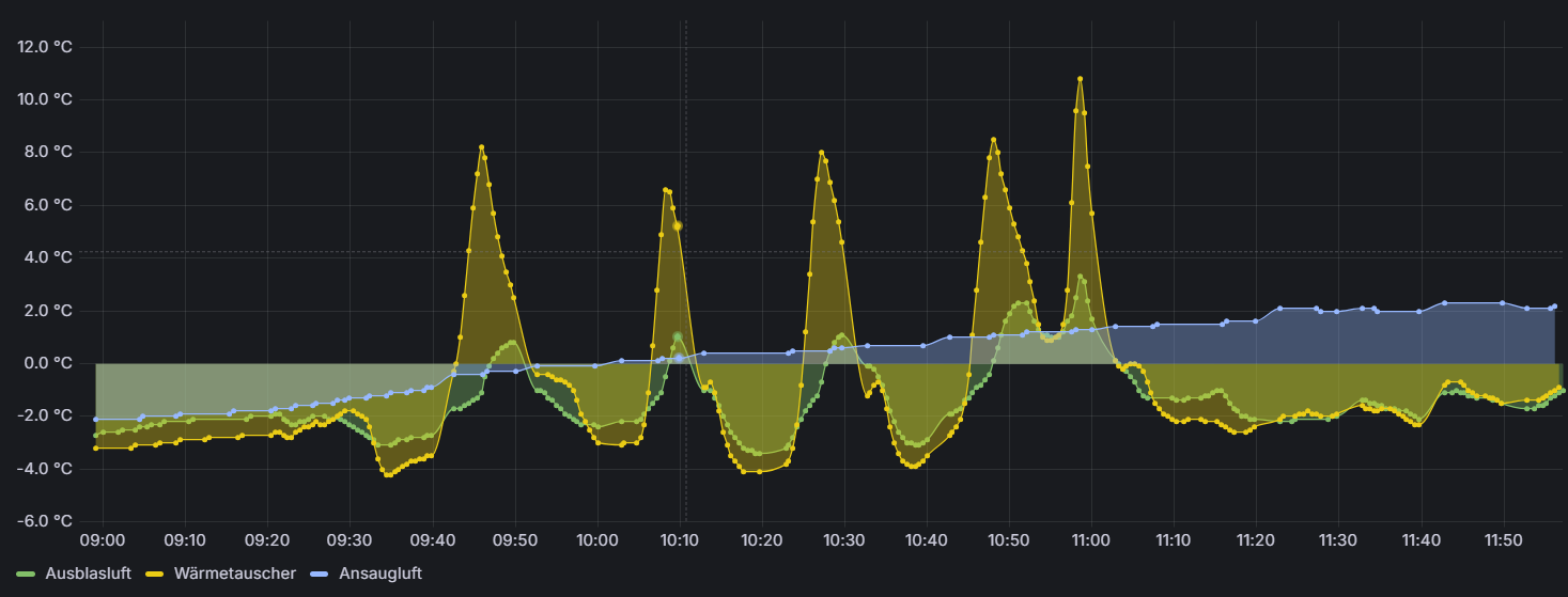

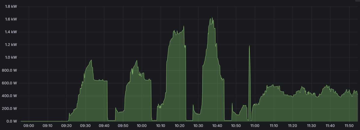

I've installed Mitsurunner on a MXZ-2F42VF3 multisplit in southern Germany. Outdoor temp is mostly around 0°C.
Mitusurunner's prevention of frequent defrost cycles works very effective.
But it seems, that faking the outdoor air thermistor interferes with the logic of Mitsubishi's power control:
With Mitsurunner active the compressor Ramps up quickly to very high power, the room temperature rises quickly and above the set point, so the unit switches off. After a few minutes the cycle starts again. Power consumption doesn't drop below around 600 W. This behavior observed with outdoor temp around +3°C or any lower temp. When outdoor T is higher, the unit works like with deactivated Mitsurunner
With disconnected Mitsurunner's relay-PCB the MXZ is running continuously with lower power and the compressor frequency is smoothly controlled to maintain room temperature .
In this graph mitsurunner was connected until around 10:45, then I've removed relay PCB without switching off mains power. The spike few minutes before 11:00 is a defrost cycle.
In this graph temperatures are shown (sorry for German caption, green is exhaust air temp, blue inlet air temp and yellow heat exchanger temp).
The graphs shown are typically for the behavior with active/deactivated Mitsurunner in my installation. The on/off cycles keep going even for hours, so there is no self-learning process over time. Settings of indoor units have not been changed during the data record period.
It seems that Mitsubishi's control logic detects some inconsistency on the parameters detected (eg temperatures of refrigerant do not rise as high as expected with the (faked higher) outdoor temp)? I do not know! Maybe it works better in installations with higher demand of heating performance (I'm living in a well insulated flat with Neighbors that seem to love high room temperatures. 20°C without any heating...) Maybe the fuzzy logic of an MXZ unit is different to MSZ which are obviously more common in northern regions.
Are there any users of MXZ units using Mitsurunner? Are you experiencing the same issues?

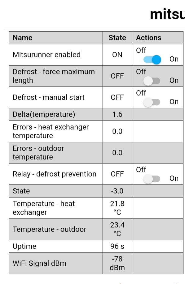

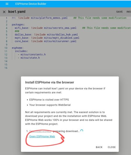

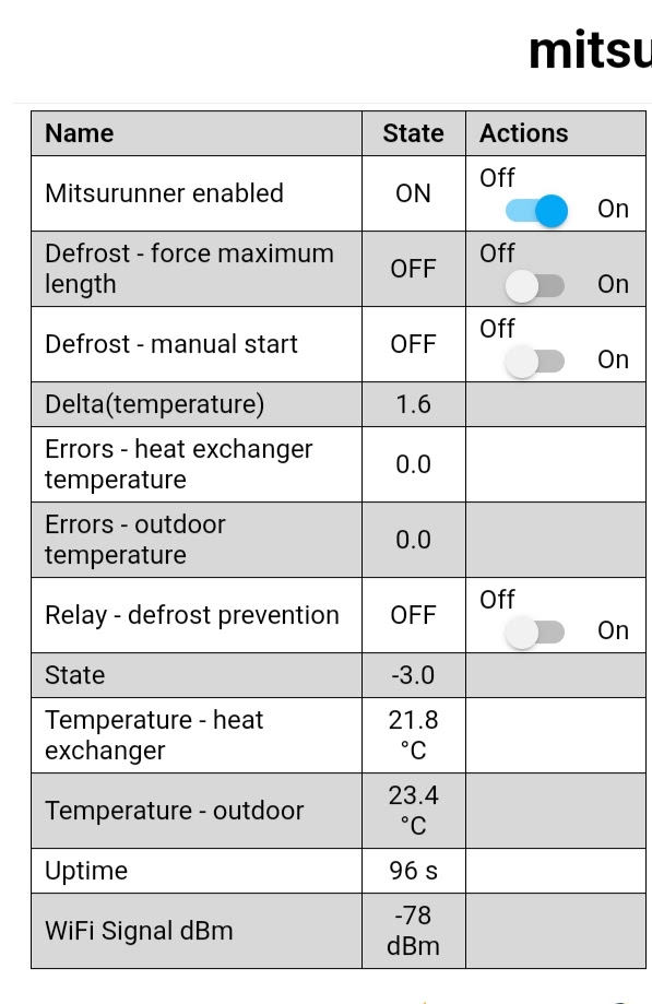

Nimeksi oli jäänyt työnimi, vaihdoin nimeksi " Mitsurunner enabled". Laitoin nimen alkuun välilyönnin niin tuo näkyy Web_GUI:ssa ylimmäisenä. Pitäsikö minun tehdä tehdä jotakin github:ssa ?
    88,7 KB · Katsottu: 75
Reactions: puu

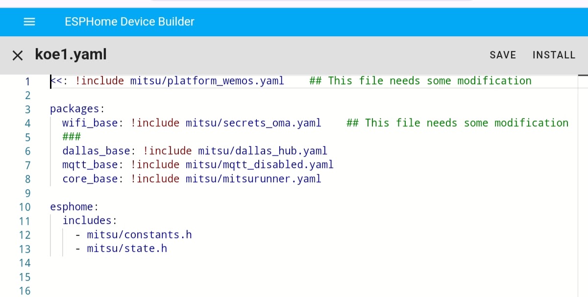

HA-osuudesta en mitään ymmärä, mutta helpottaako/vaikeuttaako tilannetta se että mitsu_conf.yaml kokoaa halutun paketin käyttäen "package"-metodia ?
Mitsu_conf.yaml
Koodi:
<<: !include platform_pana.yaml
packages:
  wifi_base: !include secrets_pana.yaml                   ## WifI needed
  dallas_base: !include dallas_hub_pana.yaml              ## minimize restarts, no more than 2 Dallas-sensor
  mqtt_base: !include mqtt_disabled.yaml                  ## NOTE! This must be included if MQTT is not used
  HA-base: !include homeassistant.yaml                    ## Enable if HomeAssistanty in use
  core_base: !include panarunner_core.yaml                ## MUST be included

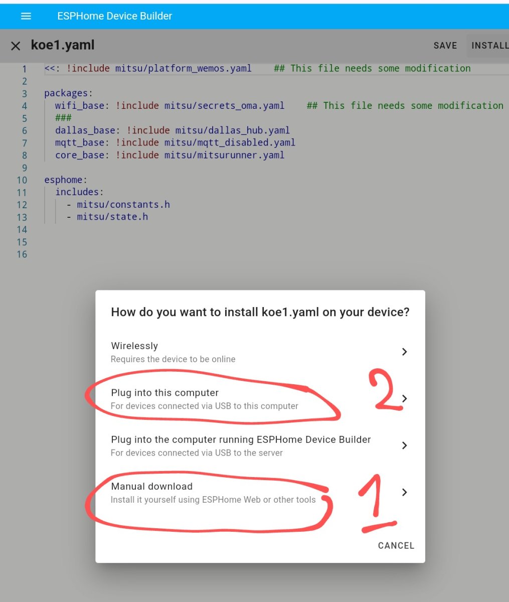

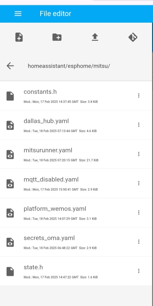

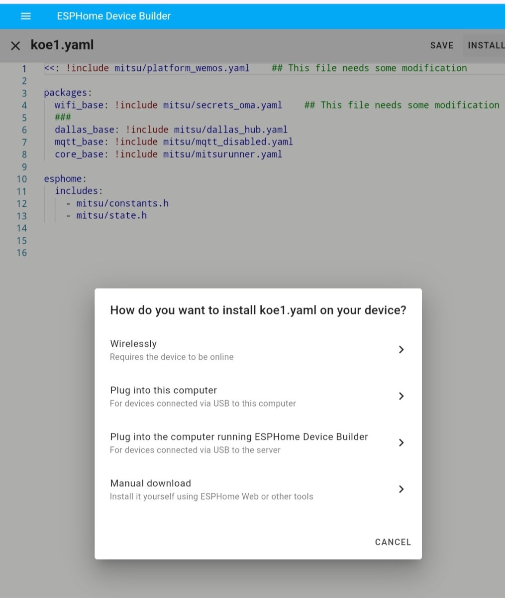

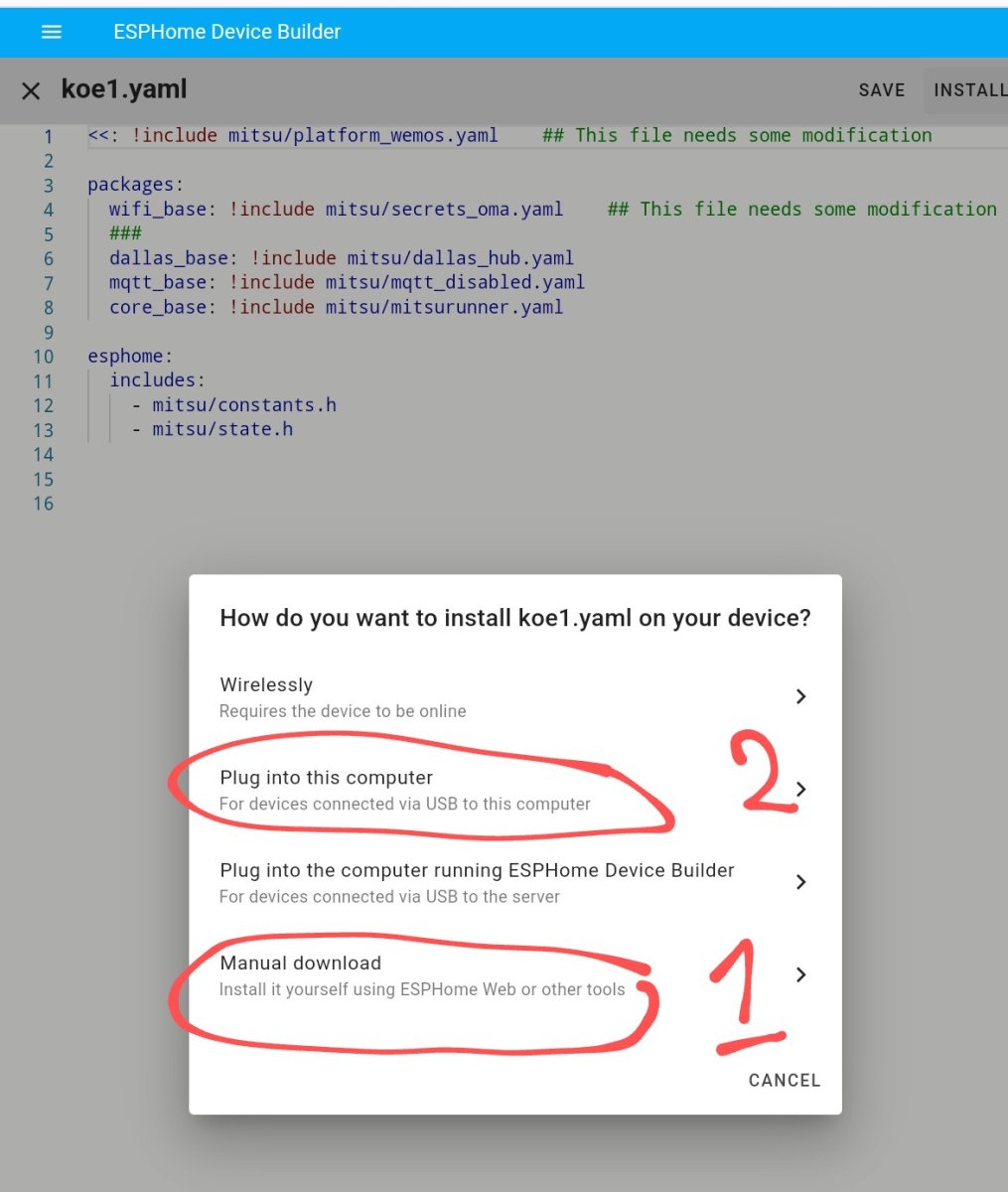

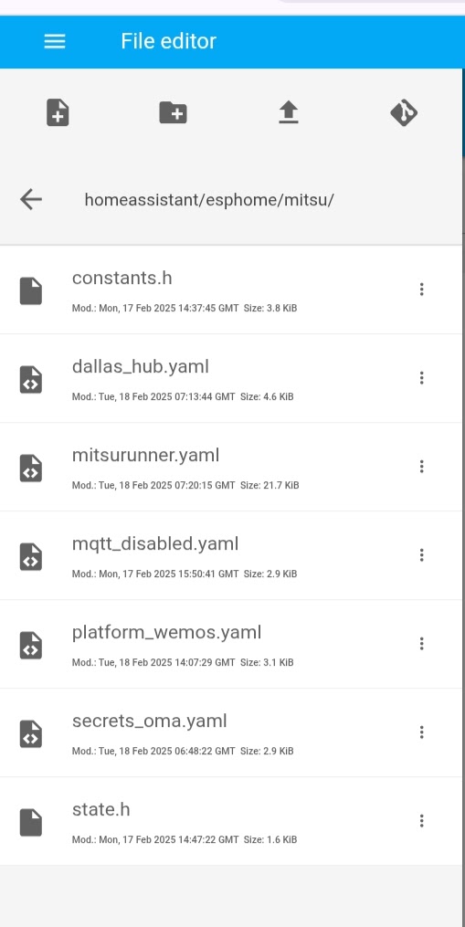

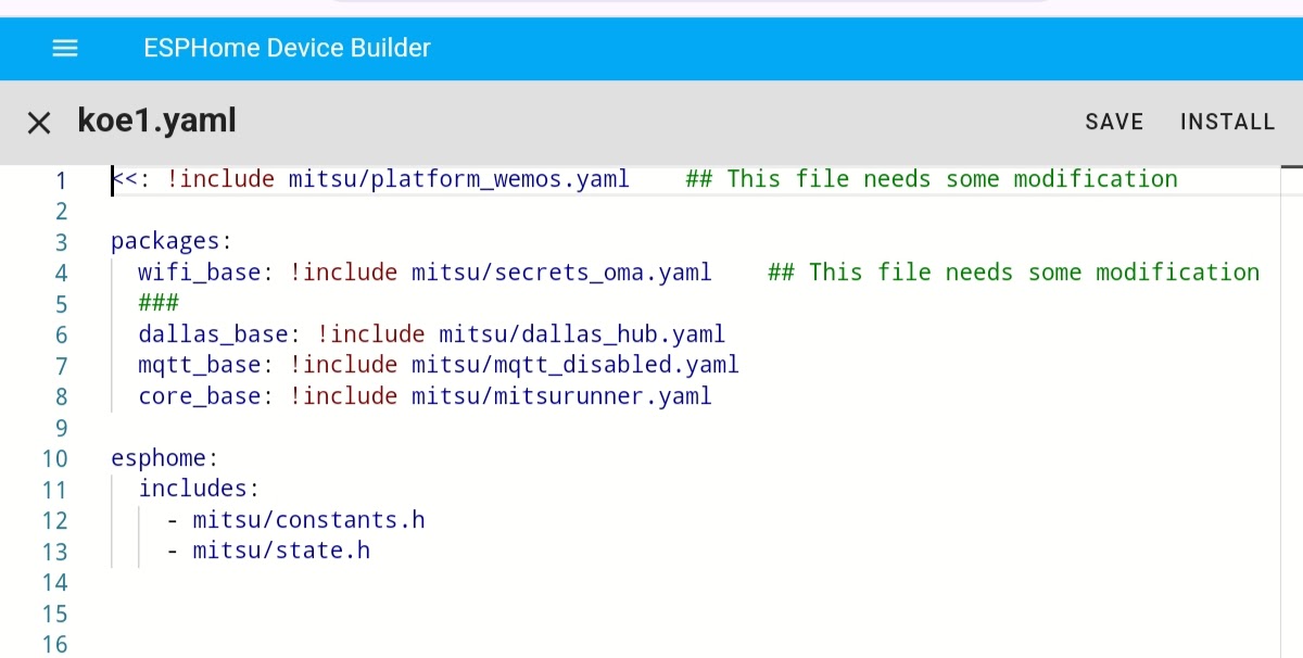

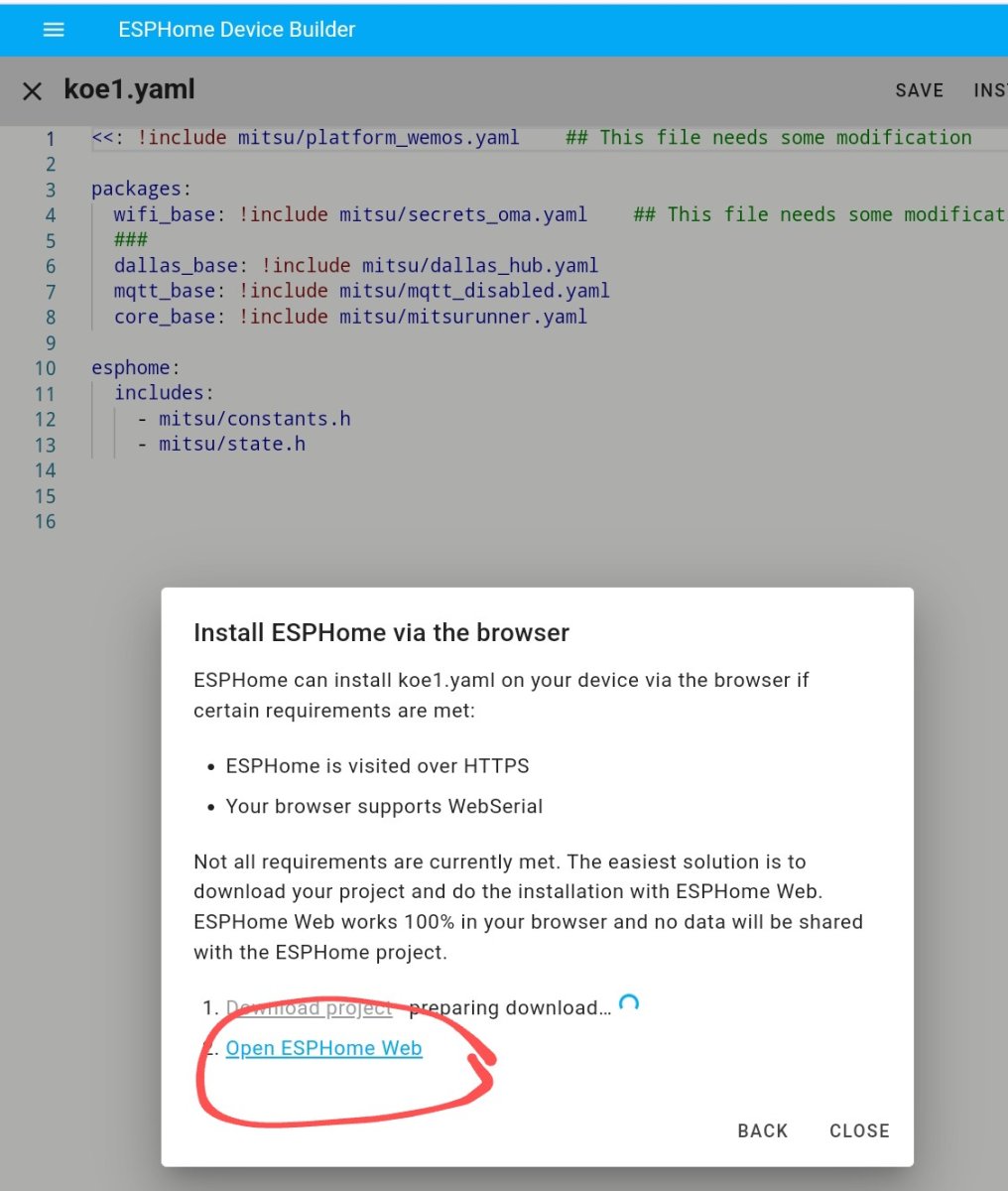

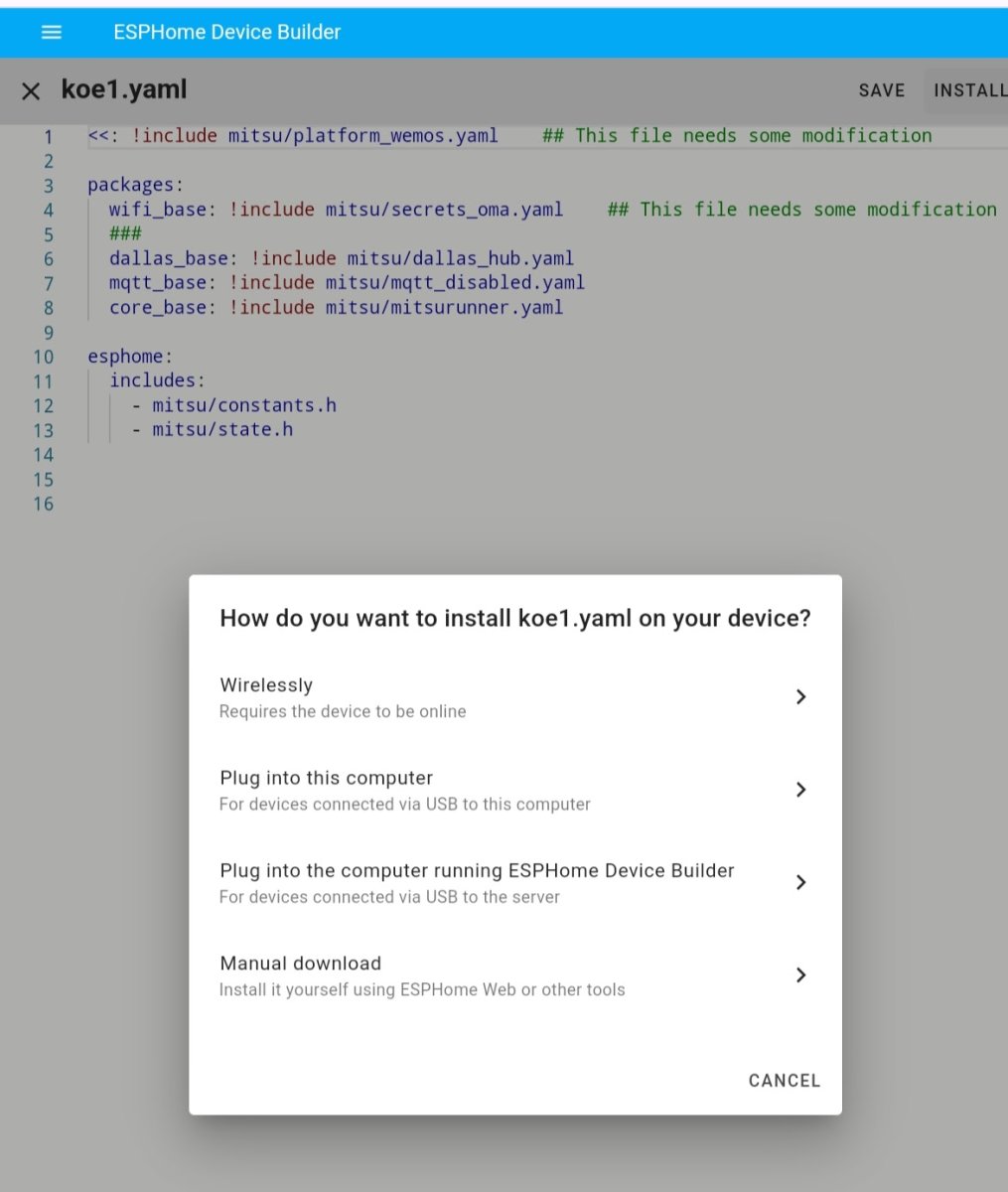

Sijoitin Mitsurunner-koodipaketin C:\Users\ilkka\Mitsurunner\Mitsu0225 hakemistoon ja päivitin mitsurunner.yaml include määritykset. Kun tuon hakemiston osoitteen määrittelee Mitsu_conf.yaml tiedostoon voi Mitsu_cong.yaml sijaita eri paikassa hakemistorakenteessa. Tuo menee ongelmitta läpi EspHome-kääntäjästä.
HA-tuntijat: toimisiko tämä HA:n add-on tapauksessa.
Koodi:
### Mitsu_conf.yaml tiedosto joka rakentaa halutun Mitsurunner variantin
<<: !include C:\Users\ilkka\Mitsurunner\Mitsu0225\platform_wemos.yaml
packages:
  wifi_base: !include C:\Users\Mitsurunner\Mitsu0225\secrets.yaml
  dallas_base: !include C:\Users\iMitsurunner\Mitsu0225\dallas_hub.yaml
  mqtt_base: !include C:\Users\Mitsurunner\Mitsu0225\mqtt_local.yaml
  core_base: !include C:\Users\iMitsurunner\Mitsu0225\mitsurunner.yaml
Mitsurunner.yaml includes osion tarvitsemat muutokset

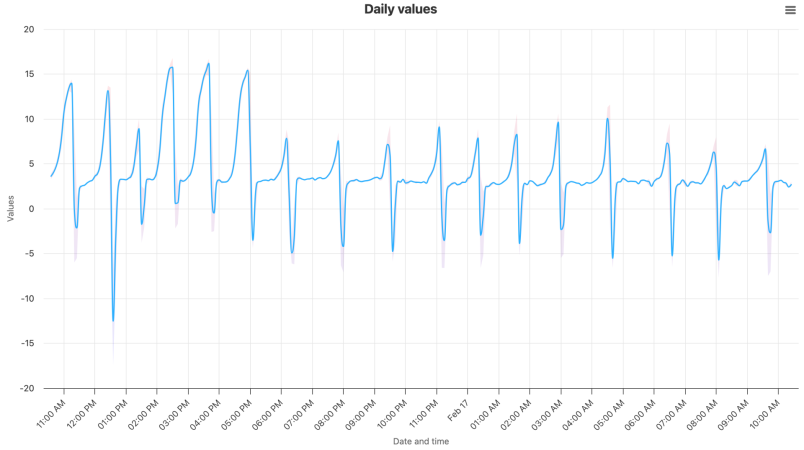

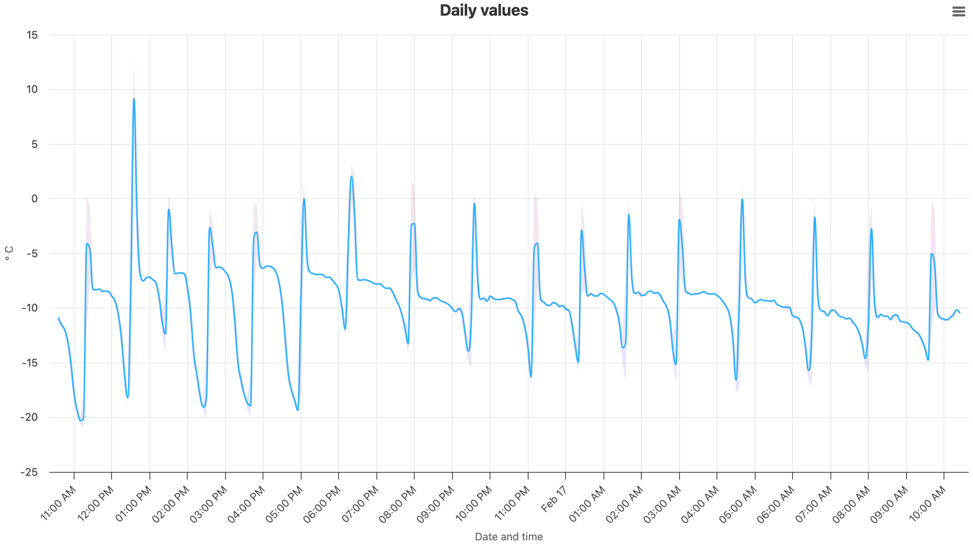

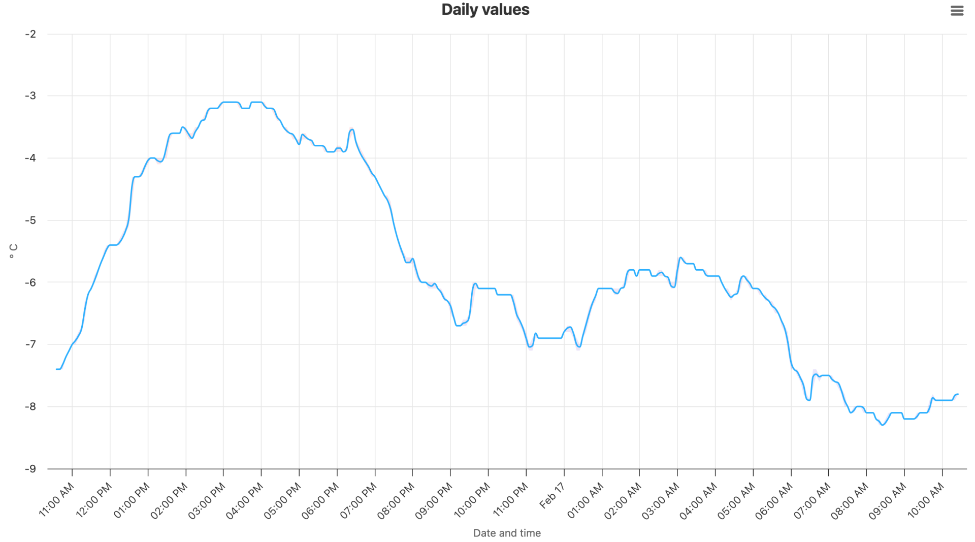

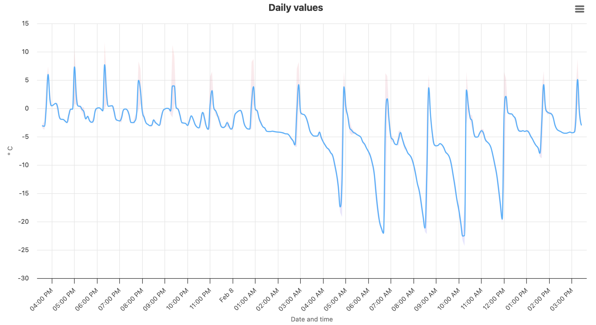

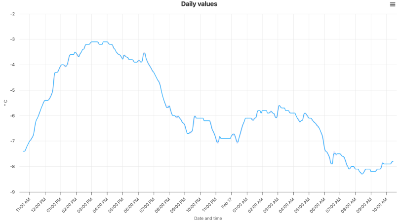

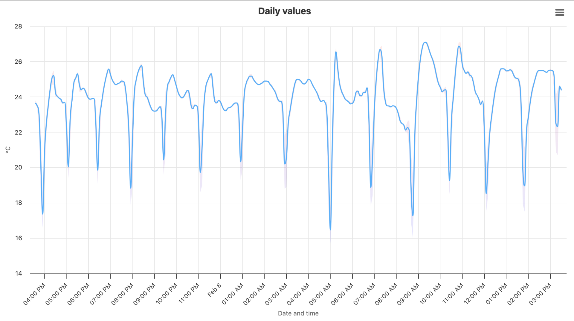

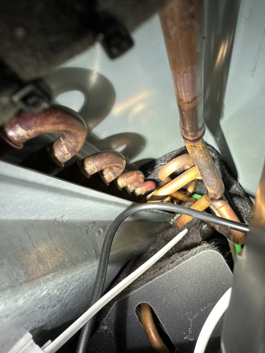

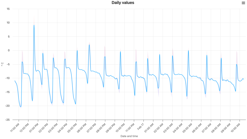

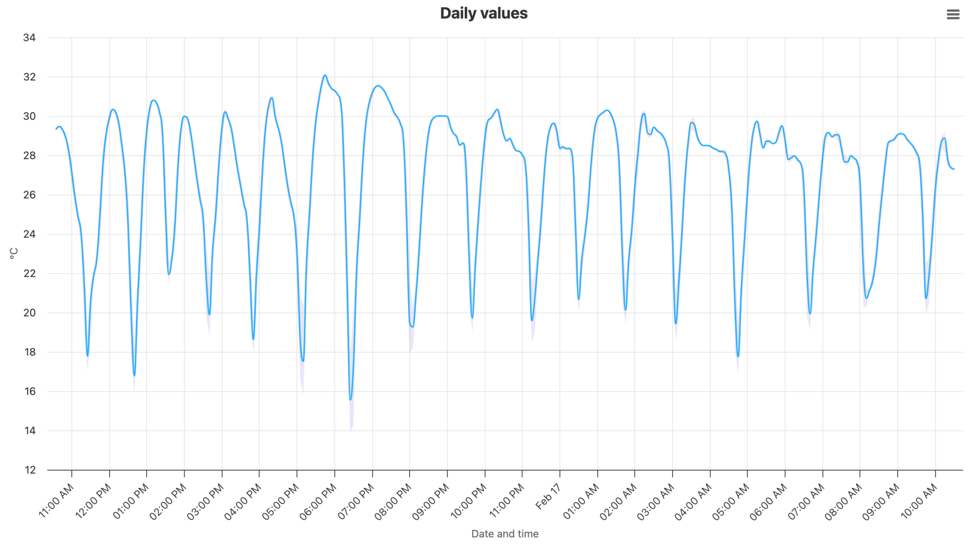

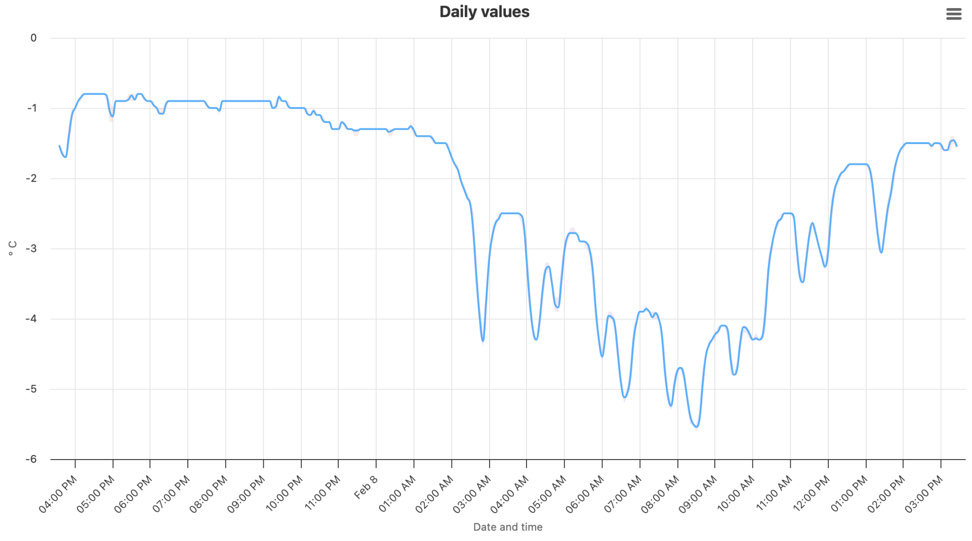

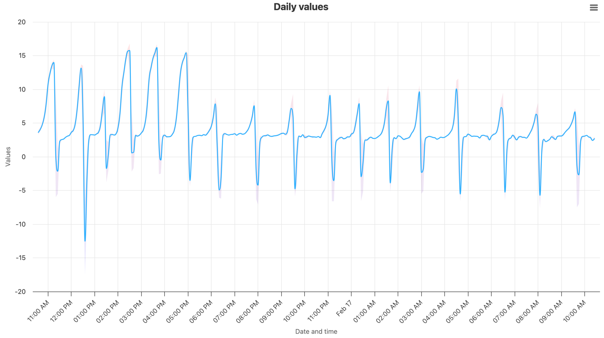

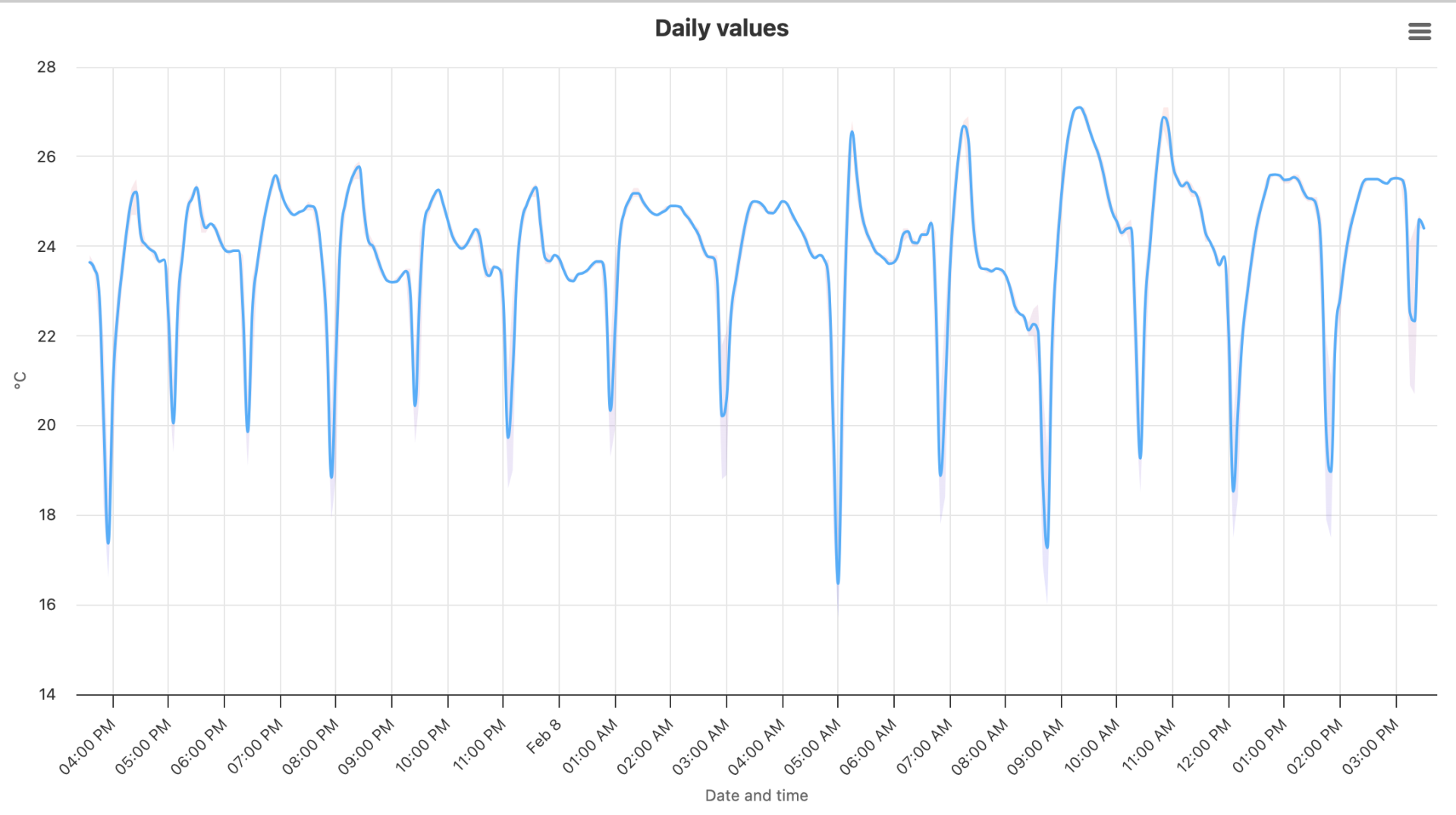

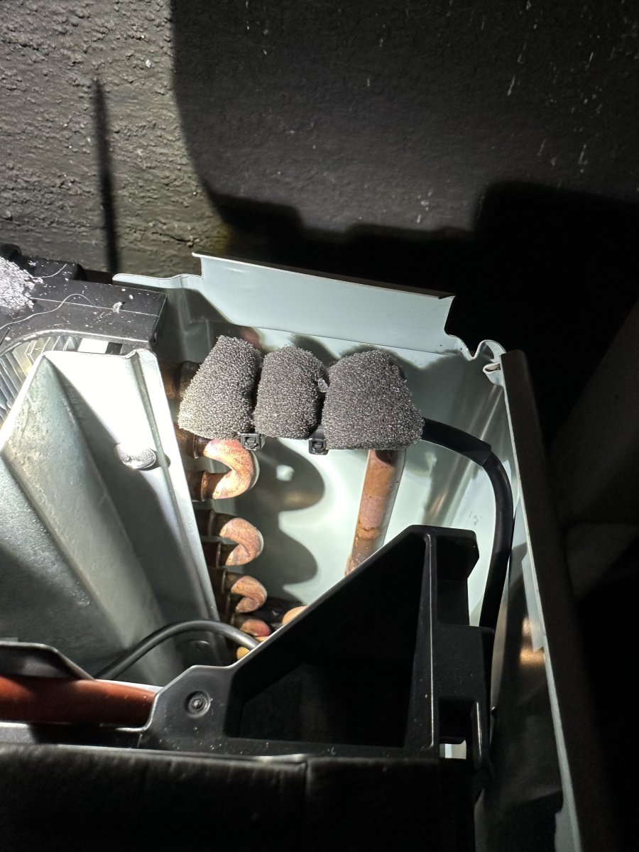

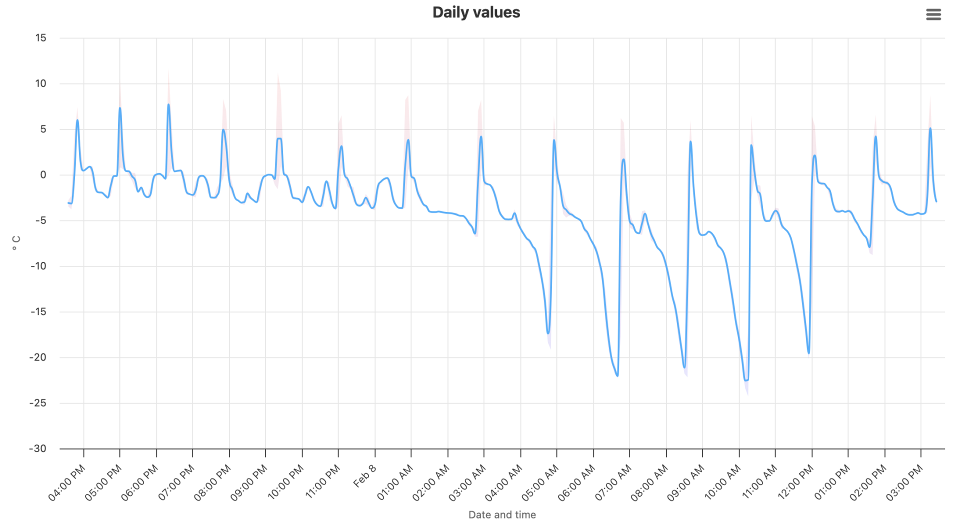

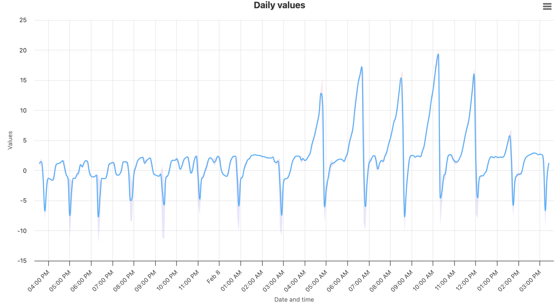

AP-sarjan lämpöpumpuissa vaikuttaisi olevan tietyissä sääolosuhteissa samaa hullunkiertoa kuin LN-sarjan lämpöpumpuissa, jonka vuoksi rakentelin MitsuRunnerin mökin AP25-pumpulle. Varsinaista asennusta tehdessä tuli kuitenkin todettua, että ulkoyksikön kennon rakenne on erilainen, eikä pumpun “outdoor heat exchanger temperature thermistor” sijaitse yläputkessa. Huolto-oppaassa ei valitettavasti ole kuvaa AP25/35 mallien kennosta, mutta anturi on jossakin kennon puolivälin tienoilla taikka sitä alempana. Anturiin käsiksi pääseminen vaatii sen viimeisenkin paneelin irroittamisen, johon en arvannut lähteä ryhtymään. Asensin anturin kuitenkin tässä kohtaa yläputkeen, mutta jätin puu-adapterin kytkemättä ja jätin MitsuRunnerin keräämään dataa. Mihinköhän kohtaan anturi kannattaisi kennossa sijoittaa, jotta MitsuRunner osaa ohjata sulatusta oikein?
Asennus erilaiseen "yläputkeen":
katso liitettä 104904
Pumpun oma anturi lienee jossain tuolla missä näkyy pilkahdus vihreätä.
katso liitettä 104905
Pumpun puhaltaman ilman lämpötila:
katso liitettä 104907
Ulkoilman lämpö:
katso liitettä 104908
Kennon lämpö:
katso liitettä 104909
Delta:
katso liitettä 104910

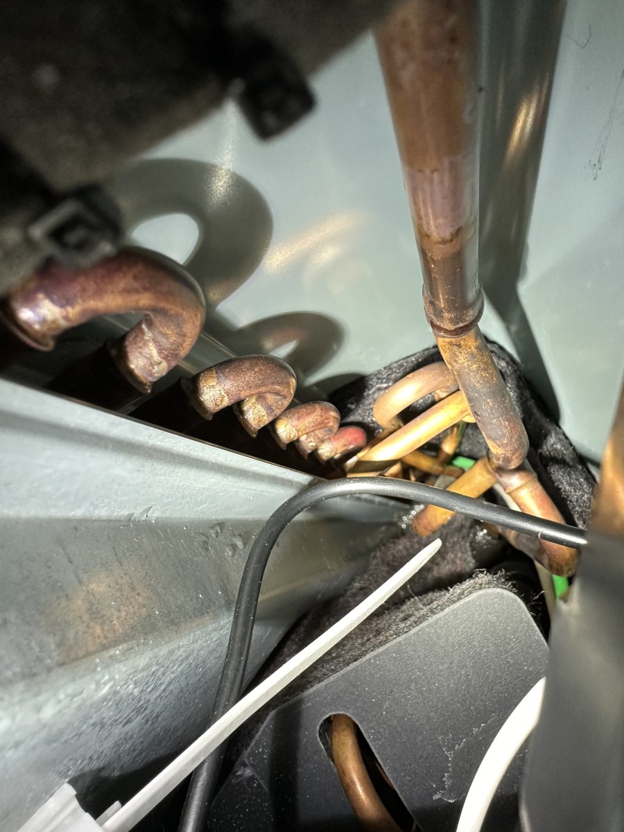

Miinulla Panassa oli sama ongelma eli en helposti päässyt kennoanturiin. Onneksi, sillä löysin paremman paikan DeltaT:n mittaamiseen kennon vasemmasta reunasta. Laitoin antrurin paikkaan joka huurtuu viimeiseksi eli on kierukan loppupäässä. Kuvassa alempi anturi. DeltaT on lämmitysvaiheen aikana stabiilisti asteen pari positiivinen. kennon menessä tukkoon nousee nopeasti ja sulatuksessa menee kymmenisen astetta miinukselle. Eli kannattaa tsekata miten kennon kierukat menee ja hakea tuon mukaan sopiva paikka. Nyt "TEMPERATURE_DELTA_TO_DEFROST" arvo on minulla 4.0.
Outdoor-anturi on sinulla väärin sijoitettu, sillä näyttää siltä että kennolämpötila vaikuttaa siihen.

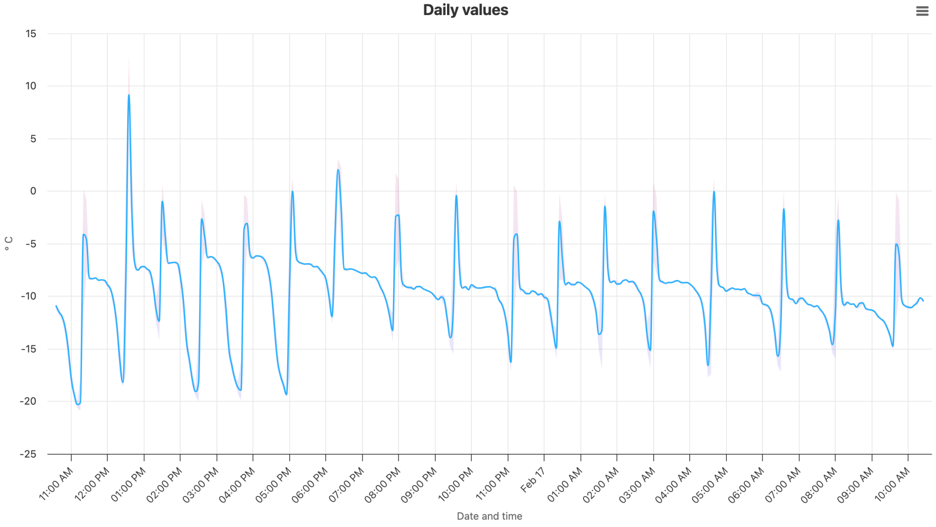

Kävin viikko sitten mökillä vähän säätämässä antureiden paikkaa ja kytkemässä puu-adapterin kiinni. MitsuRunner on nyt viikon ajan vastannut AP25-pumpun sulatuksesta.
Otin mallia iron vinkistä, ja siirsin kennoanturin kennon vasempaan reunaan putkeen, joka huurtuu / sulaa viimeisenä. Piti tehdä yksi läpivienti peltiin anturin kaapelia varten, joka ei pidempää reittiä pitkin olisi riittänyt oikeaan kohtaan. Seurailin arvoja parin sulatuksen verran, jonka jälkeen uskalsin jättää MitsuRunnerin puikkoihin. "TEMPERATURE_DELTA_TO_DEFROST" jätin vakioarvoon 5.0.
Outdoor-anturi oli sijoitettu ihan oikeaan paikkaan, mutta tajusin että pumpun päällä oleva ovikatos (tämän tyyppinen) aiheutti sen, että ilma ei kierrä kunnolla pumpun takana, vaan jää pyörimään pumpun taakse. Tämän takia sulatuksen aikana kennosta säteillyt lämmin ilma näkyi nousupiikkinä myös ulkolämpötilassa ja vastaavasti kennon huurtumisesta säteillyt kylmä ilma näkyi myös arvoissa. Tempaisin katoksen mäkeen, jonka jälkeen outdoor-anturi alkoi näyttämään tasaisemmin lukemia.
Ulkoilman nopea lauhtuminen (etenkin merenrannassa) aiheuttaa ymmärrettävästi tarvetta tiheämmälle sulatukselle, mutta muutoin käytös on viikon perusteella vaikuttanut järkevämmältä kuin aikaisemmin. Vielä kun IoT Gurun saisi vaihdettua johonkin järkevämpään ratkaisuun, jossa pääsisi seuraamaan lukuja tarkalla tasolla pitkältä ajalta. Muut ilmaiset brokerit vaikuttaisi vaativan SSL/TLS-yhteyden käyttämistä, joka taas esphomen & ESP8266 alustan yhdistelmällä ei tällä hetkellä onnistu.

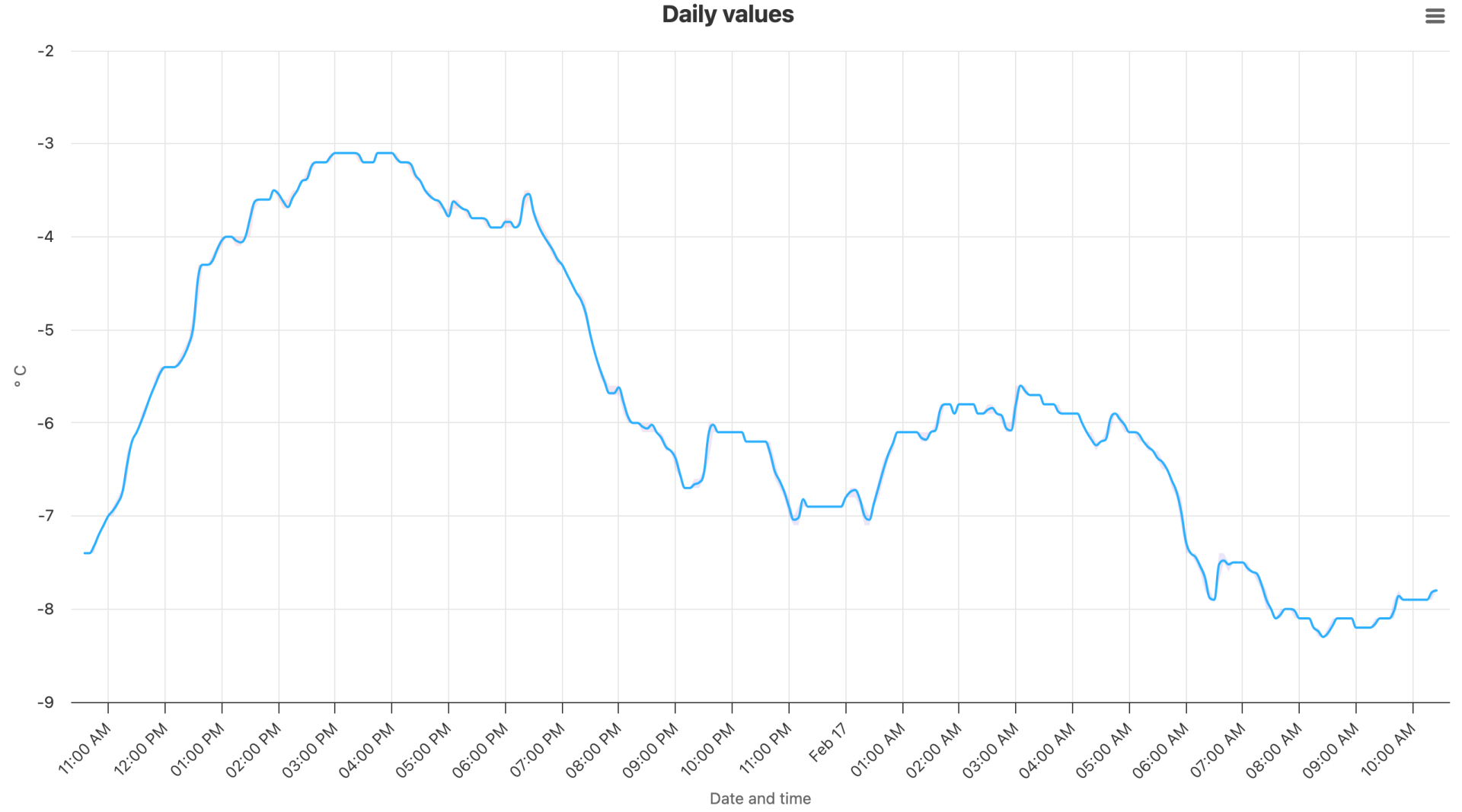

Ulkoilman lämpö:
Kenno:
Delta:
Nilkkakyy
Hi there,
katso liitettä 104932
katso liitettä 104933

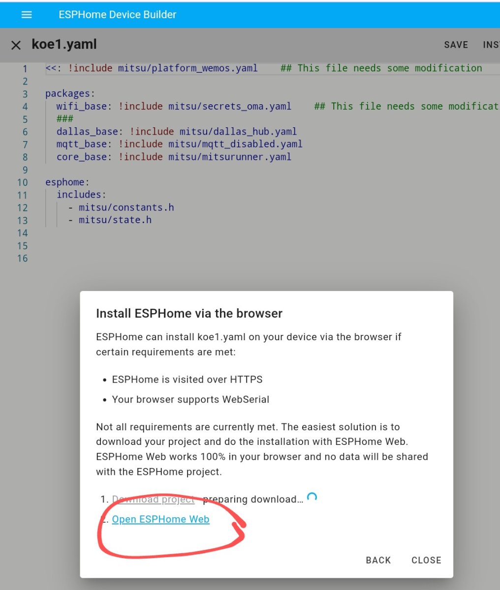

iro
Tein Mitsurunner-ohjelmarakenteeseen vielä pieniä muutoksia niin että sen pystyy nyt kääntämään ja lataamaan myös Home Assistantin ESPHome Builderilla.
Olen täysin noviisi HomeAssiatant-asioissa joten alla kuvattu prosessi on luultavasti täysin vastoin hyviä käytäntöjä, HA-tuntijat voisivat kertoa kuinka tuo oikeasti pitäisi tehdä. :huh: Kuitenkin tuo toimii.:)
EDIT-lisäys: OTA-päivitys toimii myös ESPHome-tool:lla tehtyyn Mitsurunneriin kunhan WiFi-asetukset ja OTA-password ovat samoja.
1) Hakemiston homeassistant/esphome alle luodaan hakemisto mitsu ja sinne ladataan tarvittavat Mitsurunnerin x.yaml ja x.h tiedostot
2) ESPHome builderiin luodaan uusi device ja sille kopioidaan Mitsu_conf.yaml tiedosto
3) Save / Install / Manual_Dovwload tekee .bin tiedoston. Tiedosto talletetaan.
4) Ensimmäinen flashays pitää tehdä USB:n kautta, Install /Plug into this Computer / Open ESPHome Web / Connect / Install
==> Mitsurunner on asennettu ja seuraavat flashaykset voidaan tehdä OTA:na
