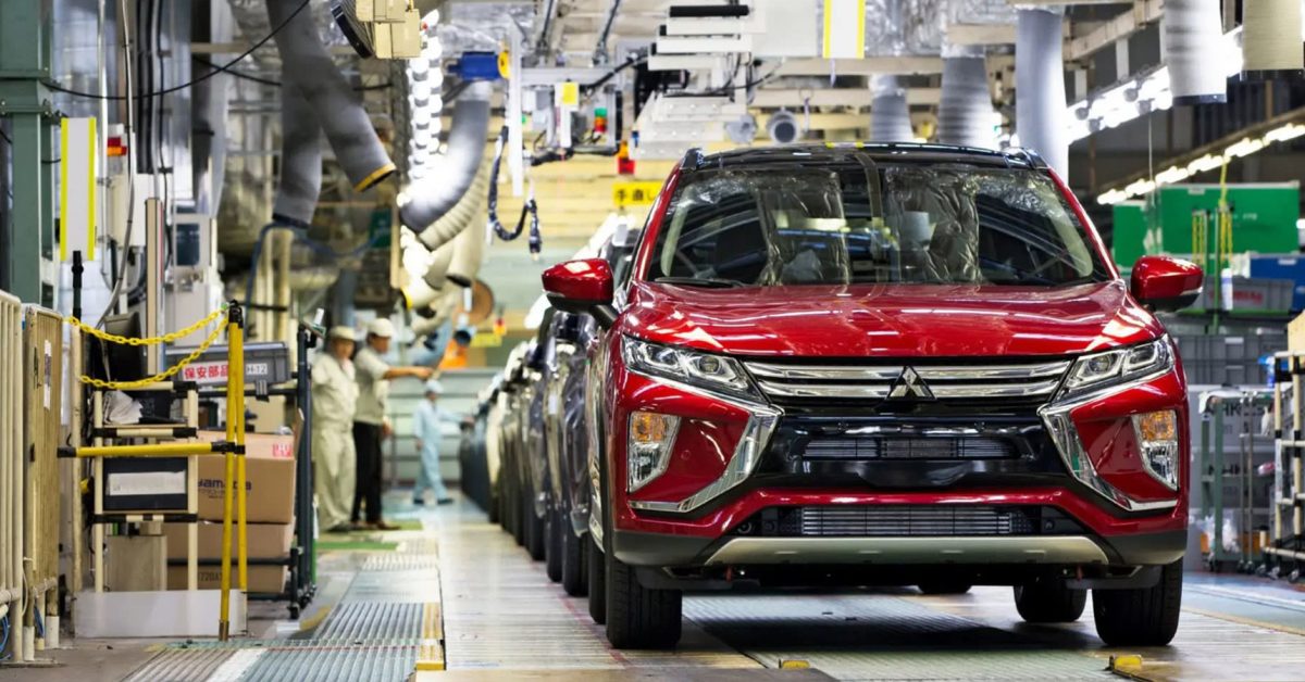

Used EV batteries will power Mitsubishi’s electric-vehicle manufacturing plant
