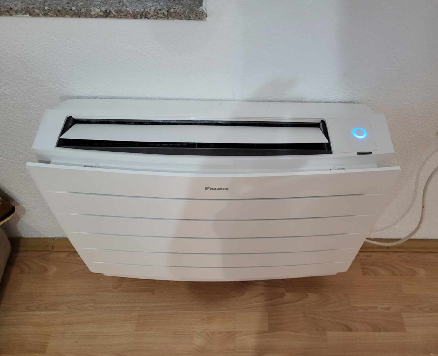

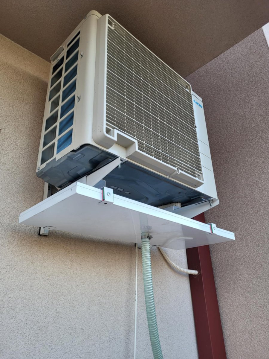

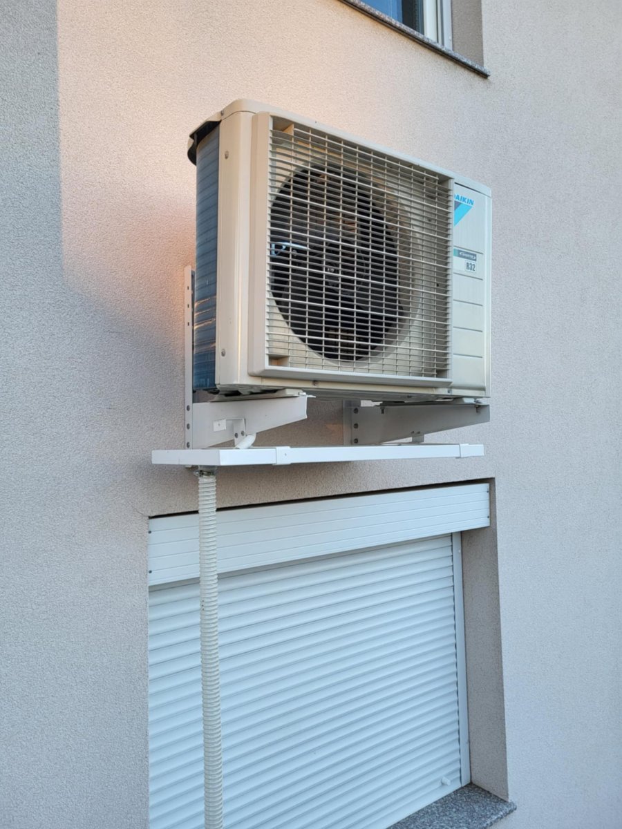

My Daikins:
Perfera floor
FVXM35A/RXTP35R (Optimized Heating 4)

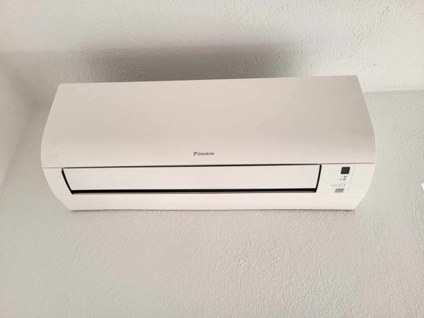

Comforta
FTXP20N/RXP20N
