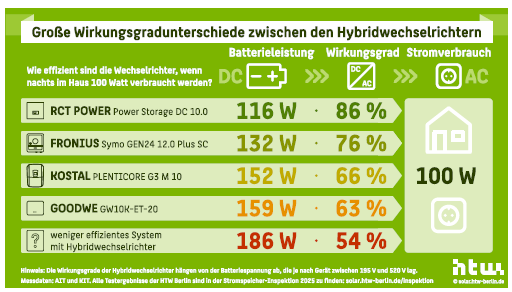

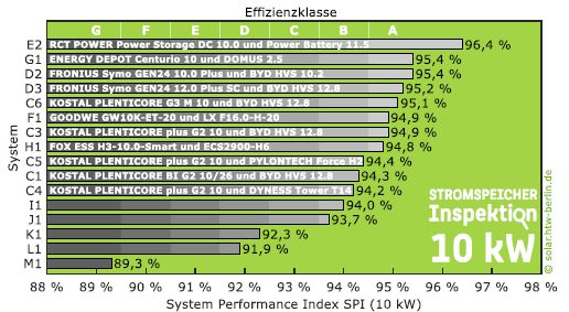

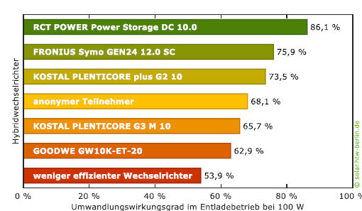

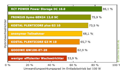

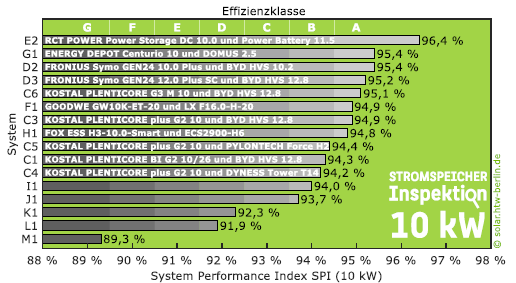

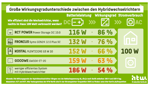

Saksalaiset ovat jälleen testailleet eri akkuja.
ELECTRICITY STORAGE INSPECTION 2025​
Muutama poiminta sieltä, hyötysuhde 100W kuormalla.
Dyness näyttää kyllä ihan houkuttelevasti hinnoitellulta. Puolasta saisi T14 ja uudemmalla Soliksella n. 4500 eurolla.

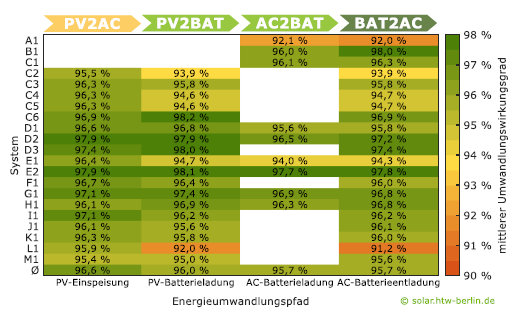

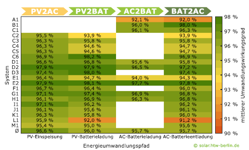

LVarsin mielenkiintoinen tutkimus sakemanneilta. Tutkimus alleviivaa - ehkä hieman tarkoitushakuisesti eurooppalaisten valmistajien kilpailuetua, hyötysuhdetta. Hyötysuhdetta kuvaamaan on kehitettuy indeksi, SPI.
The researchers attested 10 systems to the highest efficiency class A. The evaluation results confirm the outstanding system efficiency, especially for European inverter manufacturers. In addition to the European suppliers, only the Chinese manufacturers GoodWe and Fox ESS are represented among the leaders this year. With the new H3-10.0-Smart hybrid inverter and ECS2900-H6 battery, Fox ESS achieves a very good SPI (10 kW) of 94.8%. The new and high-performance hybrid inverters PLENTICORE G3 M 10 from KOSTAL and Symo GEN24 12.0 Plus SC from Fronius perform even slightly better in combination with a high-voltage battery from BYD. Both systems can charge and discharge the Premium HVS 12.8 battery box with more than 10 kW and are suitable for larger PV systems. New to the test are eight devices, including from Fox ESS, Fronius, Kostal and SAX Power. The HTW researchers were surprised that two companies decided to participate in the study anonymously despite very good efficiency results.
Lähde:
solar.htw-berlin.de

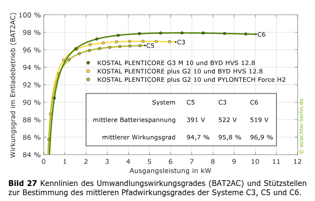

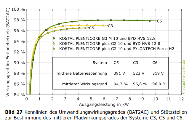

Kuva 27
Hyötysuhde BAT--> AC... hyötysuhde jää 90% pintaan alle 1kW teholla (10% nimellistehosta).
"Characteristic curves of the conversion efficiency (BAT2AC) and interpolation points
for determining the average path efficiency of systems C3, C5 and C6" (kone käännös Saksasta)

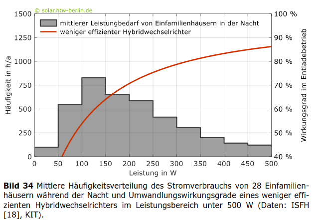

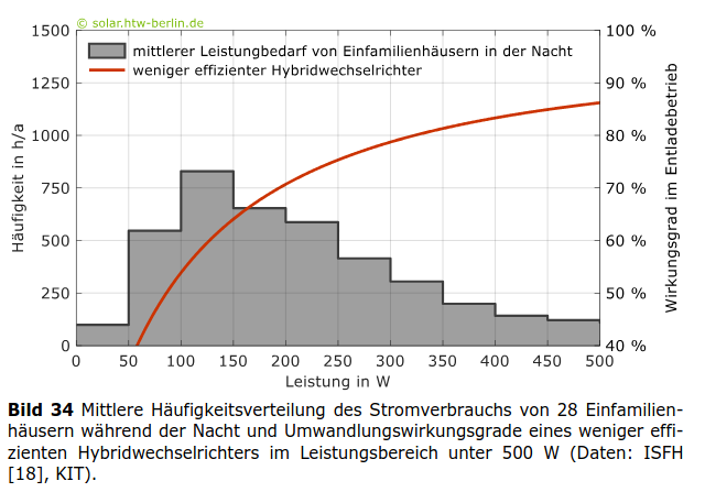

Kuva 34
Hyötysuhde keskimääräisen kulutuksen mukaan, saksa yhden henkilön talous.
"Average frequency distribution of the electricity consumption of 28 single-family houses during the night and conversion efficiencies of a less effi efficient hybrid inverter in the power range below 500 W" (kone käännös Saksasta)

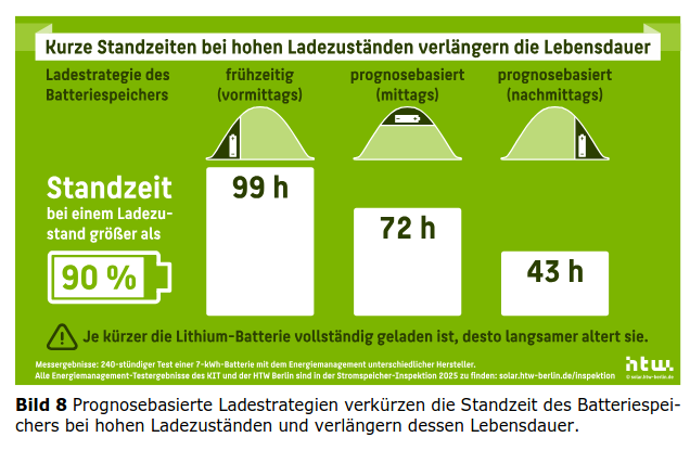

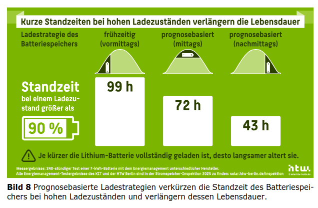

Kuva 8
Mitä tarkoitetaan graafin kuvatekstillä "Forecast-based charging strategies shorten the service life of the battery storage system at high charging states and extend its service life." (kone käännös Saksasta)
Näytä liitetiedosto 104863Näytä liitetiedosto 104865
Näytä liitetiedosto 104864Näytä liitetiedosto 104866
Hyötysihde 1% kuormituksella lienee haastavaa. Yksitäisenä lukuna hyödytön mutta alleviivaa ongelmaa... akkuinverteri täytyy mitoittaa optimialueelle siinä missä kaikki muukin. Kyseessä lienee DC-AC muunoksen tehokuudesta eikä kokonaishyötysuhteesta. Ja täsät muituukin mielee aikaisemmat hyöttysuhteet joidenka hyvyyttä hieman kummastelin. Jotta paremmuss olisi helpompi todentaa niin hyötysuhde varmaan pitäisi laskea esim 30 tai 50% kuormituksella nimellistehosta.

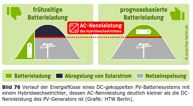

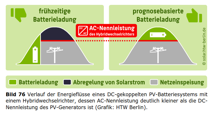

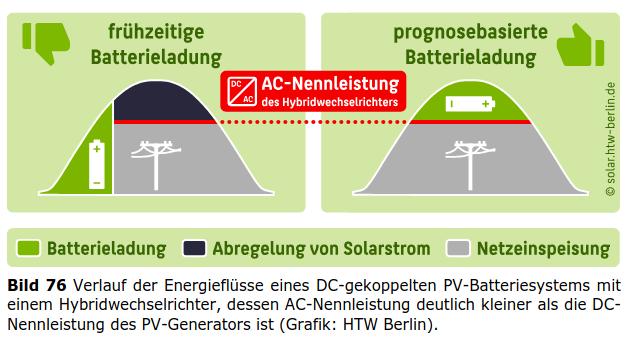

Nostetaan kuva 76 erikseen esille... joskus kysin miten paneelien ja akkujen latauksen mitoitusta. Vastaukset olivat paljon puhuvia eikä ajatyksen vaihtoa oikeastaan syntynyt. Nyt yllä lainattu tutkimus nostaa ennustavan latauksen sääennusteen perustella yhdeksi ominaisuudeksi.
Why should DC-coupled electricity storage systems also charge on a forecast based charging even if no feed-in limitation is required?​
The forecast-based and delayed charging of the PV storage systems has even more advantages. If the nominal DC power of the PV system is greater than the AC nominal power of the hybrid inverter, the forecast-based battery the forecast-based battery charging in the midday hours reduces the dimensioning-related losses due to dimensioning.
The ratio of the DC power of the PV generator to the AC inverter power is also known as the design power. power is also referred to as the design factor [71]. In practice PV battery systems are usually dimensioned so that the nominal DC power of the PV modules is greater than the nominal AC power of the hybrid inverter. In the data sheets of the hybrid inverters, the manufacturers often provide the maximum recommended DC rated power. FENECON points out that points out that the 10 kW hybrid inverter currently integrated in the ‘Home 10’ inverter may be overloaded with a maximum of 15 kW DC nominal power of the PV generator. may be overloaded. However, the maximum voltage and current values must be complied with. be adhered to. According to FENECON, the two DC inputs of the hybrid inverter inverter FHI-10-DAH 16A with a maximum MPP current of 16 A and a maximum short-circuit current of and a maximum short-circuit current of 21.2 A.
For the PLENTICORE plus 8.5 hybrid inverter, whose rated AC power is 8.5 kW, KOSTAL specifies the maximum permissible nominal DC power of the PV generator as 12.75 kW. generator is 12.75 kW. The hybrid inverter can therefore deliver 8.5 kW AC power and simultaneously charge the battery storage system with around 4 kW. The data sheet specifications from FENECON and KOSTAL even result in a maximum recommended design factor of 1.5, which means that the nominal DC power of the PV generator may be selected to be 50 % greater than the nominal AC power of the hybrid inverter.
RCT Power recommends in the data sheet of the 8 kW hybrid inverter Power Storage DC 8.0 recommends a maximum DC rated power of 10.8 kW for a south-facing PV generator. rated power of 10.8 kW. According to RCT Power, the design factor of the hybrid inverter should therefore of the hybrid inverter should not exceed the value of 1.35. Technically even a higher output would be possible: the 8 kW hybrid inverter can be inverter, in combination with the Power Battery 7.6 on the PV input side, can generate up to up to 15.7 kW on the PV input side. In this case, the inverter would deliver would deliver 8 kW AC power and charge the battery with 7.7 kW. If the 8 kW hybrid inverter is combined with the Power Battery 11.5, the battery can even be battery can even be charged with 11.5 kW and the inverter can deliver 8 kW on the AC output side can deliver 8 kW at the same time.
